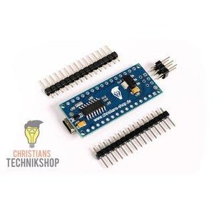

  1. Arduino Nano

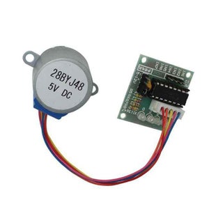

  2. 28BYJ-48 5V DC Stepper Motor
  3. ULN2003 Easy Driver Board

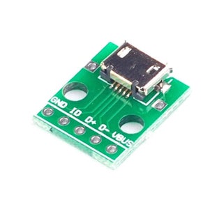

  4. Mini USB female connector

Wiring the stepper motor board to the arduino nano is fairly straight forward..
  • IN1 - Digital pin D2
  • IN2 - Digital pin D3
  • IN3 - Digital pin D4
  • IN4 - Digital pin D5
You can test the stepper motor running with test-run-code.ino provided in downloaded folder.. make sure the stepper motor is turning counter clockwise.. if its not.. than change the sequence of the 4 IN pin inverted
  • IN1 - Digital pin D5
  • IN2 - Digital pin D4
  • IN3 - Digital pin D3
  • IN4 - Digital pin D2
Once all the test is done.. you can upload the clock-code.ino.. which i modified an arduino code from shiura to fit into this project.. thank you mr shiura for sharing your code to be remixed..

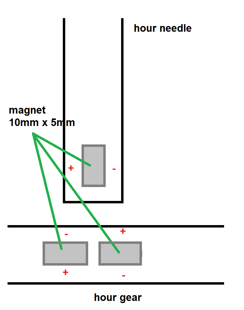

First thing we need to do is prepare the magnets that will point the hour needle.. at first i used only one magnet to pull the needle magnet but it wasnt strong enough as when at 3pm-9pm angle the hour needle just drops.. so i had to use 2 magnets on the hour face gear to pull the hour needle.. 2 that will pull both north and south pole of the magnet..
Now the assembly is simple.. add the back base cover that has the clock face
Insert the minute gear with the hour needle into place
And then the hour gear with the magnet.. if you look closely i added a small dent on the hour gear so you'll know where it points

Once everything is in working order.. you can glue the micro usb board to the position at the back of the base..
I inserted the micro usb into the female usb board and then align it with the cover.. add a bit of glue and close the cover to align it to the notch i added to the base cover

Although it looked easy to design and make.. the hard part was tweaking it to fit and work together.. i had to redesign the magnet hour needle several times until i got the exact distance and length so the pull is strong enough.. the gear positioning was also adjusted bit by bit until it catches each other perfectly without and stall.. i had several stall with the gears.. after several iteration it was caused by loose wire on the stepper motor driver board..
