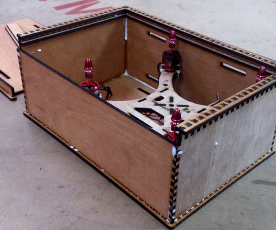

Step 2: Cutting the Airframe
Laser cutting machines are wonderful, you just click a button and create an object. If you search  your city probably the friend of a friend works at a place where they have one. If you live in a big city and you're lucky, there will be a FabLab nearby your place. Use your power to ask and find them to cut the Flone's digital file.
If you don't seem to find one or you just can't wait, print the file in A3 paper and cut the wood veneer with a jigsaw.
Step 3: Assembly It
Parts:
Main Frame.
Reinforcement arms.
Electronics plate.
Legs.
1 Glue the reinforcement arms to the main frame. (make sure the hole for the legs it's aligned so they will be able to stick in in next step)
2 Glue the legs
3 Once everything dried up, fit the engines in its final position and fasten them with cable ties.
4 Remember that cyanoacrylate and cable ties are the best friends of the dronistas. The cable ties brake before damaging the precious propellers or move the motor shaft. If you can't use them you could always use model airplane glue.
