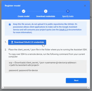

- google assistant code
- mobile app

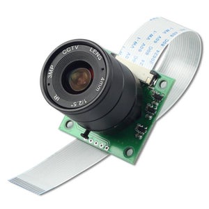

- Raspberry Pi camera to make face recognition and camera tracking “computer vision”

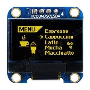

- OLED screen to display the emotion and messages of FABY to make it interact well with the hymen

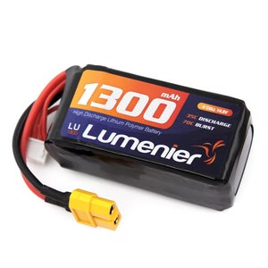

- Lipo battery 1300 mA, has a large capacity that can supply the motors and servo and OLED screen

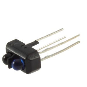

- Infrared sensor: to detect if there is ground or not so that it doesn’t fall from high ground

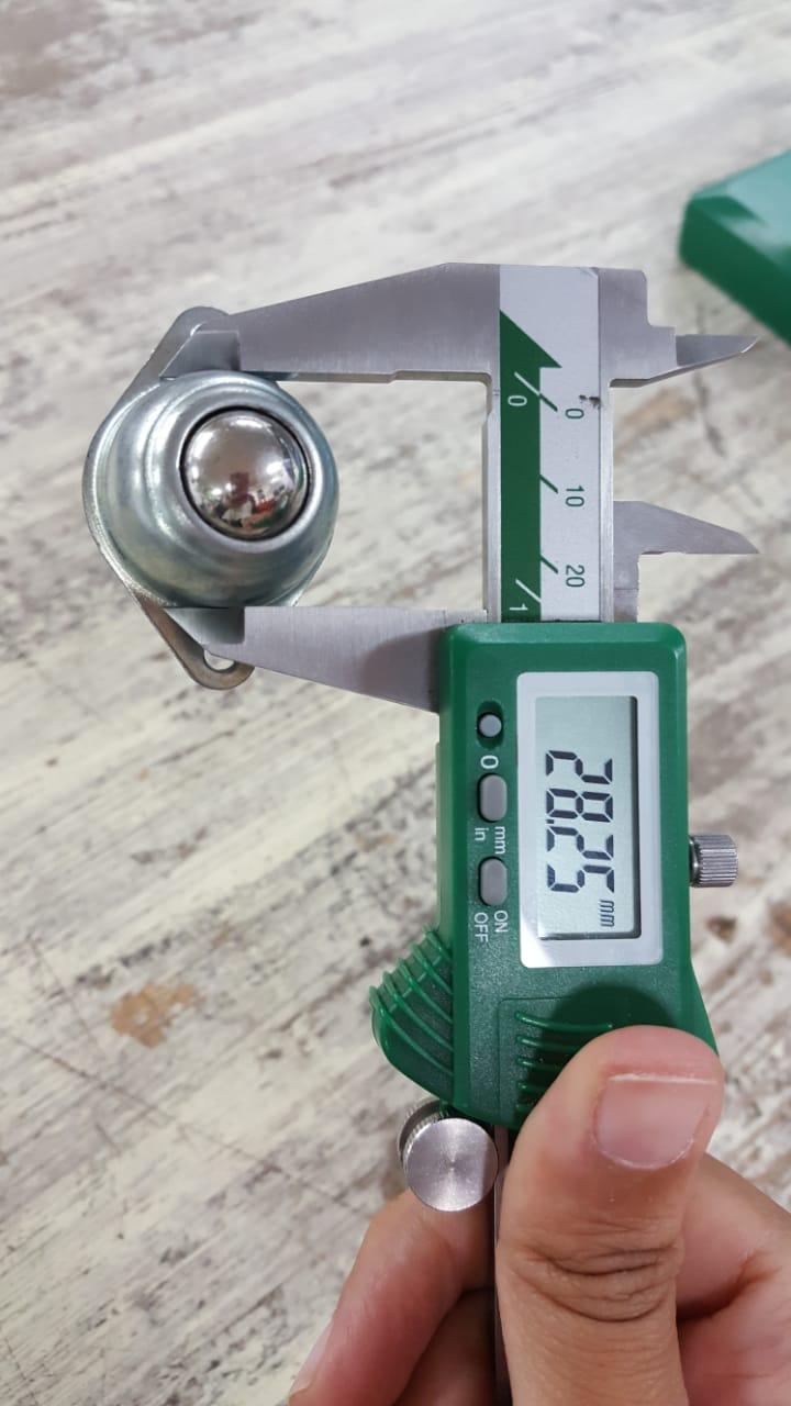

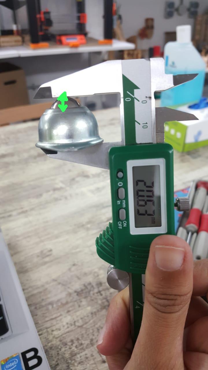

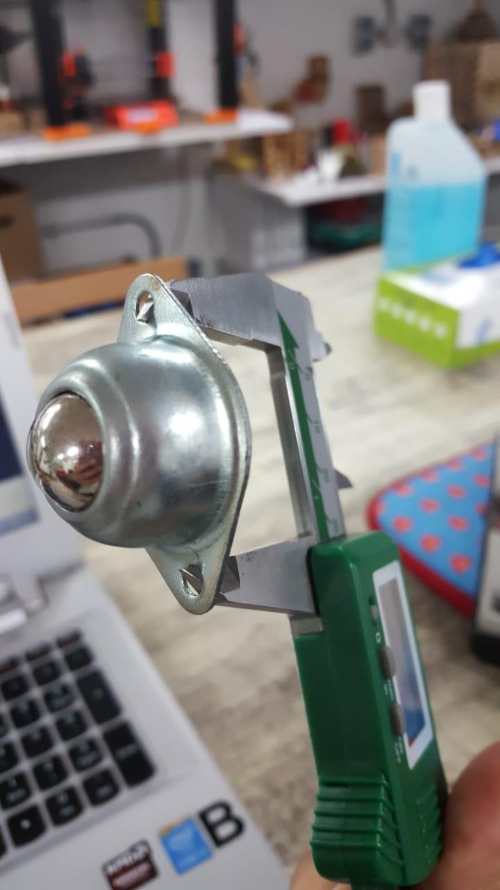

- Caster wheel: to support the body

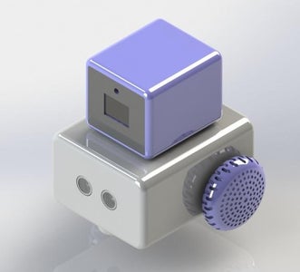

How did we think about the body?

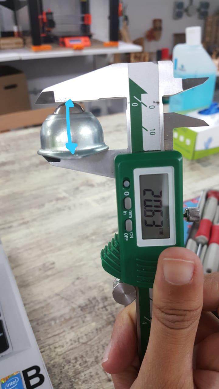

Before you think anything you should know this, you must take the measurements of your components to know how the body dimension will be Figures (1),(2),(3)
As smaller it is, as better it was

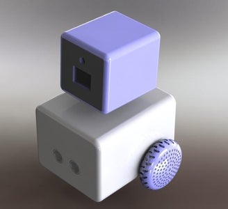

As we finished the measurements and prepared our dimensions, we could imagine the body, so we had to body to be smaller and artistic we found one that looked exactly as we describe
Figure (4)
So, we will make our body look closely like that

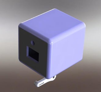

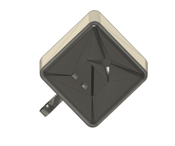

We had the measurements and a vision of the body so, let's build our FABY Robot

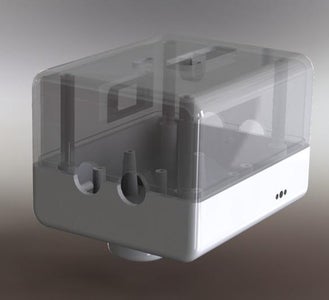

Let’s begin with the head, the head must include the camera and OLED screen so will design the head to contain all of these components in Figure (5)

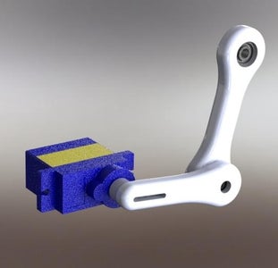

now we need to think of a mechanism that allows the head to move up and down, luckily for you, we will give you this mechanism in Figure (6)
So let’s see our mechanism on the head figure (7)

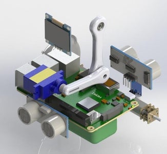

Let’s prepare our components and put them in the body figure (8)
Let’s see our body now figure (9)

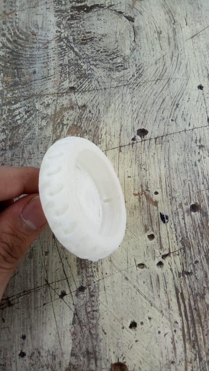

design the wheel and put it into the final shape figure (10)
Don’t worry I will leave all files down so you can download it

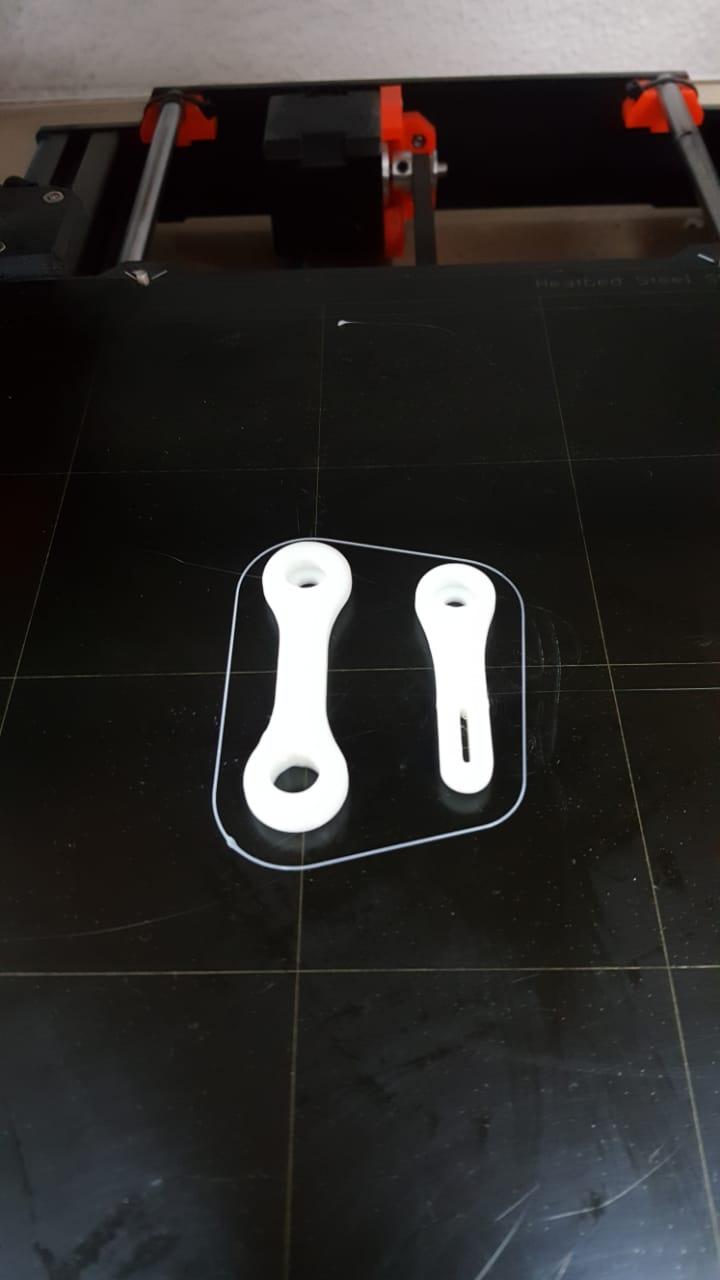

After finishing designing the body it’s time to fabricate it
To fabricate the body, you need the main thing that you will print with the filament I prefer PLA filament figure (11)
So, after you save the parts as STL files, open Cura and import these files, I will give you two examples
The first one is the mechanism of the head figure (12)
Then press save to file and take this file to flash drive put it on a flash drive and put it in the 3D printer to begin to print Figure (13)

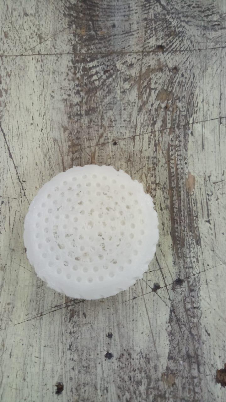

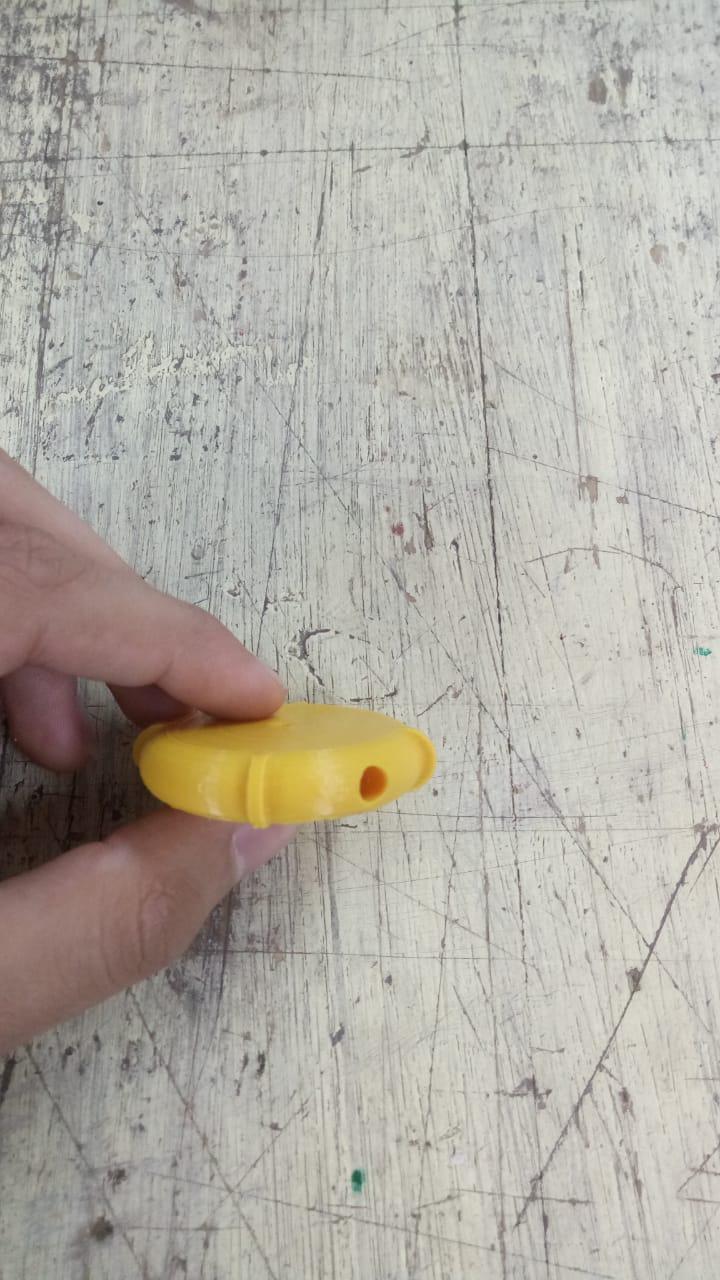

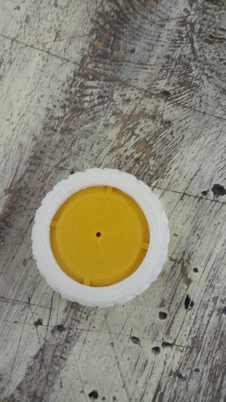

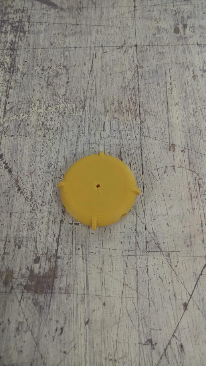

Let’s move on to the second part that we will print which is the body of the wheel without the tire, again repeat the same steps, and import the file in cura figure (14)
Edit the filament and supports and draft as you see and press slice, you will see the average time that the part will be 3D printed in Figure (15)
Then press save the file, put it on the flash drive upload it to the 3D printer, and leave it to be printed figure (16),(17)
Then add to the wheel the rubber part which we made by ourselves figure (18), (19), (20), (21)

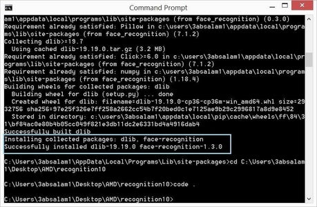

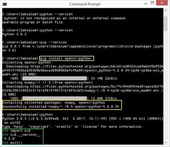

How to install OpenCV library?
I worked on the command prompt in Windows and just typed this one line
pip install opencv-python
I assume that you have OpenCV installed on your system.
Dlib and the face_recognition packages.
Note:For the following installs, ensure you are in a Python virtual environment if you’re using one. I highly recommend virtual environments for isolating your projects — it is a Python best practice. If you’ve followed my OpenCV install guides (and installed virtualenv + virtualenvwrapper )
then you can use the workon command prior to installing dlib and face_recognition
Installing dlib without GPU support
If you do not have a GPU you can install dlib using pip by following this guide:

Install the face_recognition package
The face_recognition module is installable via a simple pip command:
Face recognition with OpenCV, Python, and deep learning
$ workon <your env name here> # optional
$ pip install face_recognition

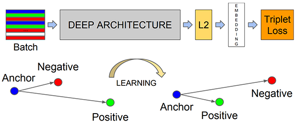

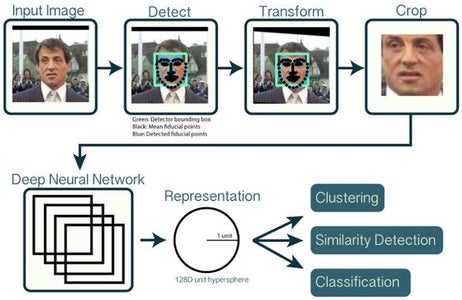

How does face recognition work?
In order to build our OpenCV face recognition pipeline, we’ll be applying deep learning in Reviewing the entire FaceNet implementation is outside the scope of this tutorial, but the gist of the pipeline can be seen in Figure 1
Face alignment, as the name suggests, is the process of
(1) identifying the geometric structure of the faces and
(2) attempting to obtain a canonical alignment of the face based on translation, rotation, and scale
While optional, face alignment has been demonstrated to increase face recognition accuracy in some pipelines
After we’ve (optionally) applied face alignment and cropping, we pass the input face through our deep neural network:
The FaceNet deep learning model computes a 128-d embedding that quantifies the face itself.
That’s the way face recognition works.

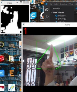

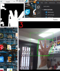

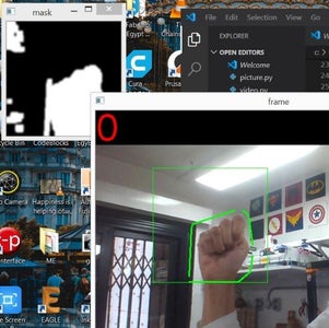

Hand track and counting
In order to make hand track we need to install a library called math it’s easy to install I will leave links and codes down
How does hand track work?
In order to detect fingertips, we are going to use the Convex Hull technique. In mathematics, Convex Hull is the smallest convex set that contains a set of points. And a convex set is a set of points such that, if we trace a straight line from any pair of points in the set, that line must also be inside the region. The result is then a nice, smooth region, much easier to analyze than our contour, that contains many imperfections.
To detect the Fingers and count them.
Find the ROI(region of interest)
Hand Segmentation: Convert the video frame from BGR to HSV(or Gray)
Perform a Gaussian blur
Perform a Threshold
Find the Biggest Contour(this will be our hand)
Perform a convex hull and mark the ROI(region of interest
Count the no. of countors
Display it
Samples
very well. You can find the original code here. Then, found another source that illustrates how the counting of hand fingers' code works. You can find it here.
Now for the final step: mix the two codes together (face recognition and hand tracking)
Just bring the face recognition code and merge it with hand tracking code in one big code, don’t forget to edit the variables
Sample of code
And here is a video for Amani after she finished the whole code Here is a video of the mixed code running

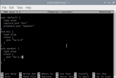

Configure and Test the Audio Test the microphone and speaker to make sure they are working well. To do so, Frist, open the terminal then write “a play -l” to find the card number and device number allocated for the microphone and speaker. Don’t forget to write down these two numbers for the microphone and speaker as we will need them later.
Second, Create the (asoundrc) file by writing this command “sudo nano /home/pi/.asoundrc”
on the terminal
Third, replace all the text inside it with the following text “ pcm.!default {
type asym capture.pcm "mic"
playback.pcm "speaker"
pcm.mic
type plug slave
{ pcm "hw:,"
pcm.speaker {
type plug slave {
pcm "hw:,"
Fourth, replace it with the numbers that you wrote down earlier.
Fifth, save and exit the file by clicking (Ctrl + x) then (y + Enter)
Sixth, type “alsamixer” on the terminal and raise the sound level of the speakers
Seventh, test the speakers by typing “speaker-test -t wav” on the terminal, by clicking enter you should
hear (left, Front) from the speakers then click (Ctrl + c) to stop it.

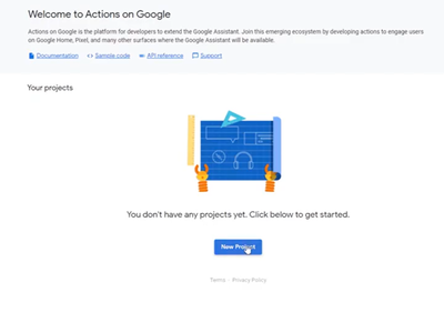

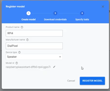

Configure a Developer Project and Account Settings and Register the Device Model
First, open your internet browser go to “console.actions.google.com” then select (new project) and
enter the name of your project
Third, after clicking on (REGISTER MODEL), click on (Download OAuth 2.0 credentials), save the json file
as we will need it later, then skip the specific traits options
Fourth, go to “console.developers.google.com/apis” then click on (Enable API and services), search for
Google Assistant API and enable it
