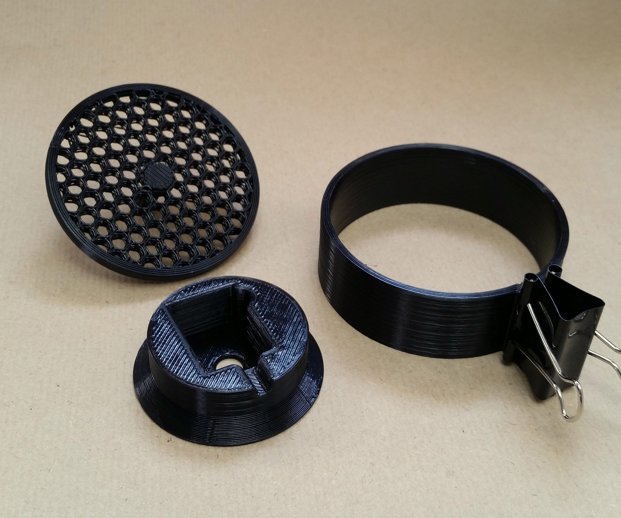

Step 2: Design and Print the Knob:
First step will be to design and print the enclosure and knob for your customisable controller.
I will be including three different designs one is a printed inner with a mold to cast concrete into for a stylish weighted controller and the other is for a fully 3D printed version that is easier to make but because of its light weight it tend to move around alot and will probably need some sticky tape on the bottom to keep it at bay. The third simply has space on top for a 3mm acrylic circle which an LED can be fitted to for some extra style points!
Tinkercad Link
The components were designed using Fusion 360 and is super easy to print in any filament with no supports needed.
I have included the step files as well as making it available on Tinkercad for easy customization to suit your needs.

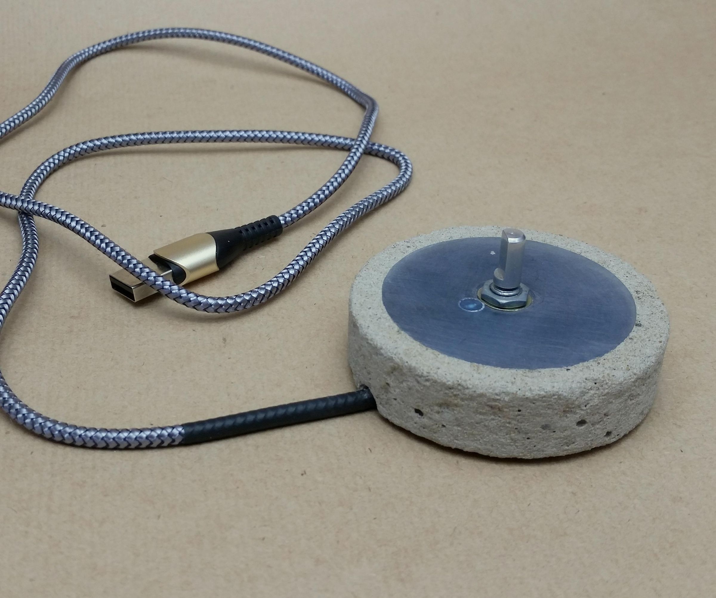

Step 3: Optional: the LED Lighting
This step is optional and only necessary if like me you want your button to have some snazzy underglow.

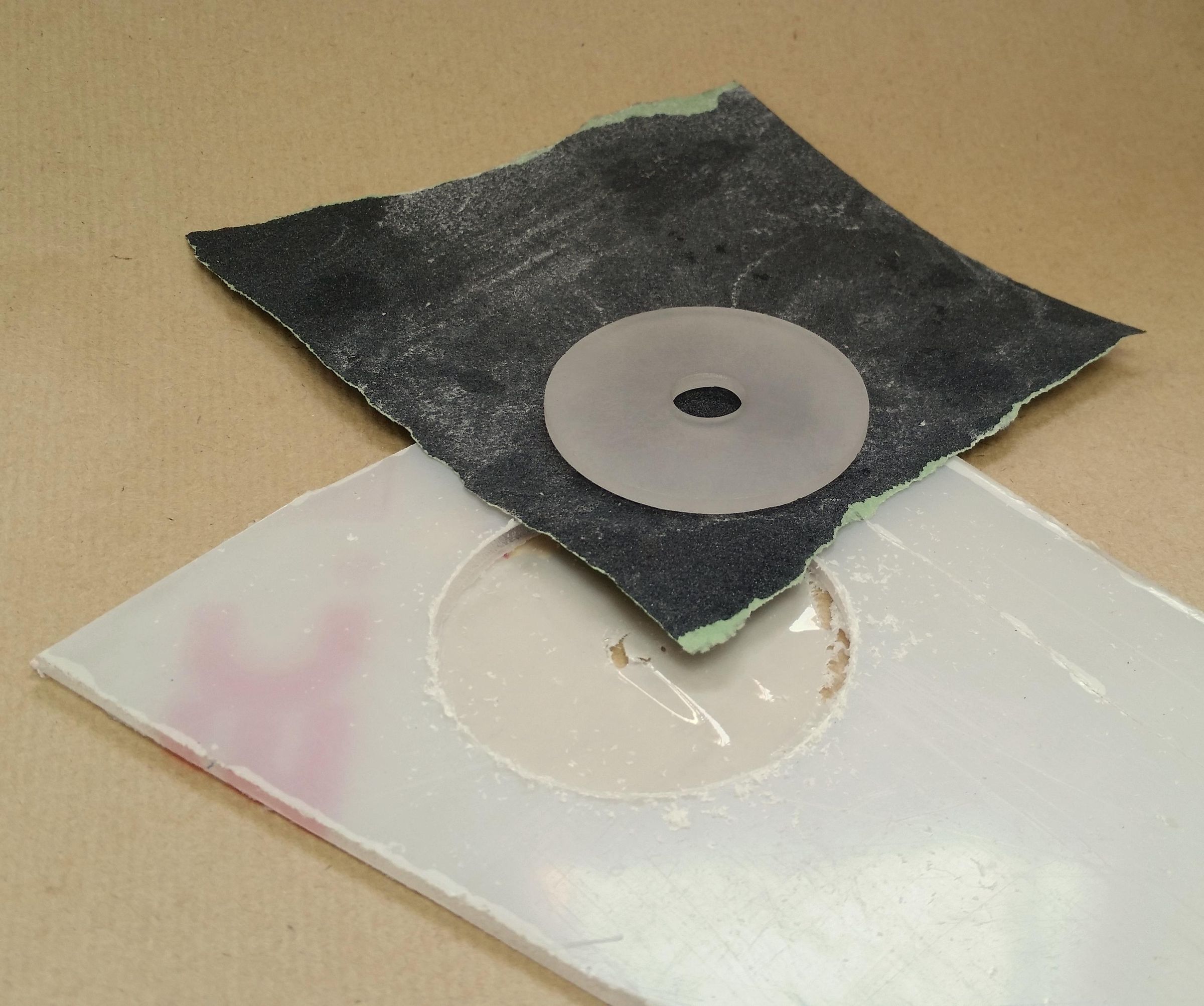

Start by cutting a 55mm circle out of clear/opaque acrylic/polycarbonate/plexiglass, this can be done with a holesaw or by hand but as I was busy with another project on my little DIY CNC I quickly used that.
The centre hole needs to be 7mm.
I sanded the clear plastic with some 400 grit sandpaper to make it opaque for better light distribution. Then simply glued it onto our 3D printed main body using some 2 part CA glue.

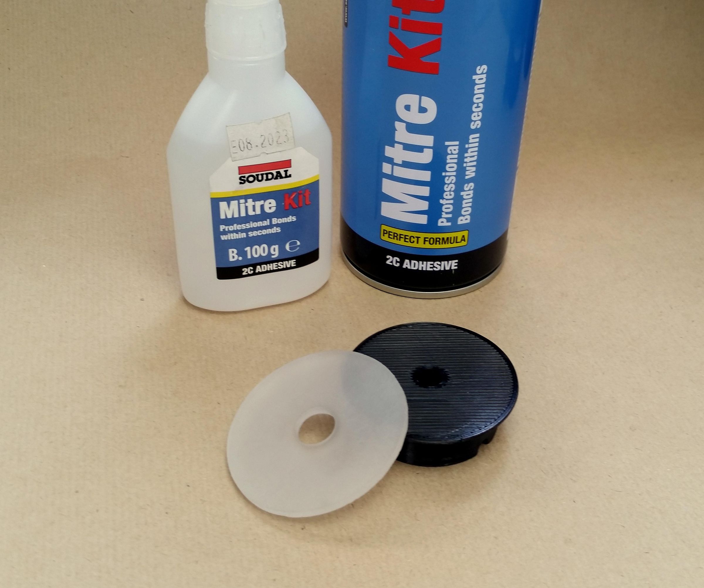

Next I made a 5mm hole through the body and acrylic for a 5mm LED to fit through. I then snipped off the legs from a blue diffused 5mm LED and soldered on some wires.
I then glued the LED in place with the same CA glue and sanded it flat with the acrylic.
Test to make sure it works then we can move on to the next step.

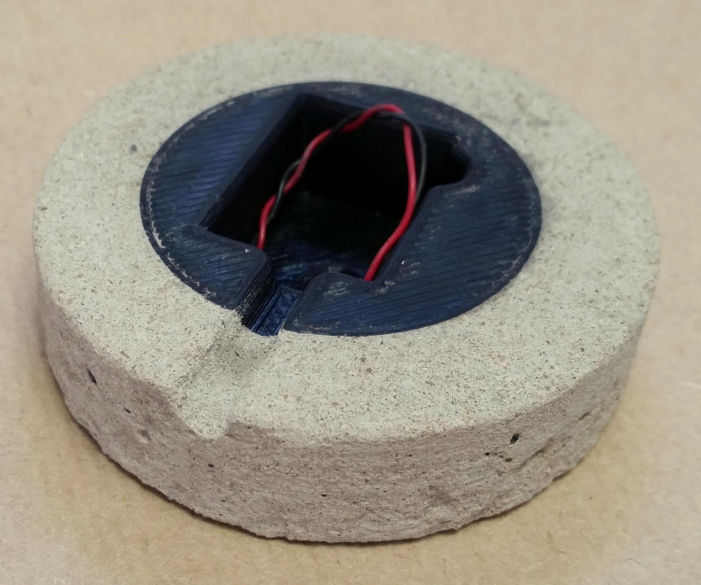

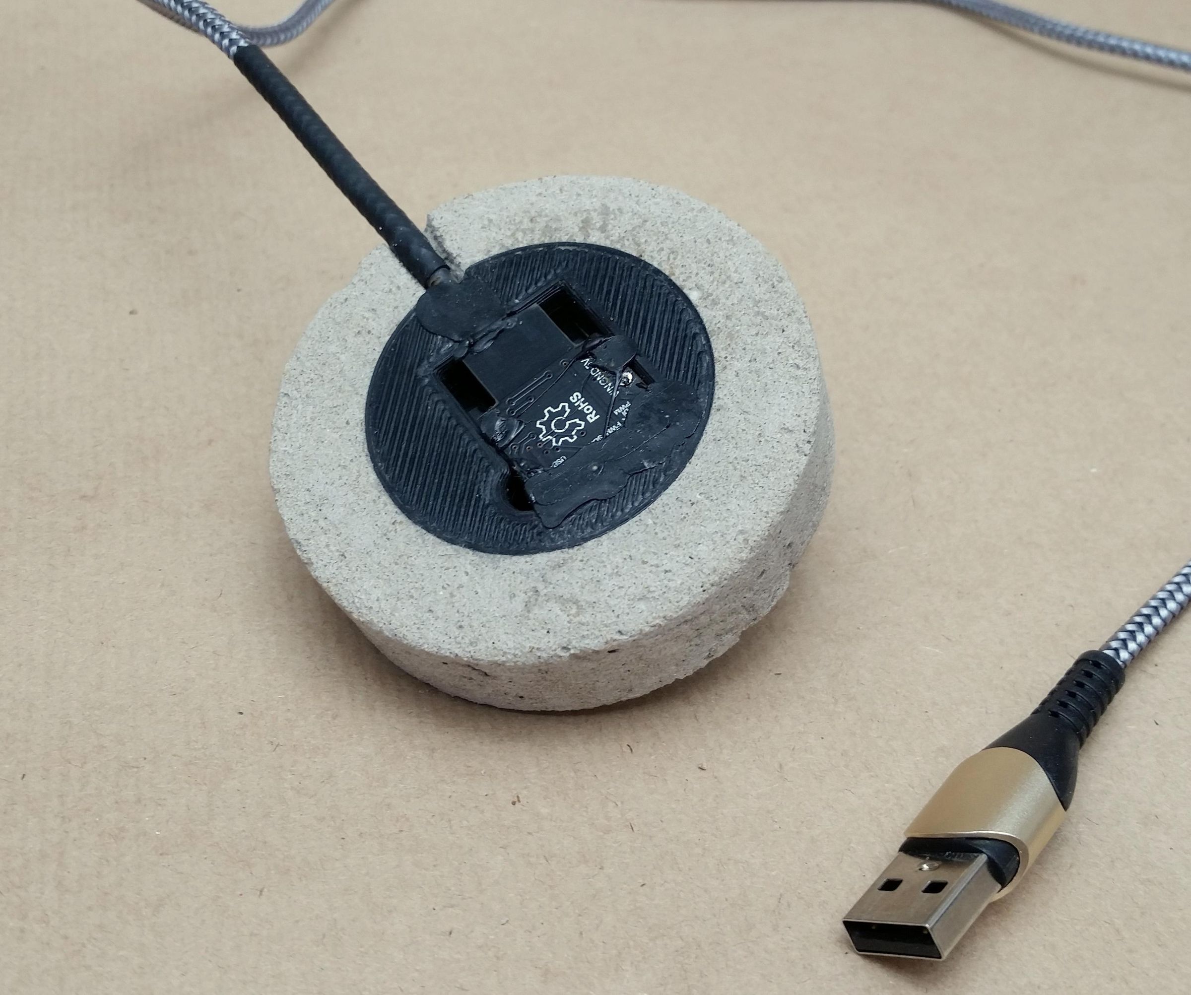

Step 4: Optional: Casting the Concrete Base
If you decided on the concrete base for the button then we can now get to casting it.
I started by sticking the main printed body down onto a plastic plate using some blue-tak this will keep it in place and prevent the concrete from seeping into the electronics cavity.
Next I placed the mold over the main body and centred it using the printed centring jig and held in place by blue-tak before removing the centring jig again.
Next I mixed up a small cup of concrete premix and vigorously tapped out as much of the trapped air as possible before pouring it into the mold.
Let it cure for at least a day before demolding.

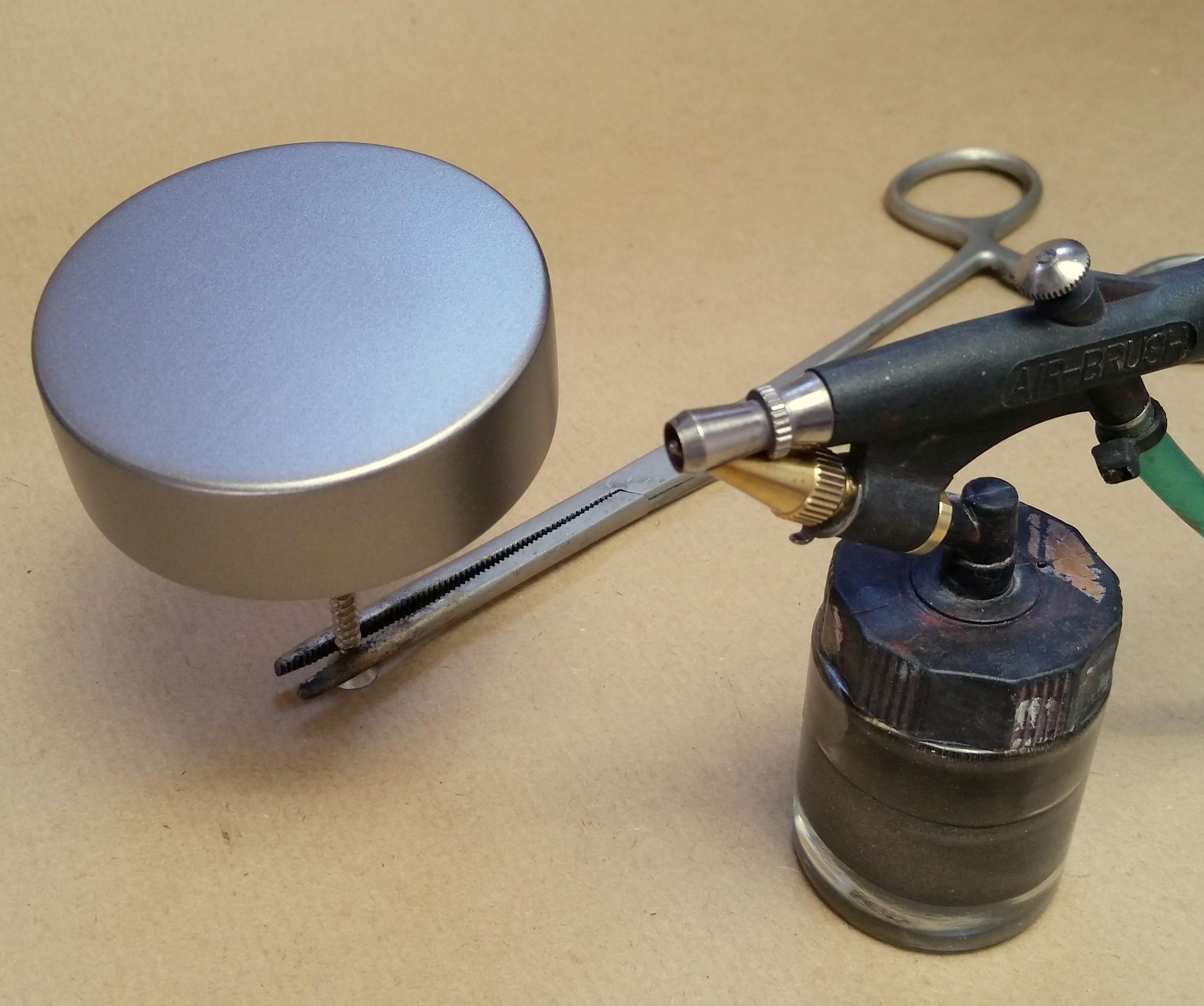

Step 5: Refine the Enclosure:
With our concrete base made we can start refining the enclosure.
I started by sanding down the surface of the button to give the filler a coarse surface to grab onto. I smeared the entire button with a thin layer of filler before sanding with 220 grit sandpaper and priming.
Once the primer has dried completely we can wet sand it with 400 grit sandpaper and move on to the final spray painting.
I chose to spray mine with this beautiful gunmetal color with my airbrush that almost makes it look like a casted metal piece. Now set it aside to dry completely.
Next up I sanded the concrete a little to soften the edges and I also used a drill bit scrape a slot into the concrete for the cable to lay in.

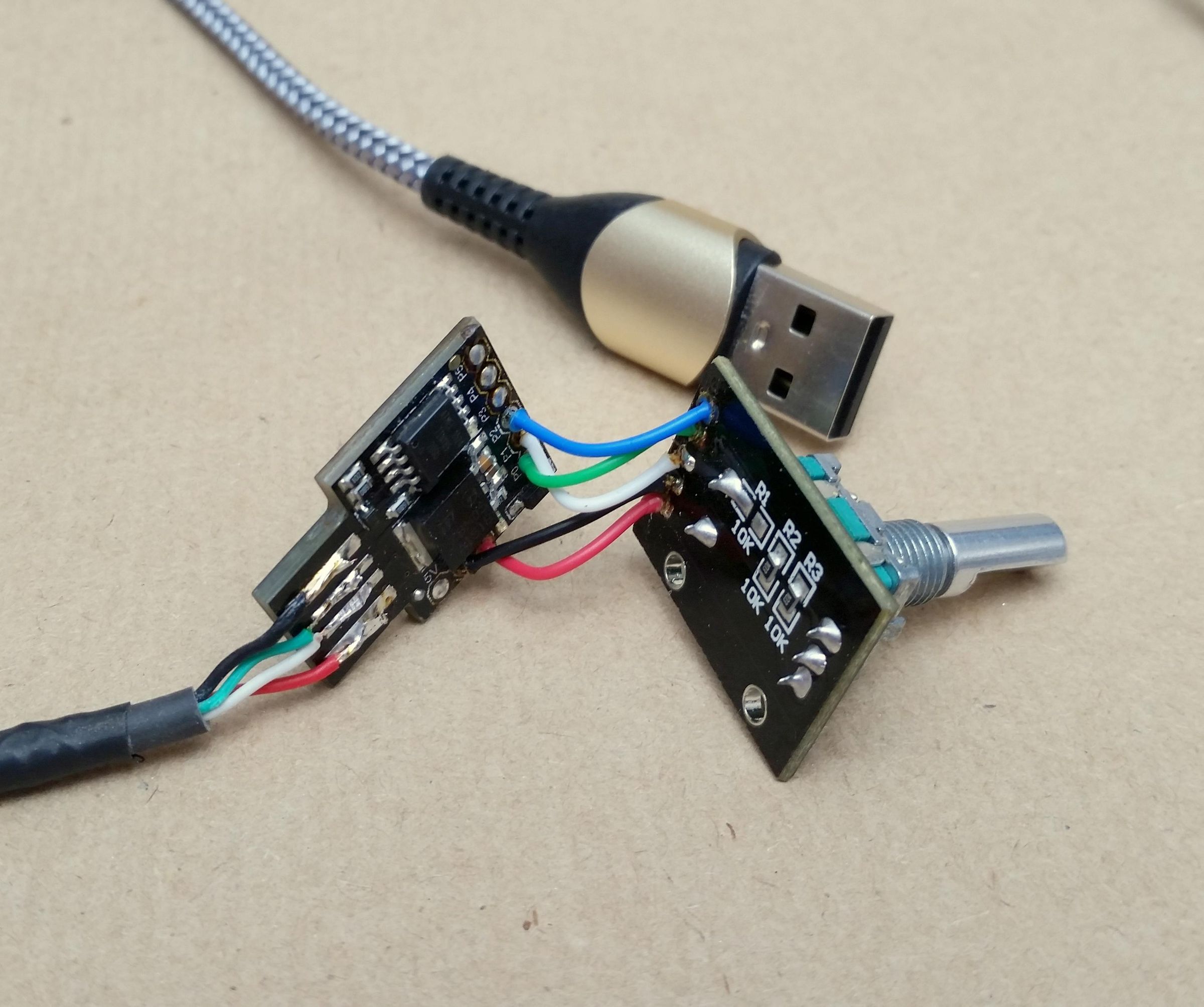

Step 7: Test the Electronics:
Before soldering anything we want to make sure the electronics work.
If you haven't used a Digispark Attiny85 board before you will need to install it's drivers and install it onto the Arduino IDE which I will go over in the next step.
I first uploaded a simple blink code onto my Digispark board to make sure it was functioning correctly.
Then I uploaded the code and unplugged it when it was done.
Next connect the Digispark to the rotary encoder with jumper wires as follow:
 Digispark to KY-040
 P0  to DT
P1  to SW
P2  to CLK
 VCC to GND > This is not a mistake
 GND to 5V ^
Once connected plug it into your computer and see if turning the rotary encoder adjusts the main volume.
If it doesn't work as intended double check your pins or change the pinout in the code to one following:

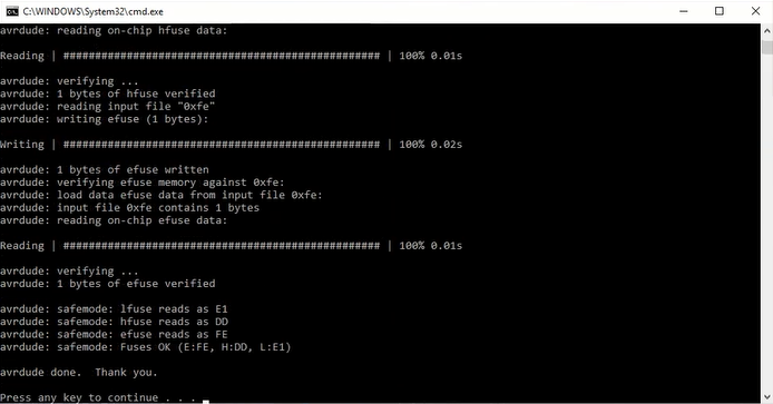

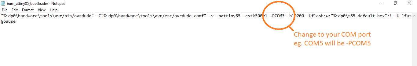

Step 8: Fix Digispark (Attiny85) "USB Device Not Recognised" Message
If you are receiving the infamous "USB Device Not Recognised" pop-up when inserting the the Digispark/Attiny85 board into your computers USB port you can try the following which fixed all of my previous unusable Digisparks.

  • Then you will need an Arduino board (UNO/Nano etc.) with the "ArduinoISP" sketch loaded that can be found under "Examples".
  • With the code loaded connect your Digispark to the Arduino as pictured above via jumper wires.
  • In the downloaded folder under "Attiny85 Firmware update" open the" t85_default.hex" file using notepad and change the COM port to the port your Arduino is plugged into as shown in the picture below, Save the file.
Drivers and Firmware Update LINK
  • Next copy both the "t85_default.hex" and "burn_attiny85_bootloader.bat" files over to your main Arduino IDE installation location eg. C:\Program Files (x86)\Arduino
  • Now run the "burn_attiny85_bootloader.bat" file.

Using short flexible wires solder each point from the Digispark to the rotary encoder as you had them connected with the jumper wires.

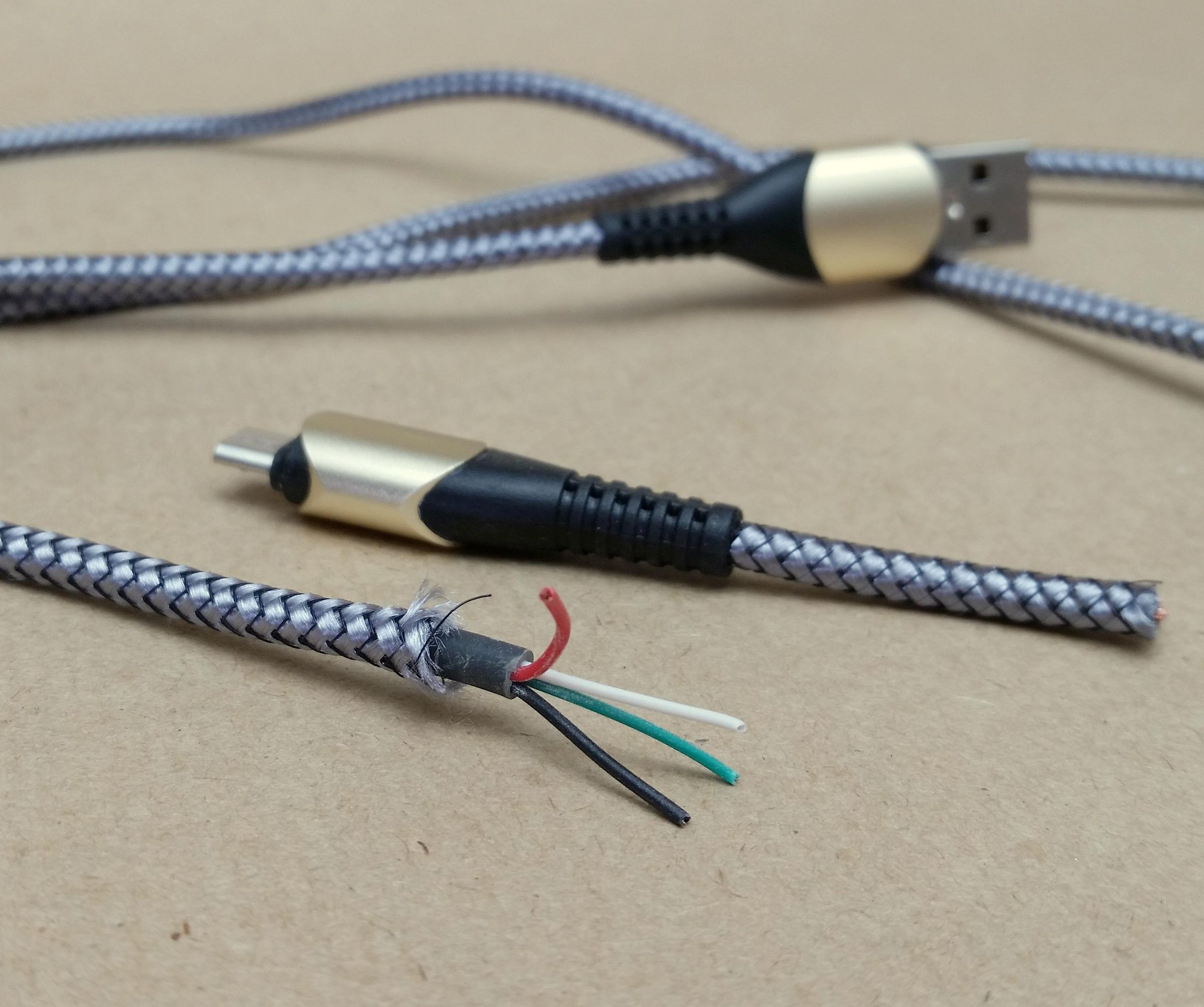

Next we need a USB connection.
Using a beautiful braided USB data cable I got from a bargain bin sale I snipped off the micro USB side of the cable and exposed the wires.
Solder the wires from the USB cable onto the Digispark as shown in the picture below.
Last piece to solder was the LED that was soldered to the USB 5V through a 100ohm resistor to limit the current going to the LED.

Start by pushing the rotary encoder through the 7mm hole in the top of the enclosure and tightening it with the included washer and nut.
Next I pressed the Digispark into place underneath the rotary encoder and used some hot melt glue to keep it in place. (I still need to modify the design to include a lid but will update here when it is completed)

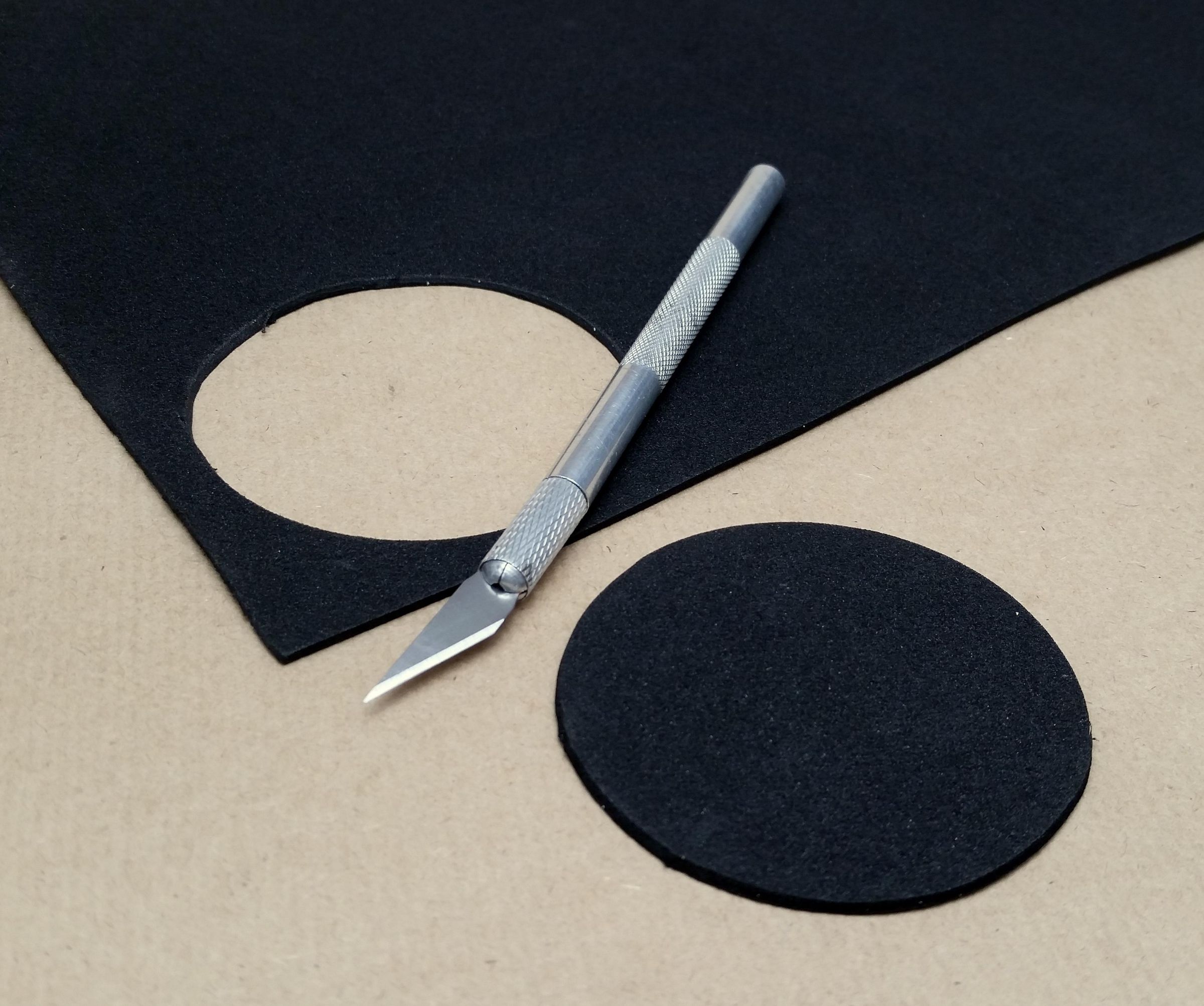

To protect my desk and keep the button from slipping I cut out a disk of thin black foam (sold at craftshops as kids party foam) and glued it to the bottom of the button.
Now simply push on the button cap and your multimedia button is done and ready for work!
