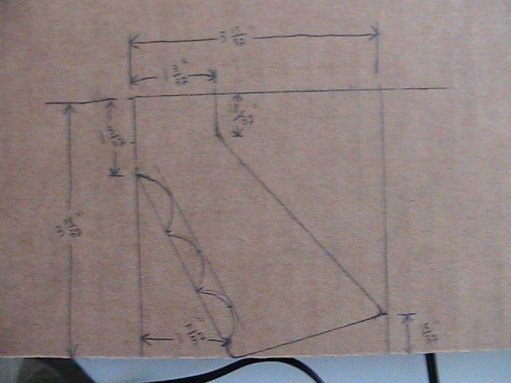

Step 3: Create the Handle - Part 1: Cutting the Cardboard
The handle is usually a good place to start, so let's build it! For this step I'll go into detail on the method I use to cut and glue cardboard, but for future steps I'll simplify it down more because that same method is used each time.

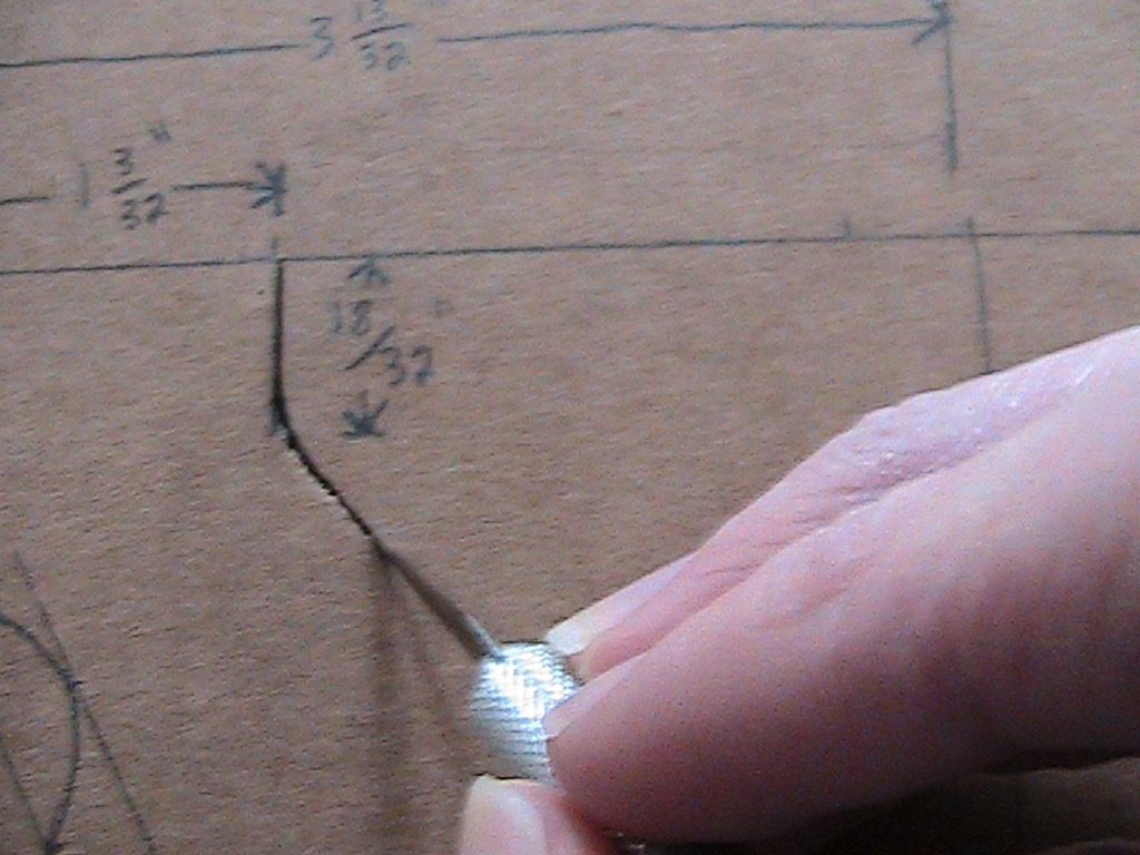

1. Draw Lines
First we're going to trace out the feature on a piece of cardboard. This can sometimes take a decent amount of time, so don't rush it. Use a ruler to make every line perfectly straight, and use the triangle to make perfect 90° angles. Also, remember to use your scale factor every chance you get. Learn to love it.

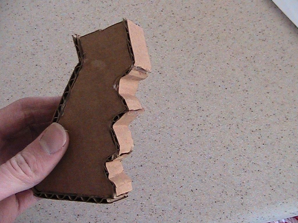

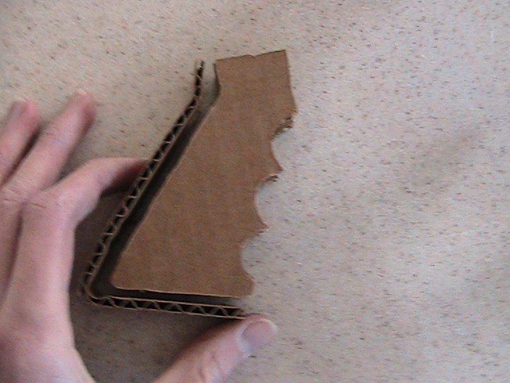

2. Cut it Out
Cutting out the part seems easy, and it is, but I recommend you be a perfectionist when doing it. We want every edge and every corner to be precise enough so that everything fits together later on. When cutting, DO NOT USE SCISSORS. This is very important, hence why it is in caps. Instead, use an X-Acto knife. The X-Acto knife is not only easier to cut with, but it gives you much cleaner, more accurate cuts.
3. Check over
Once the part is cut out, give it a quick look-over to make sure everything feels right. So for the handle, hold it in your hand and pretend you're holding a gun. If it doesn't feel right, then go back and check your measurements and recut as needed.

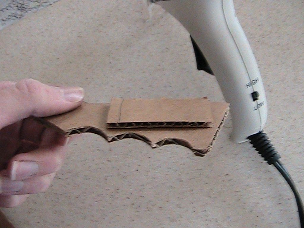

Step 4: Create the Handle - Part 2: Gluing

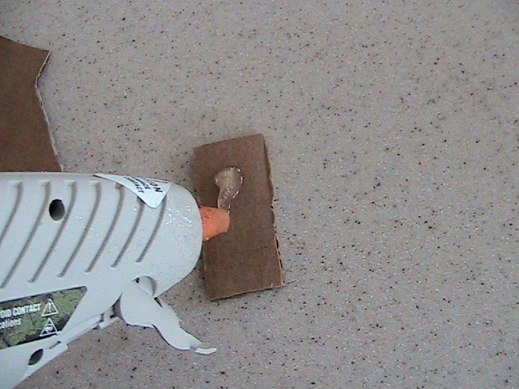

With the handle cut, we're going to move on to gluing it. Use a hot glue gun for this, and make sure it is on the "high" setting (if your glue gun only has one setting, ignore this).

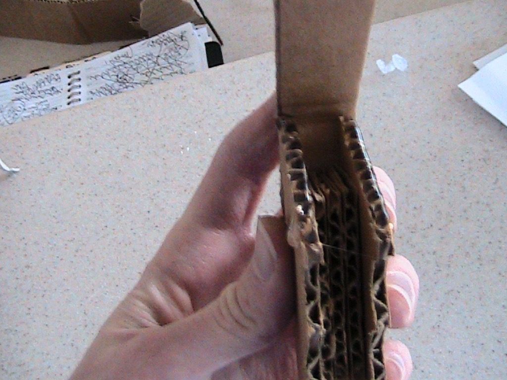

4. Glue on filler pieces
For the handle to be sturdy, we are going to glue in "filler pieces" of cardboard. These allow you to have a tight grip without worrying about destroying it.

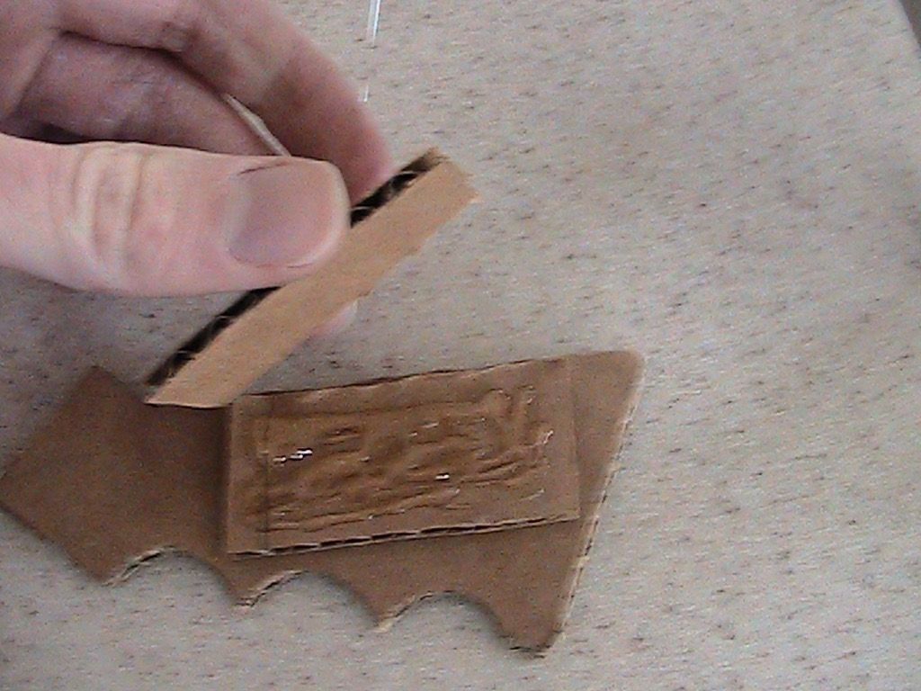

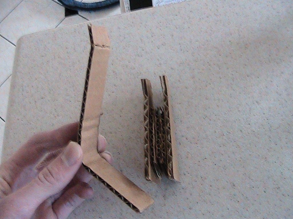

5. Glue on a border
Last step is to glue a border around the handle. Cut out a long strip of cardboard the same width as the handle. Also, pay attention to the "grain" of the cardboard. To allow the border to bend and take the shape of the handle, cut it out so the grooves run perpendicular to the long side of the strip.

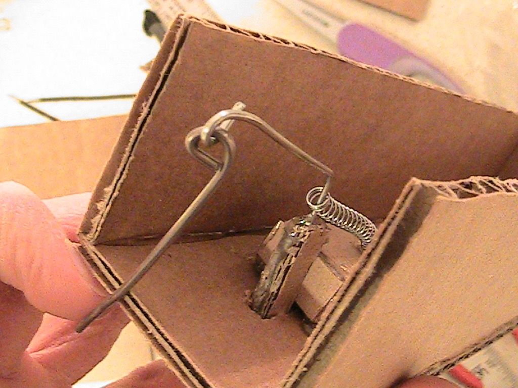

Step 5: Make a Trigger

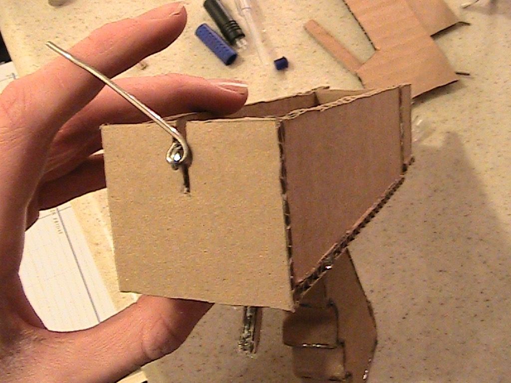

With the handle complete, let's move on and make a trigger. The trigger is spring loaded and will eventually be connected to the firing system, so be patient and don't rush it.
- Start off by gluing the handle onto a piece of cardboard that will serve as the bottom of the gun. The piece I cut was 6.84" x 2", but feel free to vary that size. When cutting pieces, I try to visualize what the picture of the gun would look life if it were broken down into individual components. The more components you use the more detailed the gun will be, but the more complicated it will be to build.
- Cut two identical pieces of cardboard shaped like a trigger. (see the pictures)
- Bend a paperclip to match that shape, and glue the paperclip between the two cardboard triggers. This should form a sort of "paperclip sandwich" with the cardboard as the bread.
- Cut a slit into the gun where you want the trigger to be, and position the trigger in place.
- Feed a thick piece of metal wire through the cardboard of the gun (running through the ridges) and pierce it through the center of the trigger. This piece of metal wire serves as a hinge on which the trigger can rotate. See the pictures above to see what I'm talking about.
- Right behind the trigger, glue a stack of cardboard to serve as a stop for the trigger. Make sure that when the trigger is up against the cardboard it is in a good "neutral position." If not, then move the cardboard stack closer of farther until it looks good.
- Glue a small piece of paperclip wire into the cardboard stack that will serve as a hook for a pen spring.
- Take a pen spring (found by taking apart a clicky pen) and connect it between the paperclip hook and the paperclip coming out from the top of the trigger.
Once the trigger is finished, play around with it for a bit to make sure it feels right. If it feels too lose or tight, adjust the position of the hook, or use a different sized spring.

- Start off by cutting a piece of cardboard as shown in picture one that will be able to cover the entire shooting mechanism, as shown in picture two.
- Once cut, glue it together as shown in picture three.
- Make sure the covering fits like in picture four.
- Lastly, build a rail on top like shown in picture five. Atop this rail is where the scope will be mounted.
