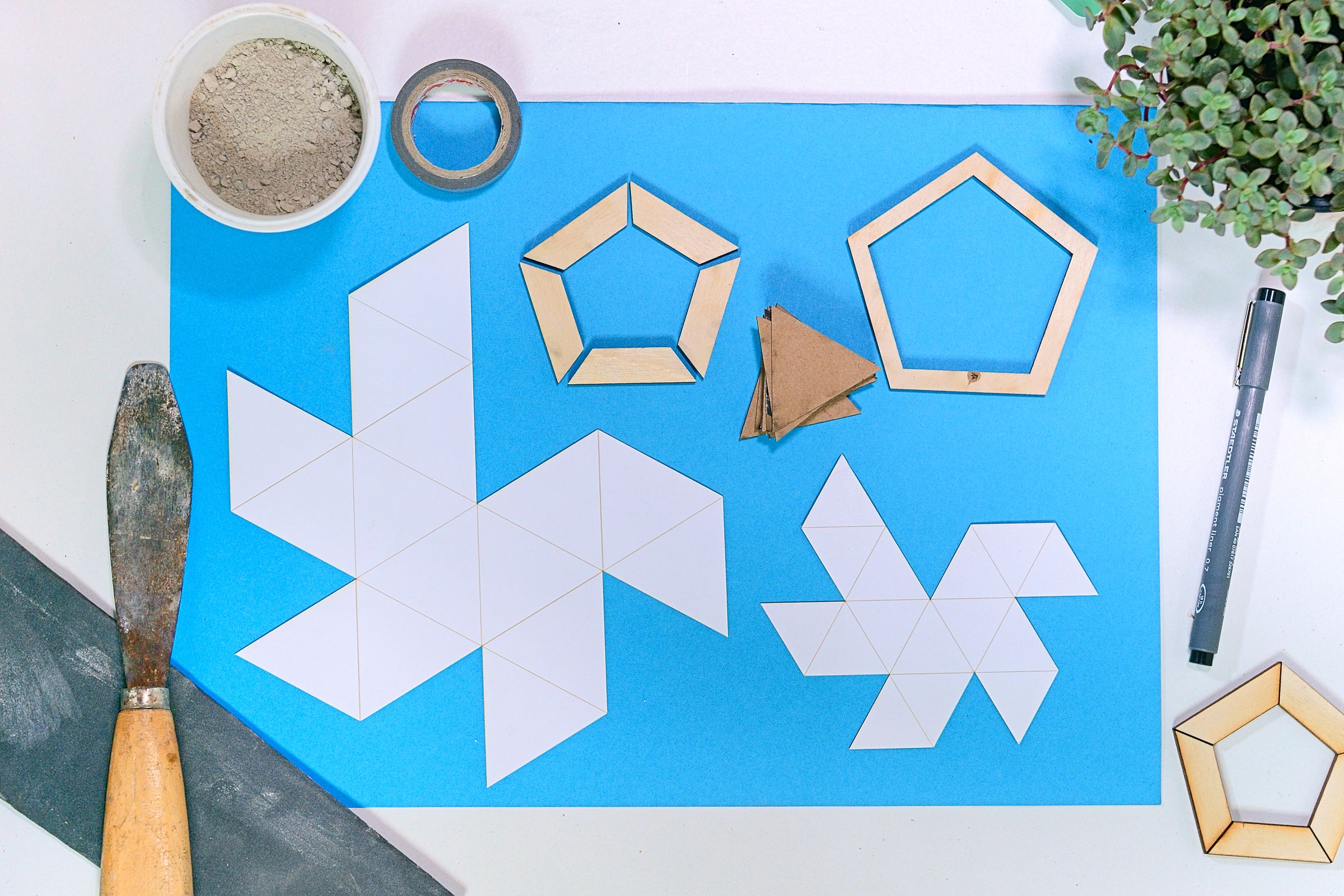

Step 1: Cut and Engrave the Paper, Cardboard, and Plywood
To begin, you will need to cut out the shapes from the template files which are available for download.
I used a laser cutter for the cutting, but you can also use just scissors or a utility knife and a saw. There are three templates: for the cardstock paper, the cardboard and for the plywood.
In the template for the cardstock paper mold, there are red and black lines. The red lines are for cutting and the black for engraving/scoring. The engraved lines mark where the paper will be folded and also act as a score line so that you will get very clean folds. Just make sure that the engraving is not too deep because then the paper might tear when you fold it.
If you don`t know the settings of your laser for cutting and engraving paper make some test cuts first.
In the template for the cardboard and plywood, there are just red lines. Cut out all the pieces, and you are ready for the next step.

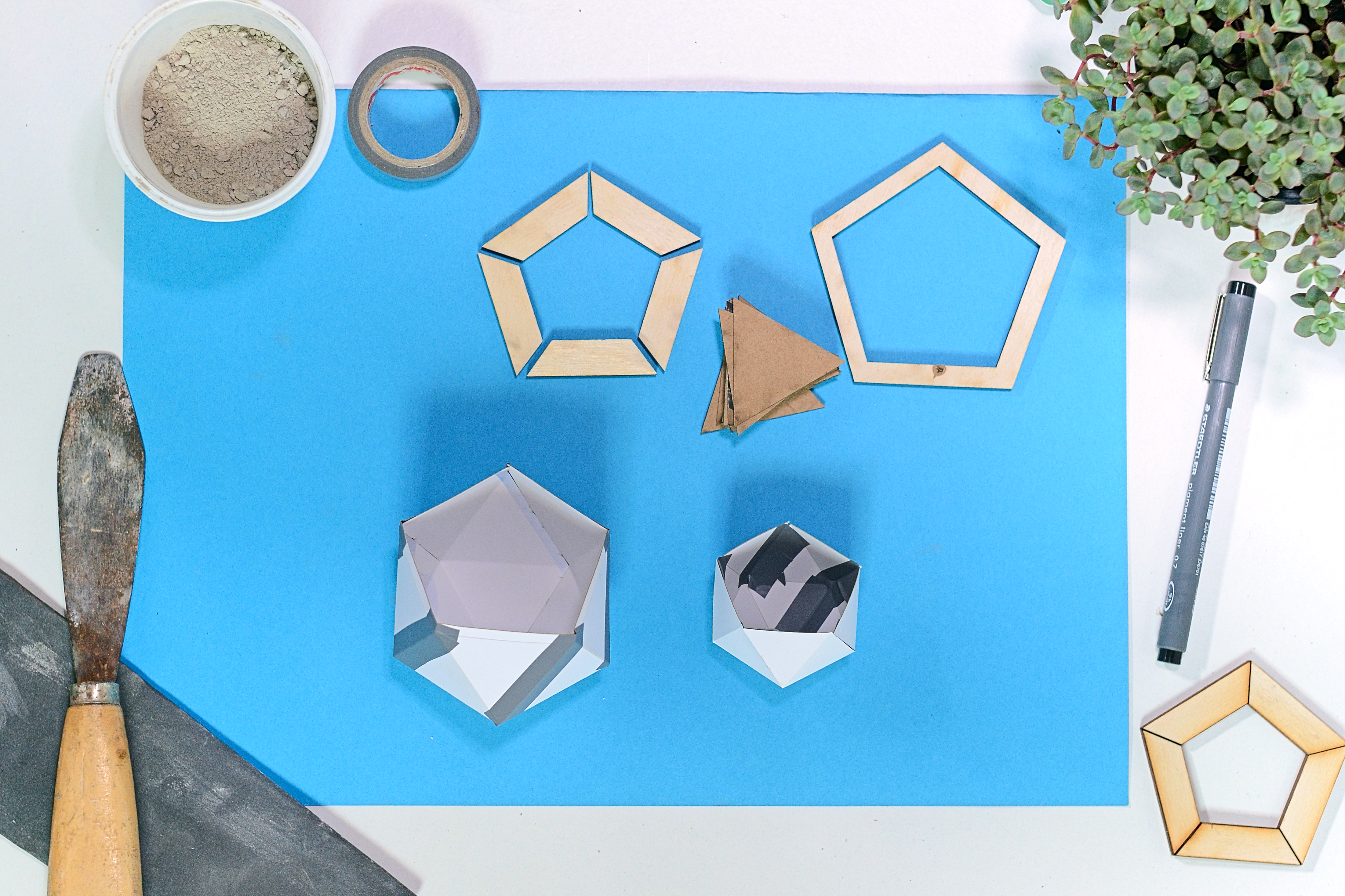

Step 2: Fold and Glue the Cardstock Paper
First, slightly bend the cardstock paper along the engraved/scored lines. For the outer mold, I folded the paper so that the engraved lines were on the outside and for the inner mold the engraved marks were on the inside.
Then I used strips of tape to glue adjacent triangles together and create the shape of the inner and outer mold. In the image below you can see which parts should be glued together.
The tape for the outer mold was applied on the outside and for the inner mold on the inside. This way there won't be any marks from the tape on the finished concrete. I was a bit perfectionist here because when you fill the planter with soil, there is not much of the inside visible anymore. So you can save yourself a bit of fiddling when you just put the tape on the outside for both molds.

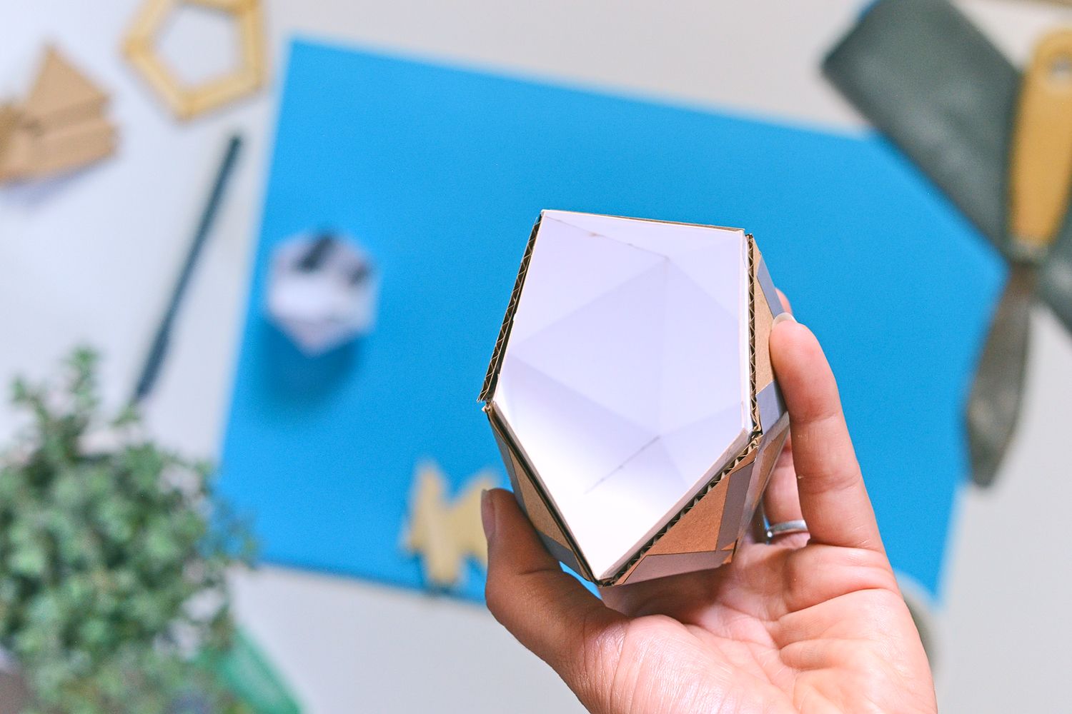

Using cardstock paper will lead to a very nice smooth concrete surface, but when I did my first test pouring with just the paper mold, I encountered two problems. The first was that while in general, the paper held the concrete really nice with nothing leaking, the damp paper expanded a bit and this caused the triangular planes to bend outwards.
An outer layer of cardboard fixes this problem. The second problem was that even with the cardboard added, the mold was still flexible. The image below shows how it can be squished.
Step 4: Adding the Wooden Support
To resolve the instability, I used a pentagon cut from plywood as a support frame. With the wood, you get a very stable mold, and the great thing is that the wood and cardboard can be reused. You just need new paper molds and can create multiple planters.
