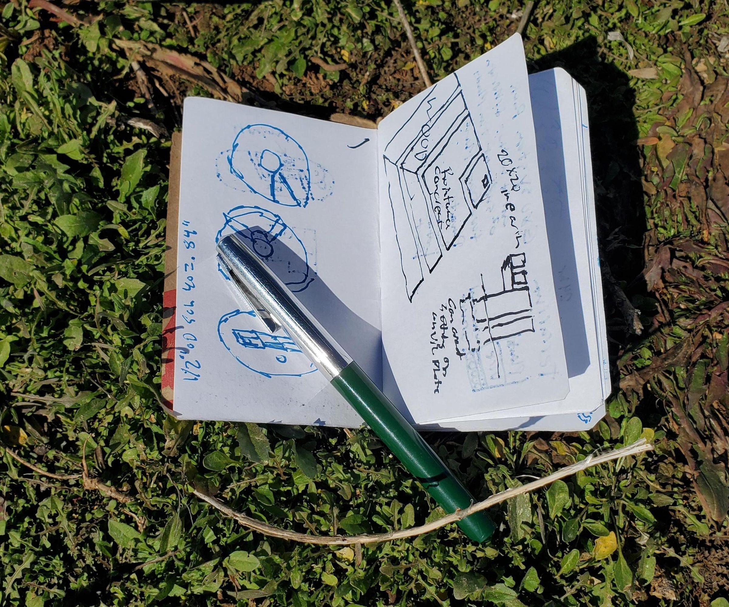

Things that might help. (I used)
- PPE: personal protective equipment. (safety gasses, gloves, hearing protection (I should have used a mask)) Mask up in Public!
- Glass to Crush
- Steel pipe with cap, about 1m long. (post pounder)
- Ram rod "long steel object to break the glass in the pipe". (T post)
- Sieve or screen with holes that will provide the desired glass size. (stainless steel window screen)
- Catch pan (litter box)
- Glass storage container (can)
- Surface that your tired of griping about due to its lack of grip. (skateboard deck)
- Adhesive polymer (polyurethane) paint or epoxy will work to.
- paint brushes your willing to throw away (the glass will ruin them)
- masking tape if needed
- optional or as needed; hammer, jar with shaker lid, utility knife, painting assisting devise (scrap board with screws in it to hold object)
