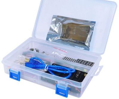

The kits make your wire connections short, clean, and easy to follow when you come back to them in the future. The refills are a bit pricey, but if you get into electronics quite a bit you will find that you don't want to live without them.
A great way to get started is to find some 22 gauge to 24 gauge SOLID wire. You don't want stranded wires in a breadboard... they just don't work well. Solid wire is useful when you want it stiff and bendable as we are doing here. Stranded wire is used when it must be flexible.
If you see the local telephone repair person ask if they have any scrap 25 pair cable. They often get it in 500 foot rolls... and if it has less than 20 or so feet will often throw it away. The cable has a string that when pulled will cut the jacket and give you a whole bunch of wires as shown in Image #3 .
