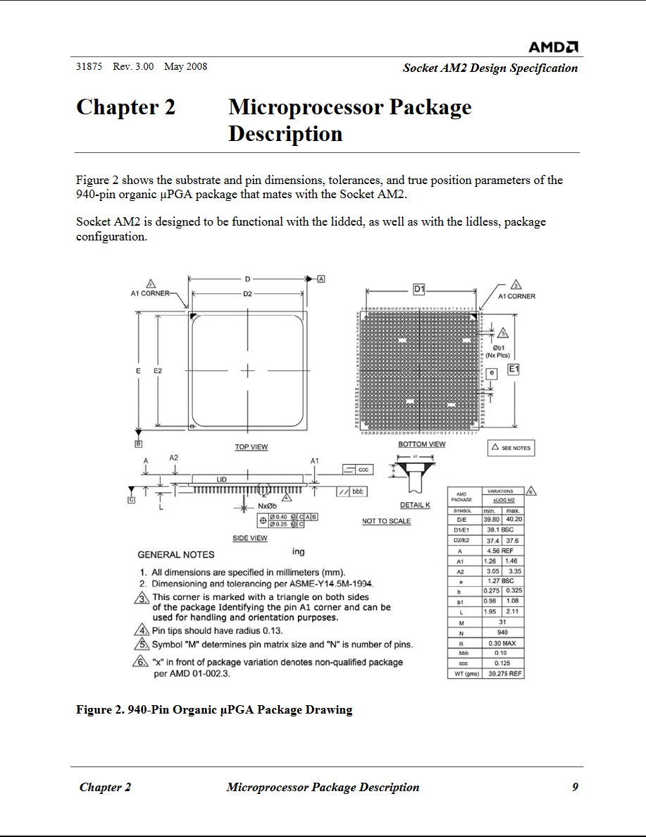

Gathering useful info
We've found this great documentation with plenty of information, it's time to extract the data we're going to use !
We need the dimensions for our CPU, in my case I could find the info at page 9 of the previously recovered document. On the same page I also found the number of pins of my CPU (940 pins) as well as the implantation of these pins.
