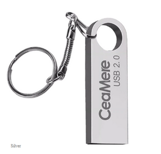

For this project, I will remake a 3d printed case for my USB drive by improving upon its flaws. My current case has far too much play in its action, allowing for unwanted movement that could cause damage to the drive. To solve this issue, I will incorporate a smaller, finer pin to reduce the amount of play in the operation of the case and add a magnetic tensioning system to prevent the case from opening unintentionally.

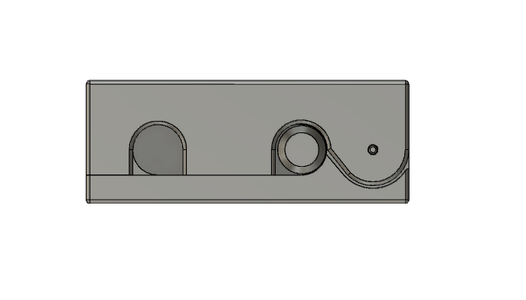

To begin this project, I first designed the case that the USB would sit in. The design is based on the Reate EXO Gravity Knife. The USB sits within a housing component with a slot cut out matching the hole in the USB. A pin is inserted through the hole of the USB and the slot in the housing component. The length of the slot determines the distance the USB can travel. To lock the USB into an open and closed position, an outer jacket is made with cutouts matching the pin. The outer jacket can pivot freely while attached to the housing component through the use of another pin. When the outer jacket swings outwards from the housing component, the USB can move freely, and when the outer jacket closes, the USB is locked open or closed. To keep the outer jacket closed and prevent the USB from moving unintentionally, a recess is cut into the housing component to allow for a magnet to be seated, and a shallower recess is cut into the outer jacket to allow for a small sheet of metal. In the closed position, the magnet will pull on the sheet and the outer jacket, keeping the case closed.

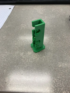

Once the case has been designed, there are three parts to print out: the pin, the outer jacket, and the housing component. I exported the Fusion 360 files as STL files, and then uploaded them to the Makerbot slicer software before printing the case on the Makerbot Replicator +. After the case pieces were printed, I removed any support material with thin wire cutters. Attached below are the Fusion 360 Files.

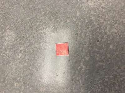

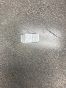

Cut out a flat section of the sheet metal using the shears, then color in a section of it with Sharpie or layout fluid. Using a pair of calipers, scribe in a square roughly 0.3 by 0.3 inches. Use the shears to then carefully cut out the square, making sure to cut on the outside of your markings. The square is meant to fit into the recess of the outer jacket, so remove material as needed until the square just fits into the recess. Once you are satisfied with the fit, squeeze a small amount of super glue into the recess and place the square in.

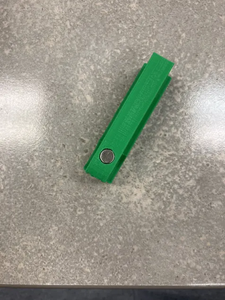

Before the case is fully assembled, take the small disc magnet and place it in the recess of the housing component. After ensuring the fit of the magnet, remove the magnet, squeeze a small amount of superglue into the recess, then place the magnet back into the recess.
