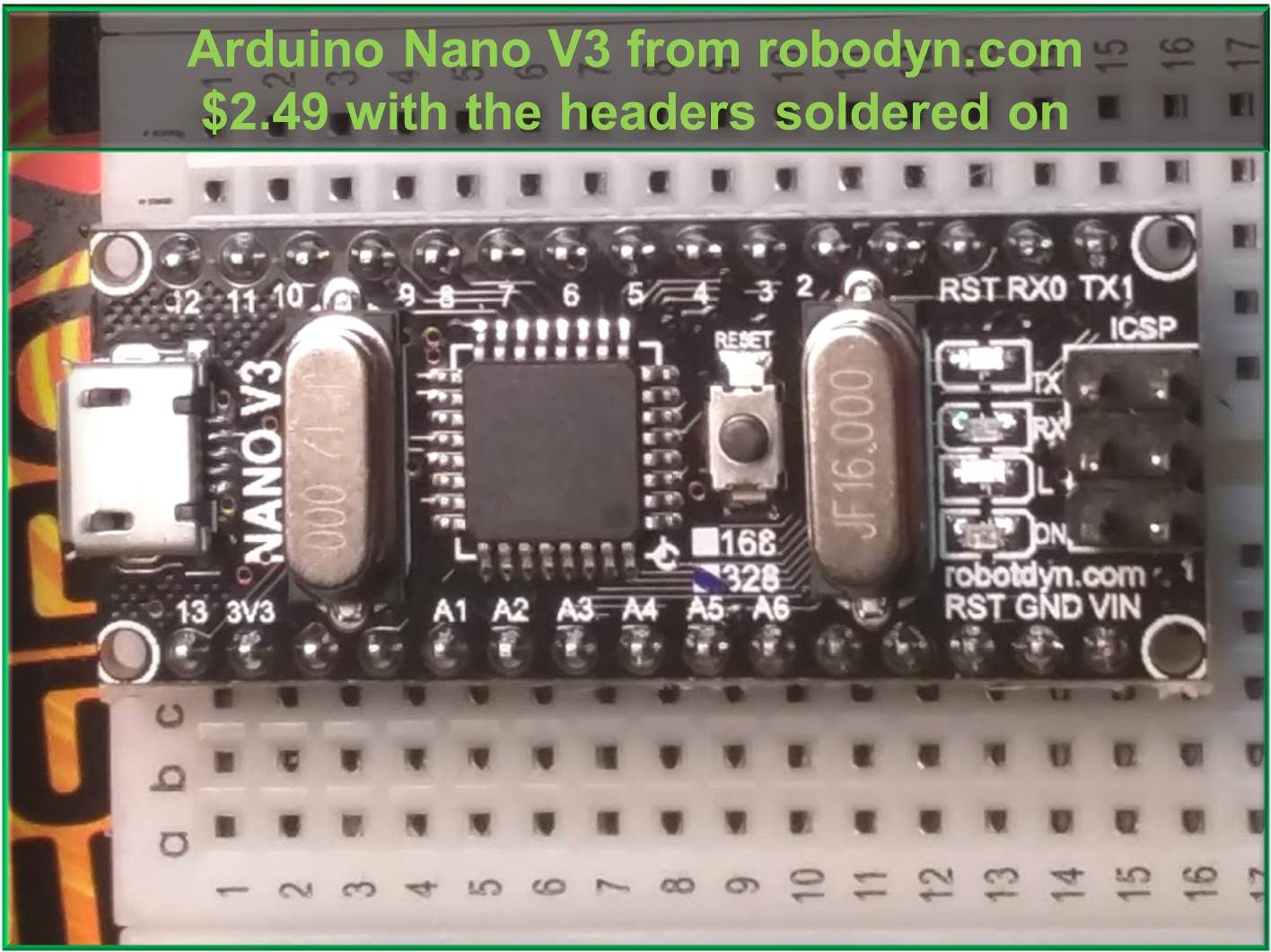

Arduino Nano
Arduino Nano from robotdyn.com

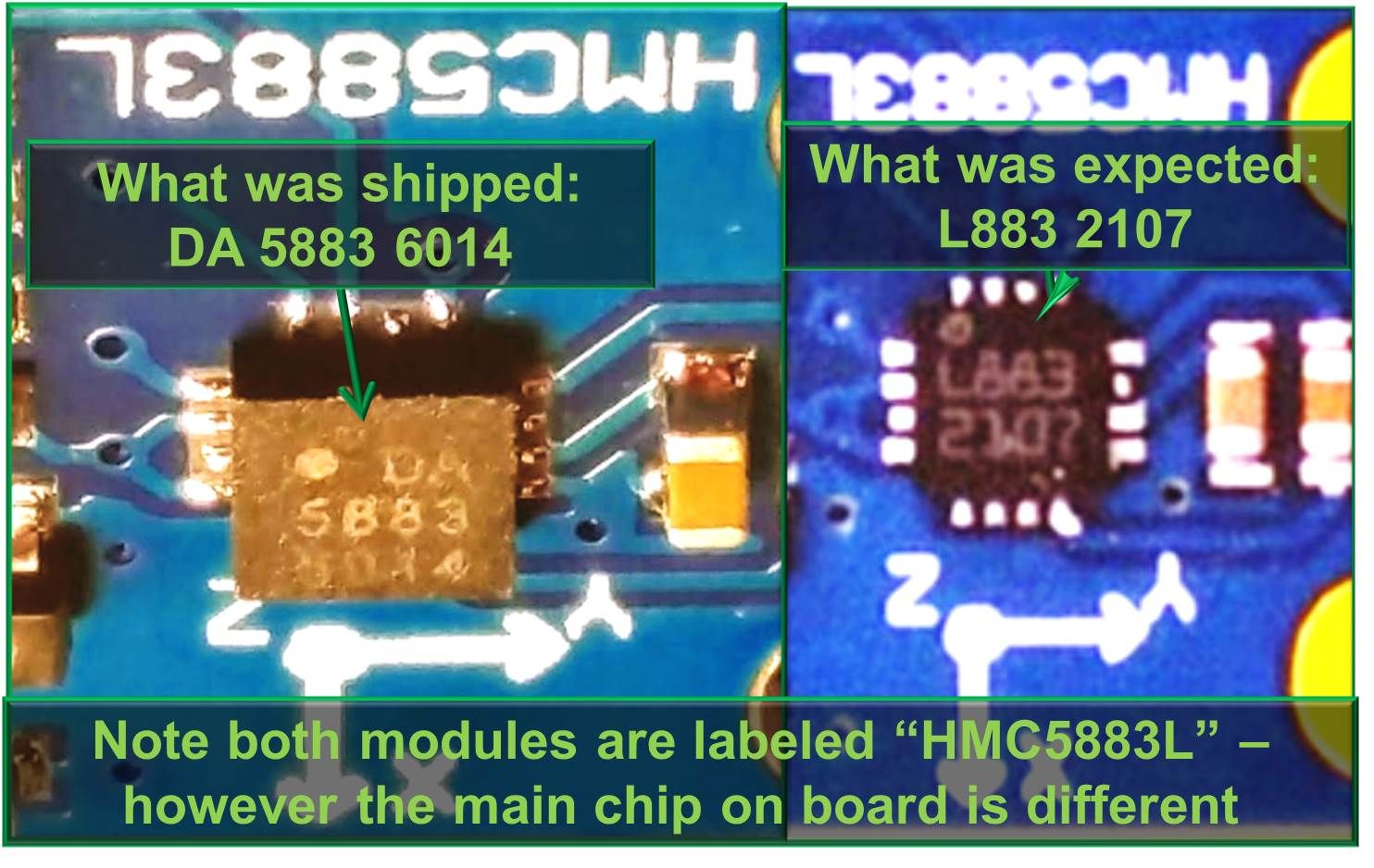

3-Axis Compass (HMC5883L) : This is the model which HackerBoxes 0021 covered, however not what arrived in my box. My Instructable references the QMC5883L, not the HMC5883L. I've found various references to this on in internet, some say the HMC is out of production. The Main difference is a difference in registers used, which means you'll need to follow the appropriate instructions for your coding (My Instructable will address the QMC5883L). Here is a closeup of the chip on the module which has markings consistent with the QMC5883L (DA 5883 6014) vs the HMC5883L(L883 2107):

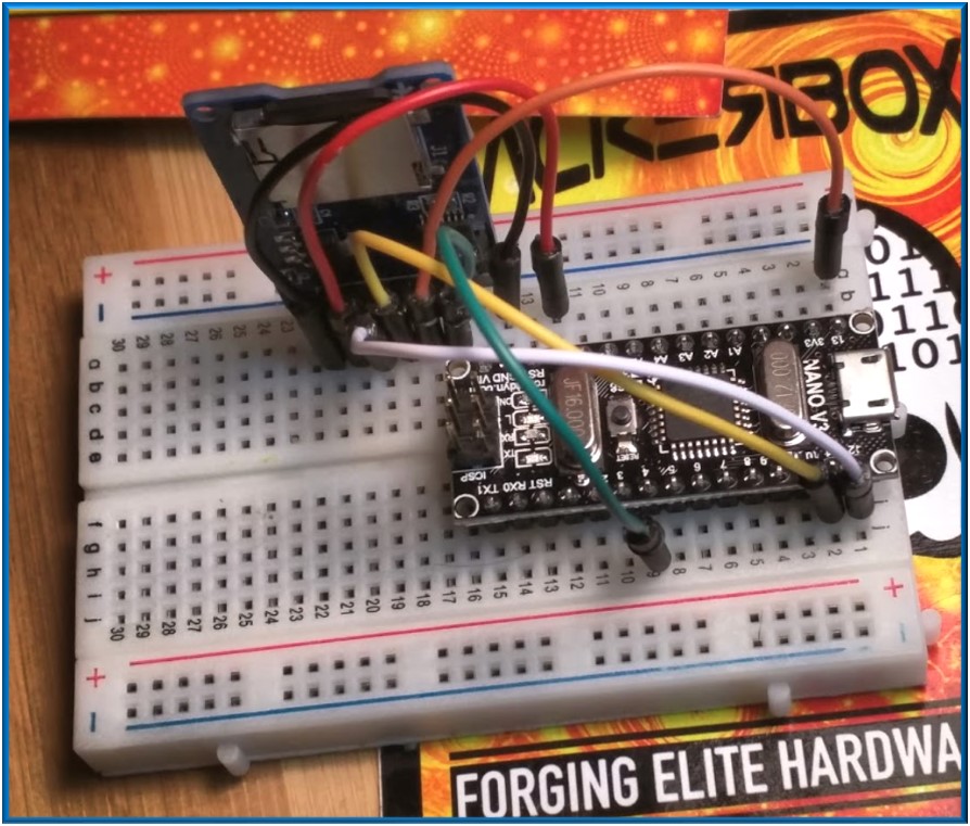

Step 3: The MicroSD Module
Add the SD Card Module and connect the jumper wires to the breadboard as shown above.
My breadboard look like this after wiring it up:
This Arduino tutorial shows the code you'll need to write to your SD card. It is also included as an *.ino file below. and here:

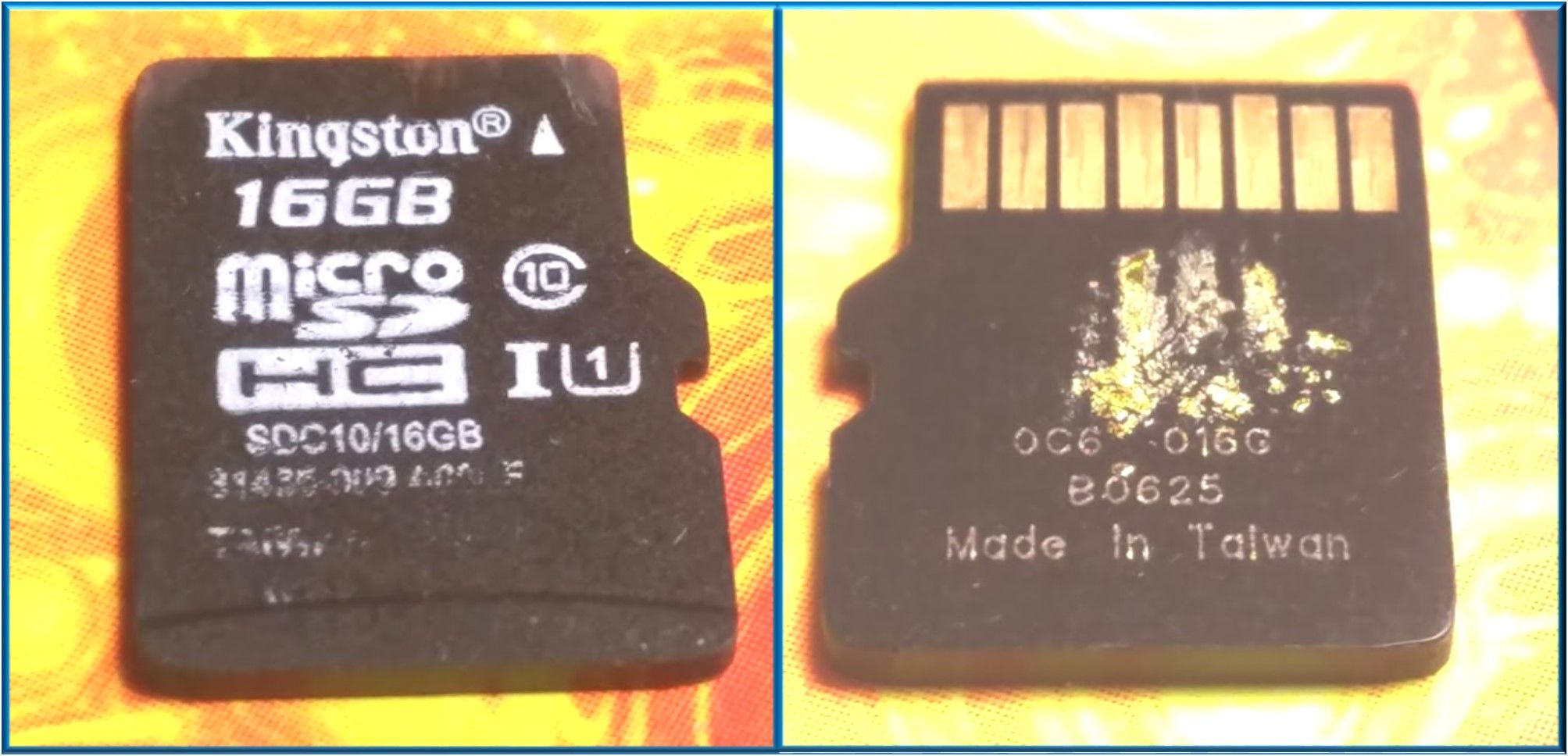

**As an interesting side note, apparently the world of SD cards is a lot more interesting than I ever knew! See these blog posts for some information about counterfeit SD cards, learn about SD card architecture, and potential ways SD cards can be hacked!
http://www.bunniestudios.com/blog/?page_id=1022
https://www.bunniestudios.com/blog/?page_id=3592
This is the MicroSD card I got with my kit, for reference:

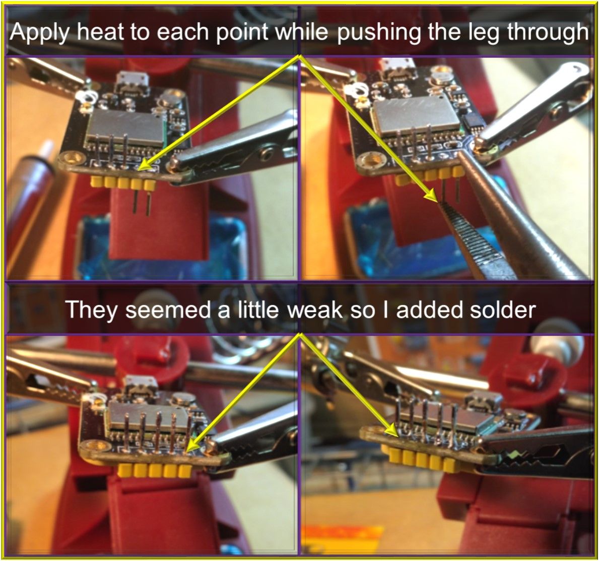

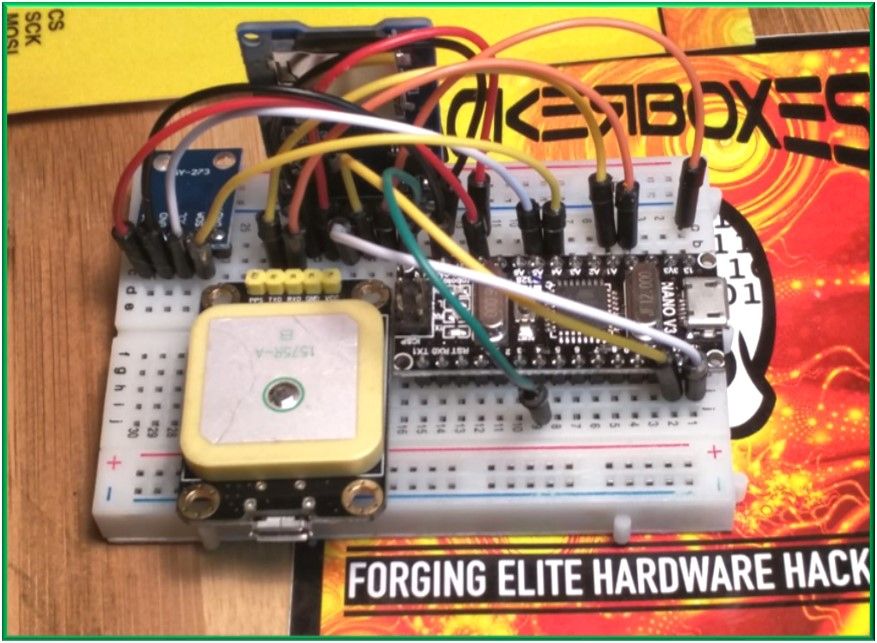

Step 4: Soldering the Headers (for Better or for Worse)
I am not really good at desoldering more than one flexible leg at a time - so 5 inflexible legs linked together looked daunting. Instead of unsoldering, I just heated each point and pushed the pins through one at a time. In this application - the spacer to the header ends up on the other side, but it still worked out to fit nicely into my breadboard. The graphic below shows the process.
Next I soldered the header on the digital compass module. I did not make sure it was straight before applying solder, therefore it came out crooked. This was a little easier fixed by trying to heat all the pins while bending it straight. It ended up fitting in just fine with all my other messed up pieces -- and they all functioned beautifully in the end.
I like how HackerBoxes, in their FAQ, says: "The goal is progress, not perfection". You'll likely screw some things up. Hopefully you've kept track of what you did (documentation! Logging!) then you can understand how to not do that again! (also, don't hide it - others can learn from your mistakes!)

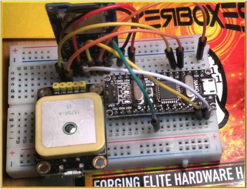

Step 5: The GPS Module
Emplace the GPS Module as shown in the graphic above. Note that the GPS Module and the SD Card module will be sharing the same VCC and GND rows, which are connected via jumper to the NANO.
Mine looks like this after connecting the two jumpers.:
I found this site that provided links to the GPS Module datasheet, which could come in handy depending on how deep in the weeds you want to get with this module. Some documents will be listed below for convenience.

Step 6: The 3-Axis Digital Compass Module
Wire is up according the the graphic above. Below, you'll see what it looks like what I've got mine completely wired up.
This website provides a great tutorial, pictures and code for this compass. - and it is useful except it is for the Digital Compass Module with the correct chip. Remember this problem from a previous step:
I found this library on GitHub, which works perfectly for me for this particular chip. I ended up using it without exploring the issue too much further or having any problems getting data.

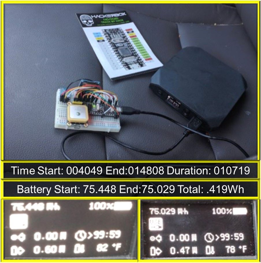

I loaded this code up, plugged this all into a battery, and went for a drive. I even left it on while I was in the grocery store. No problems, it tracked for over an hour, producing my location and the compass data every hour into the MicroSD Card. Then I copy/pasted it into that site, and it showed me my route beautifully! It was even accurate as to which lane I was in, and the side of the lane (passenger side, as it sat on my seat).
That animated GIF above shows the red light on the GPS will blink off as it gets data, and the blue light on the Arduino blinks as it is getting serial data and writing the the SD card every second (I believe).
For anyone interested, over the course of the 1 hour and 7 minutes, my battery went from 75.448 W-h to 75.029 W-h.
If you made it this far, please leave any and all constructive feedback! I'd also like to know how you plan to incorporate this in a future project.
