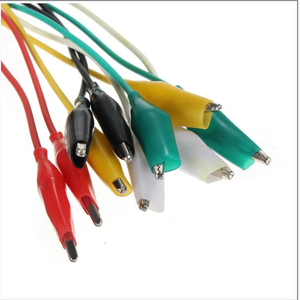

Alligator Cables: https://www.amazon.com/WGGE-WG-026-Pieces-Colors-Alligator/dp/B06XX25HFX/ref=sr_1_9?keywords=alligator+clips&qid=1698646992&sr=8-9

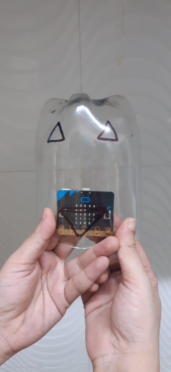

Step 1: Cutting and Marking the Recycled Bottle for DIY Halloween Lantern
The recycled bottle is cut with a warm knife. the length of the cut-out bottle used in the project is 5 inches. After this, the eyes and nose are marked on the bottle with a permanent marker as shown in Figure 1. The marked eyes and nose are cut.

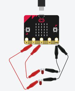

Step 3: Creating Circuit

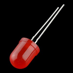

When connecting an LED, as with any component, it’s important that we connect it the right way around. On closer inspection, you will notice that your LED has one leg shorter than the other. The longer leg (Anode) connects to a power source and the shorter leg (Cathode) connects to GND (Ground). Connecting your LED the wrong way around will most likely cause your LED to blow!
Attach the two LEDs to Pin 1 and Pin 2 of Microbit through Alligator clips. The Ground terminals of both the LEDs are connected to the GND pin of Microbit. The

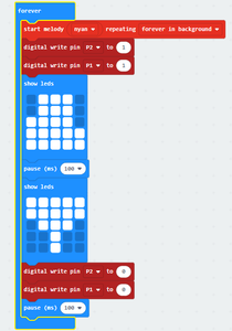

Step 4: Code the Micro:Bit
Open the Makecode Editor and code the Microbit. You can also open the code from the link below.
https://makecode.microbit.org/_3oaY58VWeLfp
The code is uploaded and the Micro:bit.

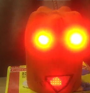

Step 6: Halloween With LEDs and Micro:bit in Action
We all are ready now to test our final creation. The Microbit is attached to the laptop (for power ) . However, you can attach the battery to Micro: bit. In that case, you don’t need to connect it to a laptop (for power). The video of the project is attached for your reference.
