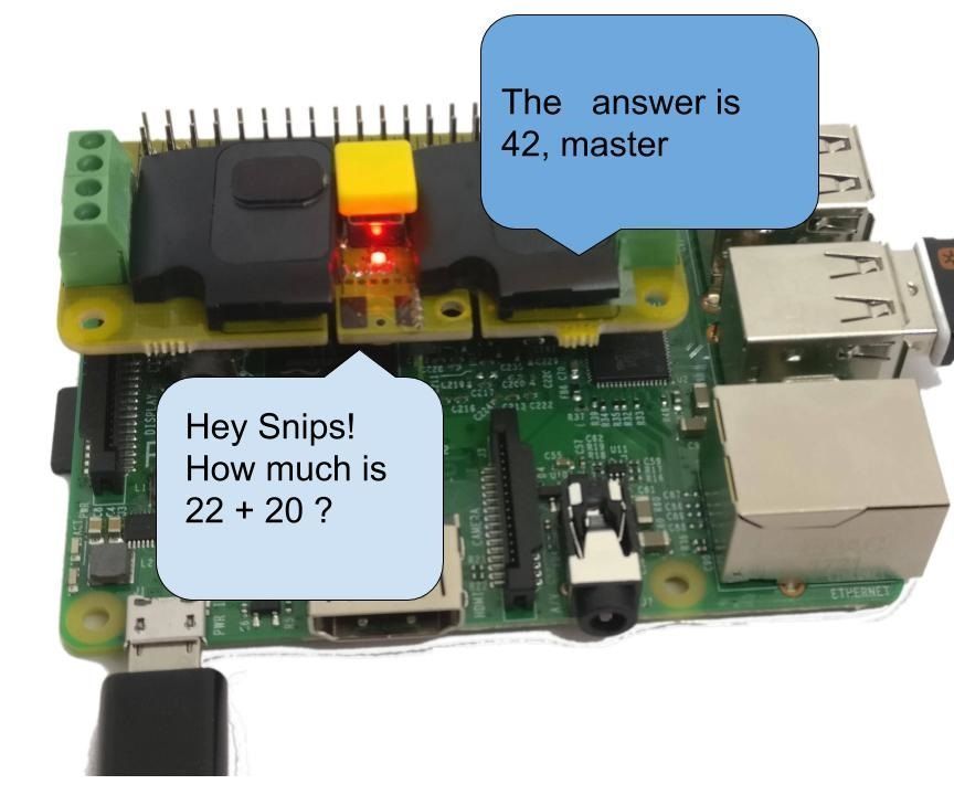

- Take the MIC+ sound card and separate the microphone from the main board
- Use a cutter to weaken the part shown of the picture, give at least 10 passes of the blade above the little holes, then use your finger to apply pressure, try not to push too strongly of the microphone component (metallic rectangle). Then connect the cable as shown in the picture.
- Insert the SD card burnt before
- Put MIC+ on top of the Raspberry PI Zero, and plug it to the USB charger, it will take 2minutes to boot, when ready the led will turn ON:
- Push the yellow button to switch between preset voices, the talk into the microphone, it the Mic is too close you wil have echo, so position the microphone behind the speaker.
