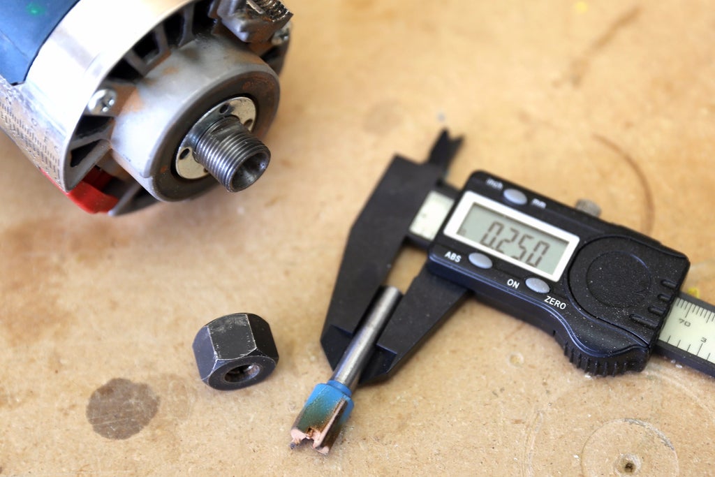

Shank Size
The shank of the router bits that fit into the collet are usually in either 1/4" or 1/2", so know the size of your collet before buying a router bit (or buy a secondary collet so you can switch).
To make things easy on myself, I just stick with one size of router bit shank, but your needs may vary.
