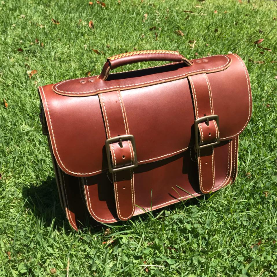

Step 9: Finished
And finally it's all complete. If you measured right and assembled correctly you now have a complete restored/remade/recycled backpack that will go another lifetime or so. Maybe more this time.
If you want more details of this pack or a better pattern to make this exact bag please leave a comment or drop me a message.
