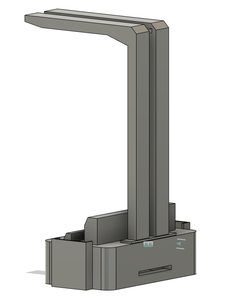

This assembly includes an arm to hold most lightweight headphones, a phone holder that has slits to fit a charging cable, and a place to store any extra length of wires and other objects.

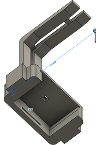

Download the attached STL files and process it through your 3D printer's program. If you have a bigger printer, I recommend that you try to orient it differently to find the lowest amount of filament usage.
The program we used, MakerBot Print, in the screenshot above displays the base. There are a ton of supports because of the phone holder. After the program ran a simulation of the printing process, we were able to export the base as a .makerbot file and then load it into our printer.

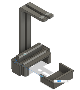

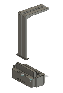

Step 3: Assemble
Assemble the base together by plugging in the headphone holder arm into the base piece's slits near the back and slide the tray into the open area.
If the arm is unstable or wobbles when inserted, then I recommend you use construction or hot glue to keep it in place. Or if either the tray or arm is too big to be inserted, we suggest sanding it down.

Using the wide slit located in the rear wall, you can route a cable into the tray area and up the hole in the phone holder. You may need to take out the tray to route the cable. Using the tray room, you can store any extra cable length, USBs, and other small items.
At this point, the headphone holder is finished. I hope you enjoyed making this product!
