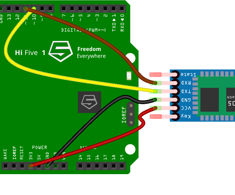

Step 2: Connect ESP-01 Module to HiFive1 Board
Connect the ESP-01 module to the HiFive1 board as shown in the Fritzing Schematics and Breadboard views.
Make sure that IOREF jumper is set to 3.3V as shown in the picture by the red circle.
