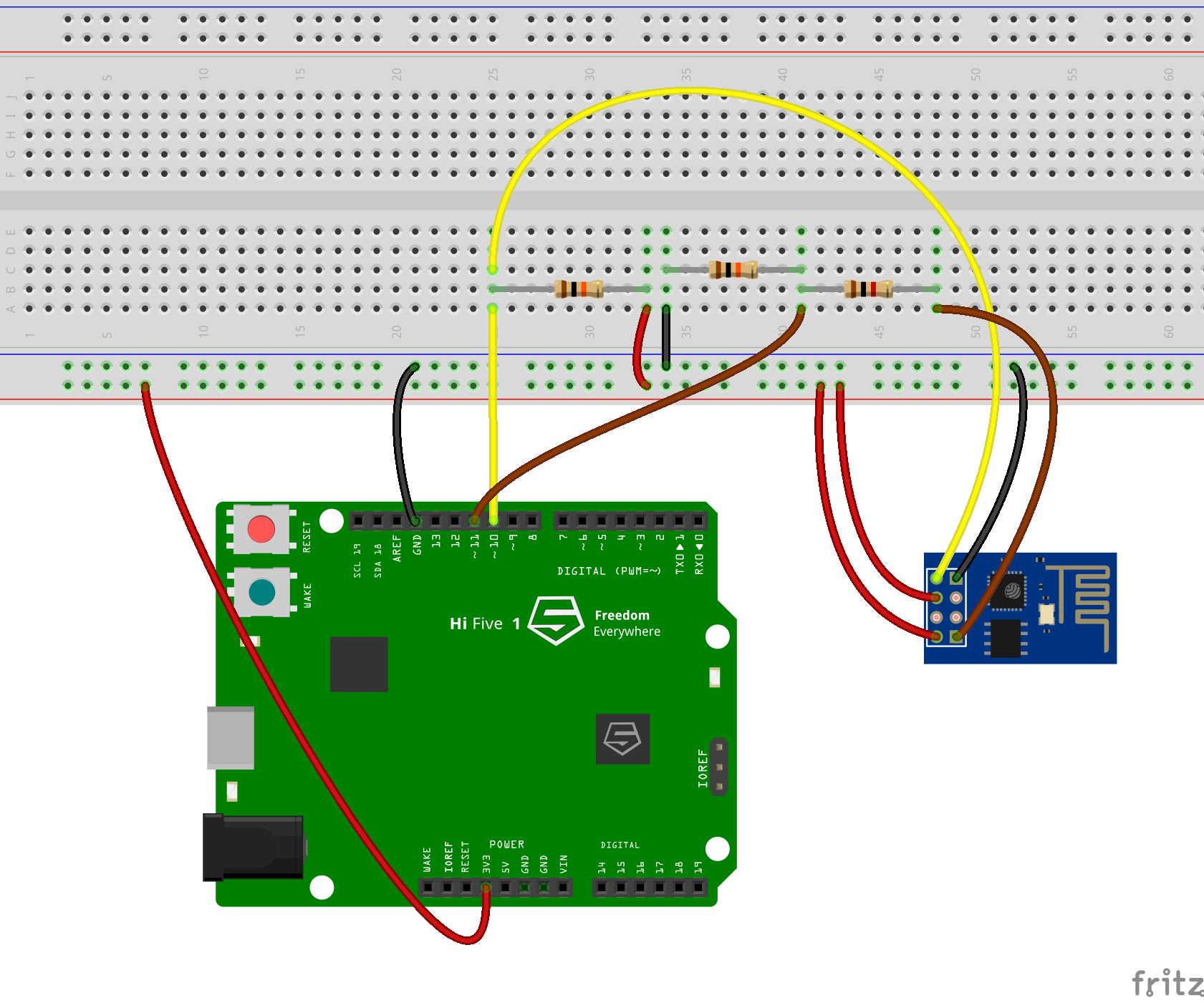

Step 2: Wiring the ESP32
If you are using an ESP8266 skip to step 3.
Connect the jumper wires in the following way:
  • GPIO 10 (HiFive1) - > Tx (ESP32)
  • GPIO 11 (HiFive1) - > Rx (ESP32)
Make sure that the IOREF jumper is set to 3.3v.
Step 3: Wiring the ESP8266
  • GPIO 10(HiFive1) - > Tx (ESP8266)
  • GPIO 11(HiFive1) - > Rx (ESP8266)
