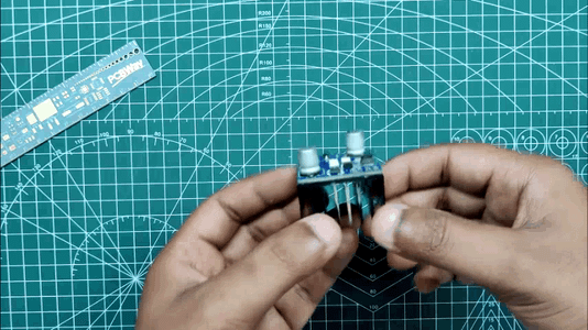

SIC9301A LED Drive IC is used in this build, it's an LED Driver IC that is rated up to 10W of power and we can easily control or set the output power of the LED by changing the value of resistors on the board.
Step 2: Schematic
Here's the schematic that we have used and it's a simple one.
We connect four XPLAWT LEDs in series, each LED requires 2.8V min so four in series would at least require 11.2V for operation.
These LEDs are connected with the SIC9301 LED Driver output side, SIC9301 is configured according to its datasheet layout.

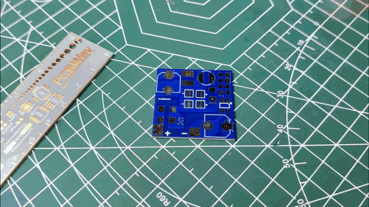

Step 3: PCB Design
After completing the Schematic, we export the netlist and convert the schematic into a board file.
I prepared a 34x34 outline and place the LEDs at the center of the board.
Because this was an LED Driver board, it was wiser to use wide shape tracks instead of using regular 1mm tracks.
Also, to make this setup easy to build, I use all SMD components in this build, from capacitors to inductors all are surface mount devices.

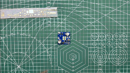

Step 4: PCBWAY

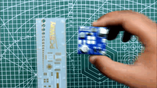

After finalizing the board, I exported the Gerber Data and sent it to PCBWAY for samples.
A Blue solder mask and white silkscreen was used for this project.
I received PCBs in a week and the PCBs were nice as expected.
I really like the quality of the Blue solder mask, PCBWAY did an excellent job of manufacturing this PCB with no error whatsoever.

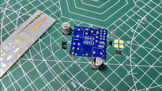

Step 5: Solderpaste Dispensing Process
We apply solder paste with a solder paste dispenser syringe or the proper method is to use stencil here which I don't have. but anyway, after this, we can now move on to the next process, which is to add components to each pad.
Step 6: Pick and Place Process
Next, we carefully pick all the components with an ESD tweezer and place them in their assigned place one by one.
  • We start first by placing Capacitors, Diodes, and resistors.
  • Next, we add LEDs in their place, we make sure to place LEDs in the right position.

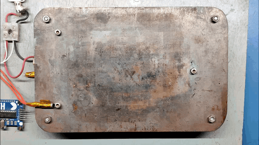

Step 7: Hotplate Reflow Process
Then after doing the pick and place process, we carefully lifted the whole PCB and place it on the hotplate. I’m using my good old DIY hotplate which I made a few months ago.
Basically, in this hotplate reflow process, the surface heats up to the solder paste melting temp and it slowly melts. after a few mins when the solder paste completely melts, we remove the PCB and let it cool down for a moment.

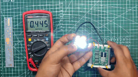

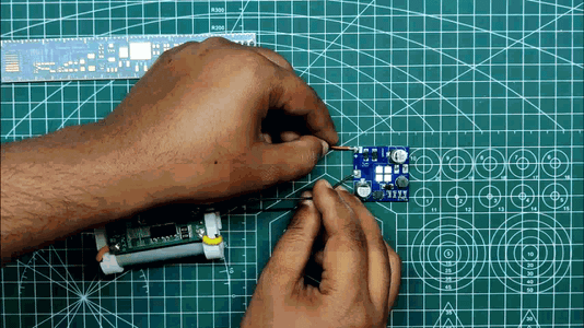

Step 8: Testing

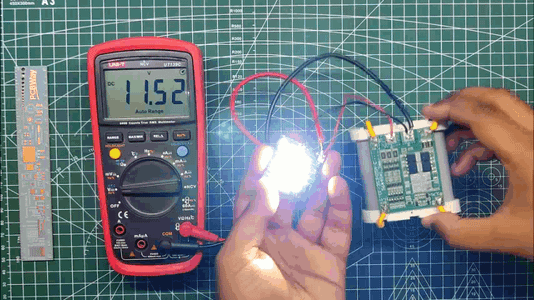

We connect a 12V battery source with the LED Board in order to test the setup by measuring its voltage across the input side and the current drawn by the LED Board.
For Measuring the Current, I set up a multimeter in current mode and connected the probes in series with the LED Board.
For Measuring Voltage, we connect probes of the multimeter with the input side of the LED Board, observed voltage is 11.52V.
Current is fluctuating and can be seen increasing, it started at 0.445A but increased up to 0.470A as time progresses.
This is happening because of the LED Drover, To keep driving LED at constant power, Voltage gets decreased and current increases this causes stable power output that is maintained for a duration of time until the battery run out of JUICE.
The power of this whole LED Board is 11.52V x 0.470A which is - 5.4W.
Similarly, we can calculate the output power by measuring LED Current and LED Voltage and then calculate efficiency by dividing Input Power by output power.

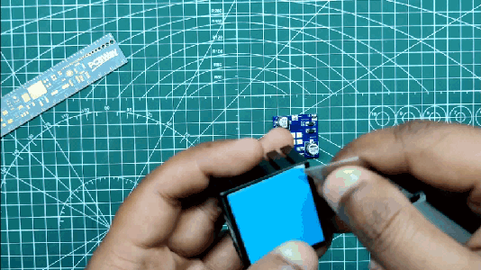

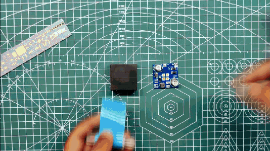

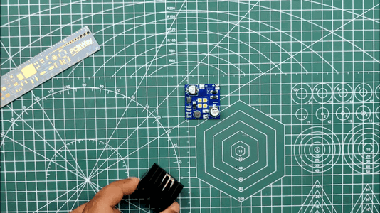

Step 9: Adding Heatsink
After testing the board, we add a heatsink with this board for dissipating heat and making this setup optimal to use, after all, it's a 6W LED Board that obviously generates heat because of the HIGH Power LED it uses.
  • We start by first placing the Double-sided thermal Tape on the heatsink and then removing its top cover.
  • Next, we place LED Board on the heatsink and press the board evenly onto the heatsink so the tape will hold the board in its place.

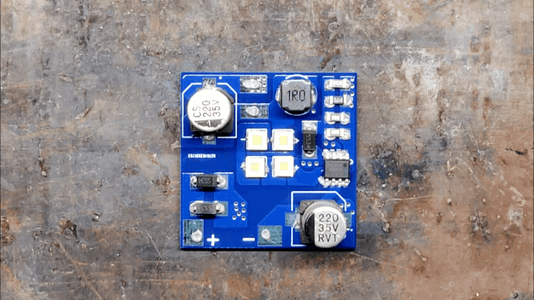

Step 10: RESULT
Here's the result of this small built, working HIGH-Intensity LED Board that operates at a power of 6W and is super bright.
