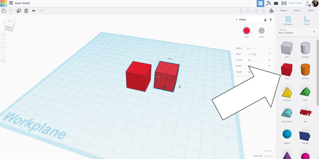

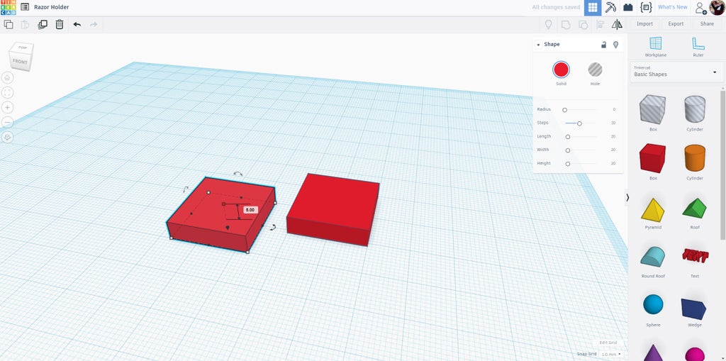

I started by dragging 2 boxes from the shapes toolbar onto the workplane.
![](https://content.instructables.com/FVC/A4P6/JEOIM6AK/FVCA4P6JEOIM6AK.jpg?auto=webp&fit=bounds&frame=1&height=1024&width=1024)
Clicking on one of the boxes I grabbed the white handle on the top of the shape and pulled it downwards to squish the box flat, making it 5mm thick. Then I did the same to the other box.

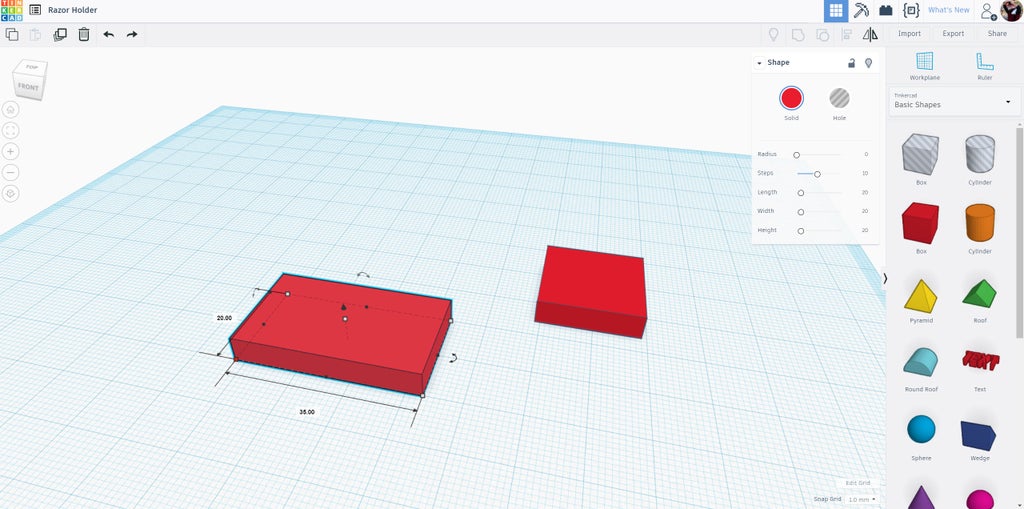

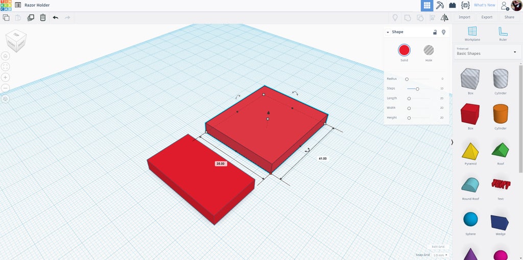

Using the measurements as a guide, I made one of the boxes 35mmx40mm and the other 35mmx20mm.
![](https://content.instructables.com/FUM/826I/JEOIM6D1/FUM826IJEOIM6D1.jpg?auto=webp&fit=bounds&frame=1&height=1024&width=1024)
The two sides that were 35mm were aligned next to each other, lining them up so they will mate when the top piece is rotated into place.

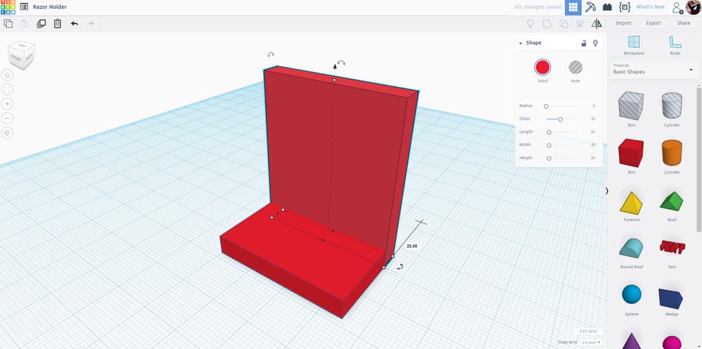

Click on the larger box and navigate to the rotational arrows on the perimeter of the shape on the workplane.
![](https://content.instructables.com/FNR/P15T/JEOIM6E6/FNRP15TJEOIM6E6.jpg?auto=webp&fit=bounds&frame=1&height=1024&width=1024)
The rotation command is active once the mouse is clicked on the arrow axis you want to rotate around. Holding the mouse button you'll notice a compass appears showing you the angle in degrees the shape has rotated. Rotate the shape until it's 90° to the workplane and forms an L-shape with the bottom shape.

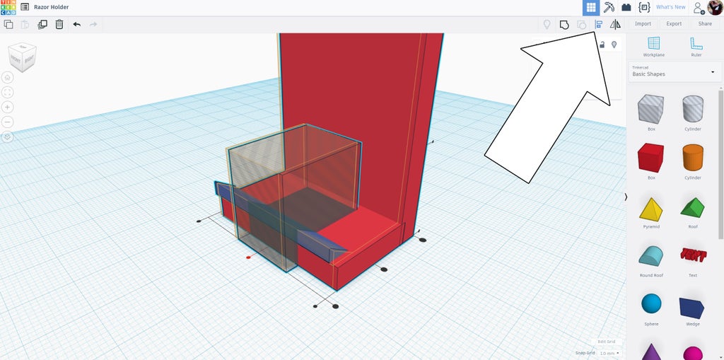

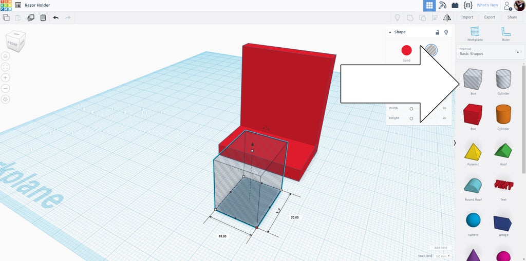

Drag a new negative box shape from the shape panel on the right side of the screen.
![](https://content.instructables.com/F35/MTKP/JEOIM6FU/F35MTKPJEOIM6FU.jpg?auto=webp&fit=bounds&frame=1&height=1024&width=1024)

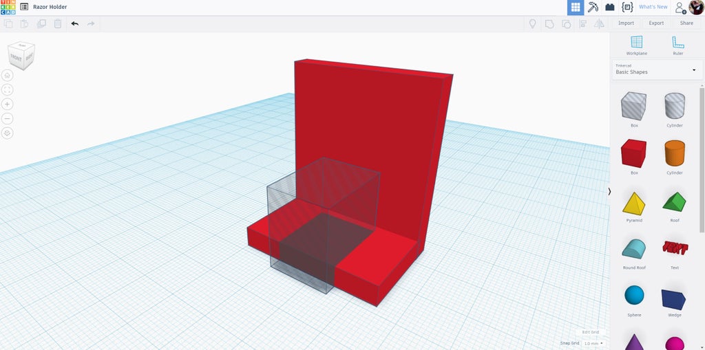

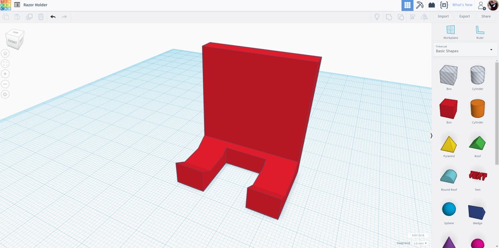

Click on the handles of the negative box shape to input the dimensions. Using the measurements as a reference I made this shape 15mm wide and 20mm deep. Select all the shapes by dragging a window around them, then click the align tool from the top toolbar to alight the shapes.
![](https://content.instructables.com/F56/VQDR/JEOIM6GU/F56VQDRJEOIM6GU.jpg?auto=webp&fit=bounds&frame=1&height=1024&width=1024)
Move the negative shape into the base, holding shift as you move it will constrain the shape to only move along one axis and not all over the place.
I placed the block so it almost touches the vertical box. This negative space will be where the razor is placed.

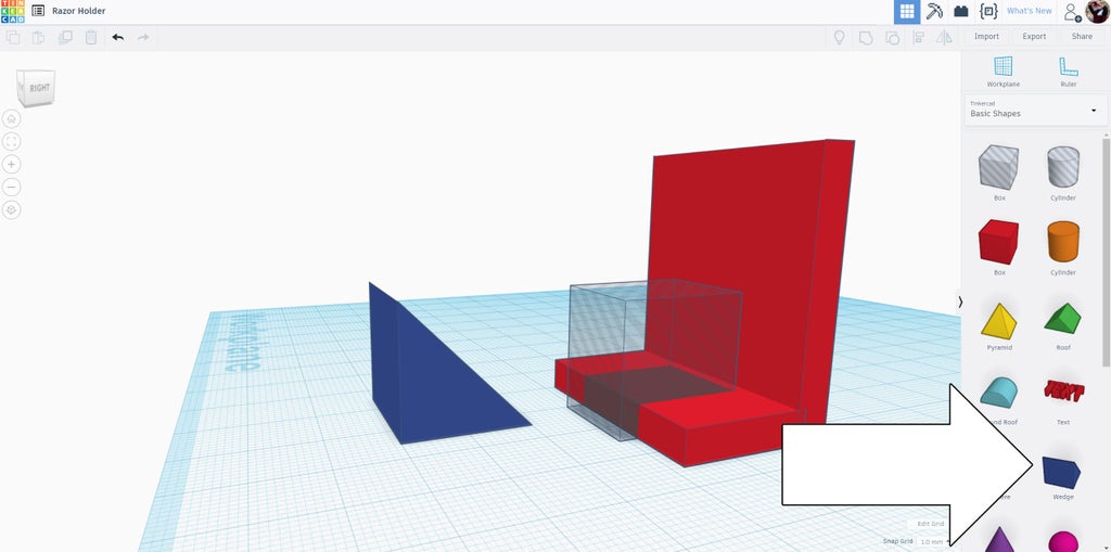

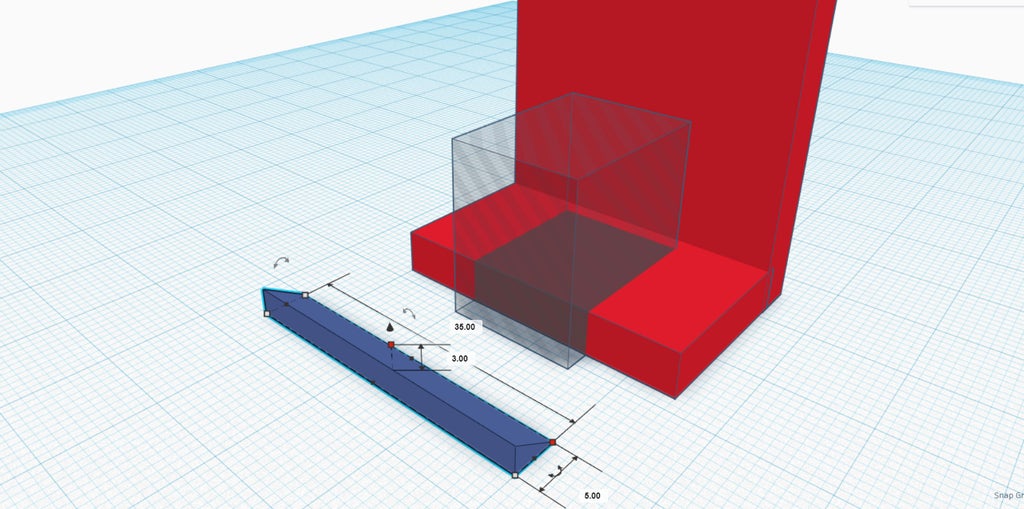

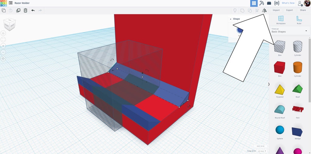

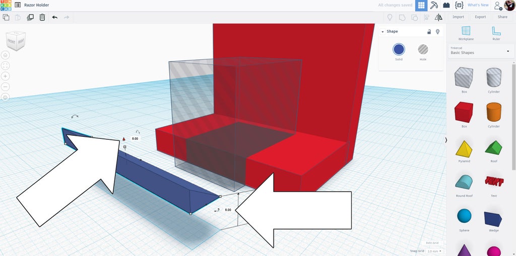

To prevent the razor from slipping off the holder I added a lip to the end of the shelf that holds the razor. I grabbed the wedge shape from the shape toolbar and dropped it onto the workplane.
![](https://content.instructables.com/FIP/GPM7/JEOIM6H8/FIPGPM7JEOIM6H8.jpg?auto=webp&fit=bounds&frame=1&height=1024&width=1024)
The wedge shape was stretched to the same width as the shelf, 35mm. I then tweaked the height and depth until it looked right, that ended up being 3mm tall and 5mm deep.
![](https://content.instructables.com/FFY/9VFH/JEOIM6HJ/FFY9VFHJEOIM6HJ.jpg?auto=webp&fit=bounds&frame=1&height=1024&width=1024)
The lip needs to be raised to sit on top of the shelf. Select the long wedge lip and find the arrow above the shape to drag the shape upwards off the workplane. The shelf is 5mm thick, so the lip was raised that amount.
![](https://content.instructables.com/F3C/PWY7/JEOIM6IH/F3CPWY7JEOIM6IH.jpg?auto=webp&fit=bounds&frame=1&height=1024&width=1024)
To keep everything neat I selected all the shapes and used the align tool to keep them in the same axis. The lip was then dragged with the shift key to sit on the front edge of the shelf.

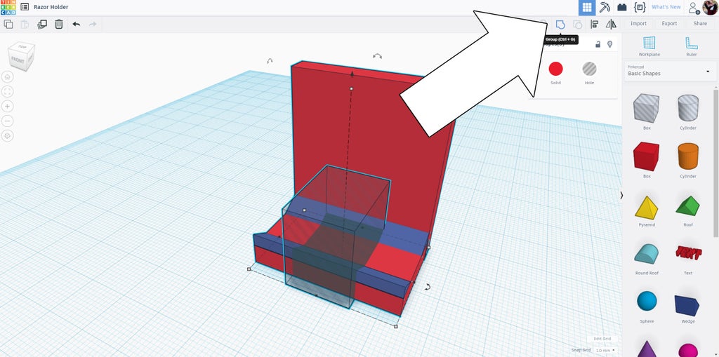

Once all the shapes are lined up and in the right place it's time to group them together and make one shape. Select all the shapes then hit the group tool from the top toolbar.
![](https://content.instructables.com/FLZ/GEG1/JEOIM6LC/FLZGEG1JEOIM6LC.jpg?auto=webp&fit=bounds&frame=1&height=1024&width=1024)
This is what my shape looked like, with the negative space in the middle where the razor will sit.

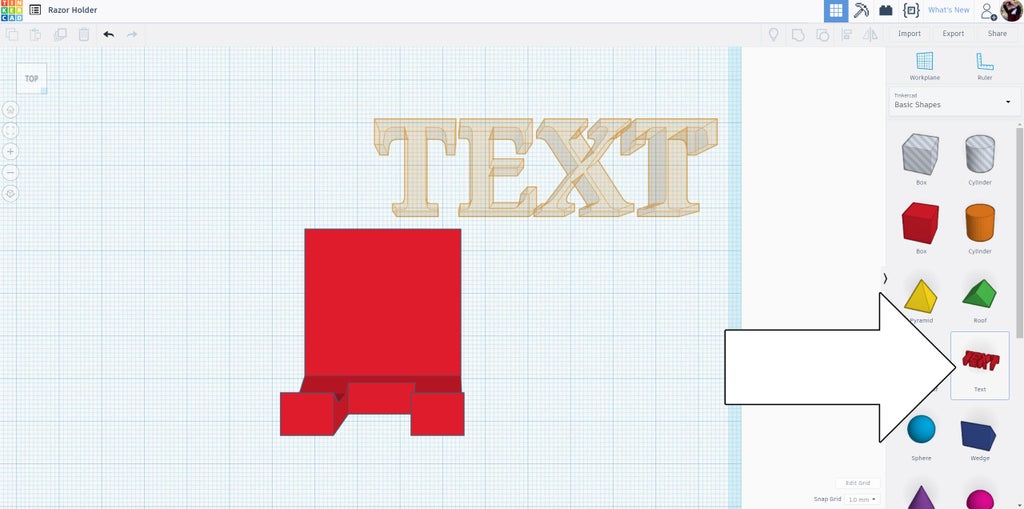

Select the holder shape and rotate so it lies with the long backing on the workplane. This will not only make it easy to place the text, but it will need to be in this orientation for printing.
![](https://content.instructables.com/FG2/4B1E/JEOIM6LR/FG24B1EJEOIM6LR.jpg?auto=webp&fit=bounds&frame=1&height=1024&width=1024)
Find the text icon in the shapes toolbar and drag it onto the workplane.

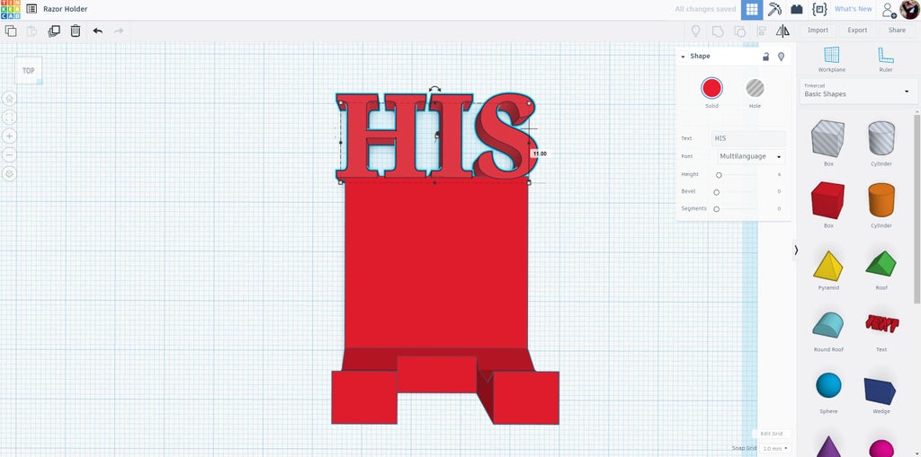

![](https://content.instructables.com/F9V/W9UZ/JEOIM6MU/F9VW9UZJEOIM6MU.jpg?auto=webp&fit=bounds&frame=1&height=1024&width=1024)
With the text shape clicked a new window pops up which will allow us to define the text and size. To let the letters pop a little more I made them 1mm thicker than the backing, 6mm.
![](https://content.instructables.com/FWI/JC1A/JEOIM6NF/FWIJC1AJEOIM6NF.jpg?auto=webp&fit=bounds&frame=1&height=1024&width=1024)
The letters were placed on the top of the holder, using the align tool to keep things tidy.

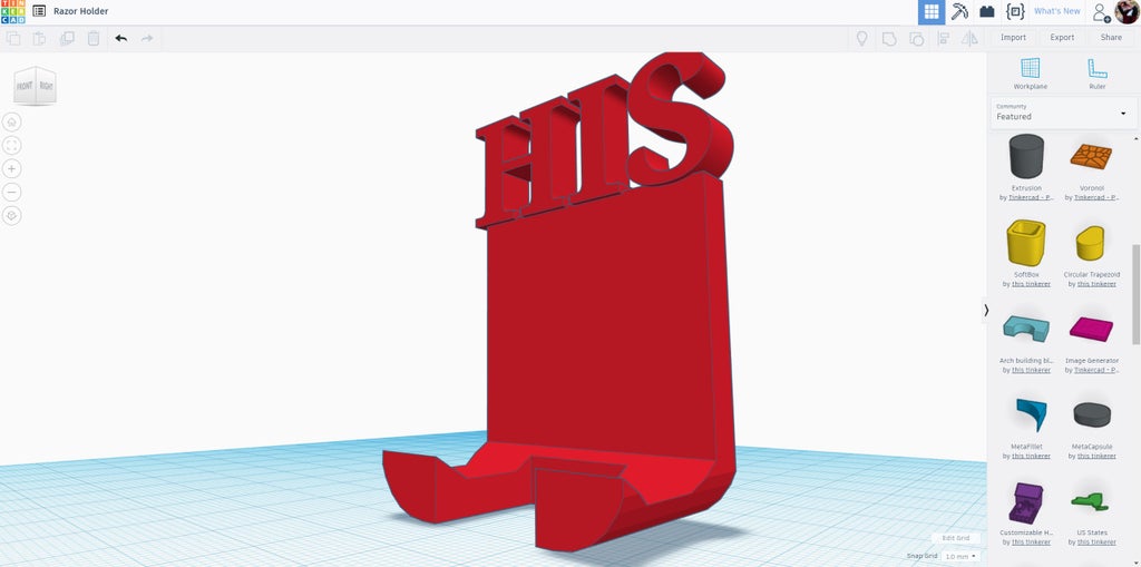

Tinkercad doesn't have the ability to round over sharp edges, but there's a workaround for that.

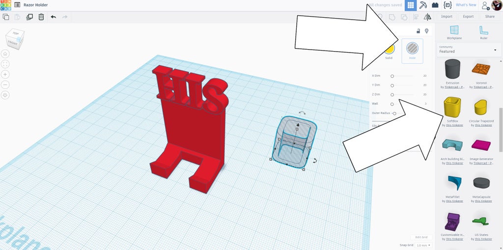

Above the shape menu is a dropdown that you can select featured shapes. Scroll down on this specialized shape list and find softbox. Drag a softbox onto the workplane and make it a negative shape.
Align the softbox with the razor holder. We'll use the rounded inside of the softbox to trim up the sharp edges on the bottom of the razor holder.

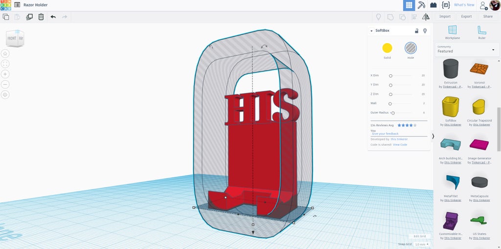

![](https://content.instructables.com/FS6/GTBN/JEOIM6VM/FS6GTBNJEOIM6VM.jpg?auto=webp&fit=bounds&frame=1&height=1024&width=1024)
Use the handles on the softbox to stretch the shape until the inside of the negative shape is overlapping with the sharp bottom of the razor holder. I made sure the softbox was wide enough to not trim up the sides or top, only the bottom.
![](https://content.instructables.com/FPH/BF4D/JEOIM6WS/FPHBF4DJEOIM6WS.jpg?auto=webp&fit=bounds&frame=1&height=1024&width=1024)
Select both shapes and combine to use the negative shape to trim the razor holder.

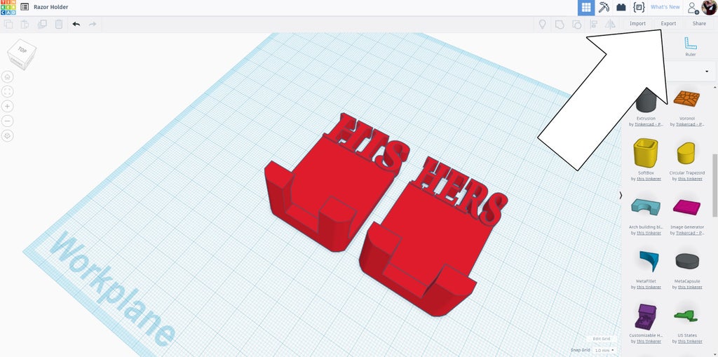

![](https://content.instructables.com/FA5/5FYZ/JEOIM6WX/FA55FYZJEOIM6WX.jpg?auto=webp&fit=bounds&frame=1&height=1024&width=1024)
Select the shapes to print and use the export button in the top toolbar.

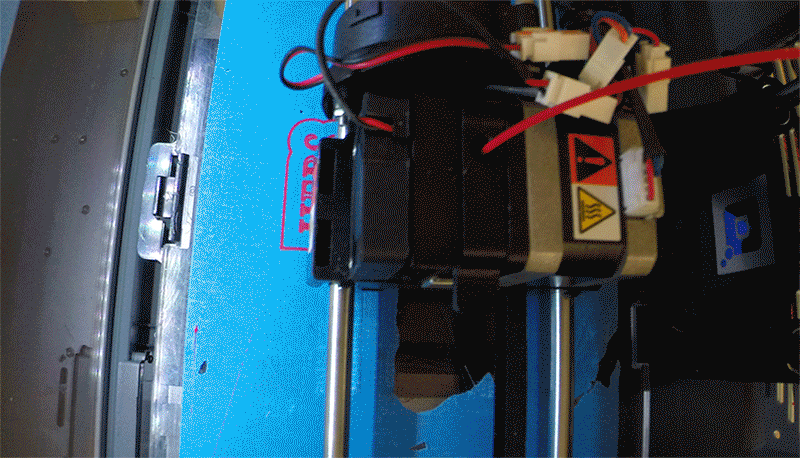

I printed these lying flat and required no support material. It took about 40 minutes.

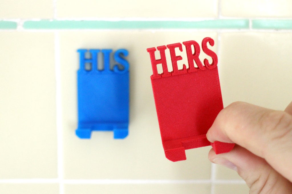

These razor holders are not only functional, but are super fun to see in the shower every morning. The design is large enough to capture both men's and women's razors, and are wide enough to still be used even if we change brands.
