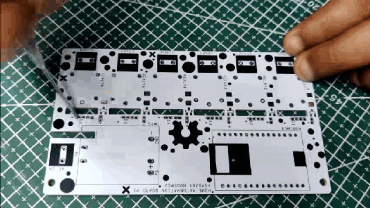

Step 1: PCB Design
PCB The design of this board consists of eight parts, six of which have a relay connected to an N-channel mosfet, whose gate is coupled to the NODEMCU of another section.
A LED is also attached to the relay along with the Mosfet; this LED serves as an indicator and will turn on when the relay is switched.
NODEMCU is located in one portion, and it is connected to six Mosfets and six LED pins.
Then, an isolated 240V AC to 5V DC SMPS is also attached to the board and connected with a screw terminal connector in order to power the entire arrangement with 240V AC. We will connect an AC cord to the SMPS's screw terminal in order to do this.
We prepare the board design and neatly organize all the components in a 120mm x 70mm form factor after the schematic is complete.
For isolation purposes, slots were inserted between the AC pins and the DC components.
A relay with a mosfet as a switch configuration and leds are located on the bottom half of the PCB, which also houses the SMPS on the right side.

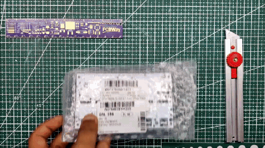

Step 2: PCBWAY Service
After the PCB Design was completed, Gerber data was generated and then sent to PCBWAY for samples.
An order was placed for the PCBs with white soldermask and black silkscreen, as it looks pretty cool in general.
In terms of overall quality, it was outstanding. Each of the 10 boards I bought was flawless.
Really love the quality of PCBs made by PCBWAY. There are other manufacturers available, but their service is always on another level.

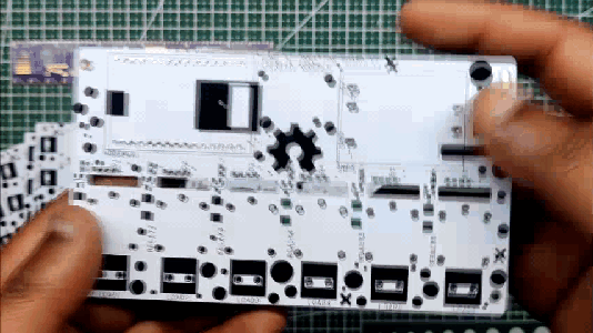

Step 3: Solderpaste and PNP Process
  • Board Assembly Process begins by first adding solder paste to each component pad one by one.
  • Next, using a tweezer, we pick and position each SMD component in its designated location.

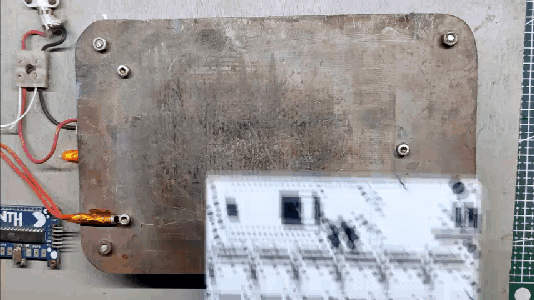

Step 4: Hotplate Reflow
Following that, we carefully lifted the entire circuit board and set it down on the SMT Hotplate, which heats the PCB from below up to the solder paste melting temperature. As soon as the PCB reaches that temperature, the solder paste melts, and all the components are connected to their pads.

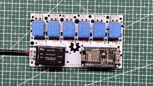

Here is the final result of the board assembly process: a rectangular, soldered Home Automation board with six relays and an SMPS power supply that can be connected to any setup (AC or DC) to make it into a smart controllable load.
Step 7: Adding Nodemcu to the Home AUT Board
The board is complete but is missing one of its most crucial components, which is the NOCEMCU board.
We add NODEMCU in its place through female header pins soldered onboard.

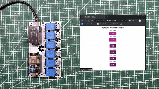

Step 10: Main Sketch
Check out the main sketch, which is attached in the code section.
  • We first edit the SSID and PASSWORD in the sketch
  • next we upload the code into the NODEMCU and open the serial monitor.
  • We then copy the IP Address shown when the ESP gets connected to WiFi and paste the IP Address into any browser.
  • WEB APP will open up which can be used to toggle six outputs.
The web app is completely customized and is made completely from a single sketch without using any third-party tools.
This sketch is a fusion of classic embedded C language and HTML with a little bit of CSS.

Please note that this setup will only work if the ESP8266 and the device that you're browsing the APP on the same network.(LOCAL NETWORK OPERATION)
