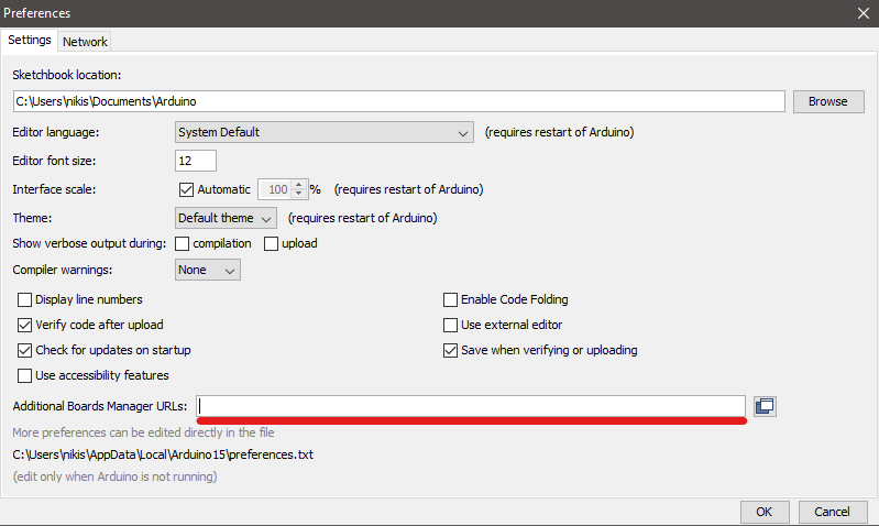

Next, you need to open your Arduino preferences (File>Preferences) and add http://arduino.esp8266.com/stable/package_esp8266com_index.json.

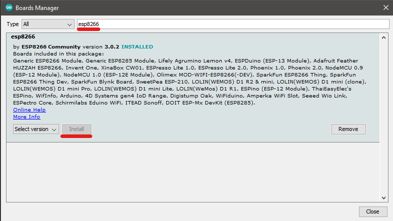

Next, go to Tools>Board>Boards Manager and search for esp8266, then install it.
