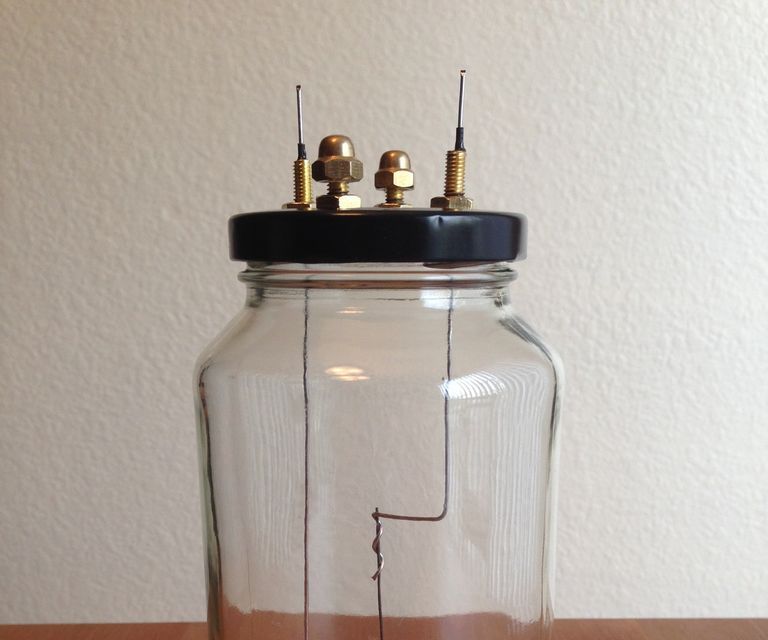

This lightbulb is made entirely out of simple, mostly household materials requiring very little in special equipment. The basic construction includes a glass jar filled with CO2 and a graphite filament(Pencil Lead). This makes it a carbon filament bulb analogous to those made by Edison before tungsten became the norm.

Step 4: The Hangers
Cut two lengths of wire approximately 10" long.
Clamp the wire in the vise grips with about 1.5" sticking out on one side.
Hold the length of piano wire against the vise grips such that it is perpendicular to the wire.
Use the needle-nose pliers to twist the wire around the piano wire.
Repeat for the second hanger.
Note: For my malleable wire I used 19 gauge stainless steel, though any solid core wire of similar gauge should work.
Step 5: The Hangers Cont.
Release the vise-grips and remove the piano wire, there should now be a nice coil to hold the filament.
Take a piece of pencil lead and place it in the coil. It will be quite loose.
Using the needle-nose pliers, gently adjust the coil so that it tightly holds the pencil lead. Only make small adjustments at a time.
Cut any extra length off the end of the coil.
Repeat for the second wire.
Bend the two wires such that they will hold the pencil lead vertically in the center and so the long leads align with the holes in the lid.

Step 7: Attaching Screws
Mix a small amount of JB Weld and apply to the outside of the heat-shrink tubing.
With the head facing down, carefully place the screw over the tubing and JB Weld. The epoxy needs to fill the hole in the screw as this needs to be an airtight seal. Also be sure that the screw is straight on the wire hanger.
Step 8: Mounting on the Lid
Mix a small amount of JB Weld and apply to the underside of the screw head.
Push the screw through the hole in the lid with the head facing down(inside the jar).
Tighten the nut on the opposite side of the lid.
Again be sure the epoxy fills any gap as this needs to be airtight.
Repeat for both vent-screws and hanger-screws.
Let the epoxy fully harden for at least a few hours.
Check for a good seal by tightening the lid on the jar and blowing into one of the vents while holding your finger over the other.

Step 12: First Test
Connect your bulb to a voltage source.
When the bulb is first turned on it will smoke a little as it burns the small amount of oxygen left in the jar. Run it for about 30 seconds and then let it cool and the smoke settle.
12 - 24V should be perfect so long as it can provide a high amount of current. I used two 6V NiMH batteries connecting in series.
Optionally, use a multimeter to measure the resistance of the bulb and with V=IR find out how much current your bulb will pull.
However, as graphite heats up its resistance decreases so the resistance you measure before turning on the bulb will be higher than it will be when on. This is one of the reasons we now use tungsten filaments because tungsten's resistance increases with temperature.
