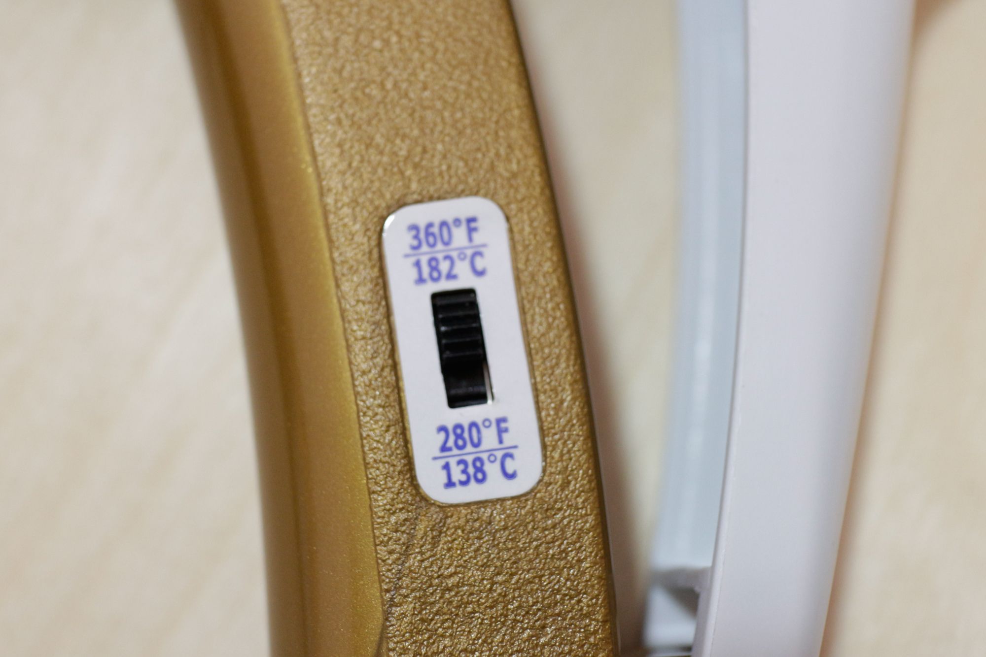

Low-temperature glue sticks melt at around 250°F - this temperature is best suited for applications for fine details, fabric, silk flowers, paper, and generally lightweight materials.
High-temperature glue sticks melt at around 375°F - this temperature is best suited for wood, ceramics, some metals and more heavy-duty materials.
Some glue guns have a potentiometer that allows you to dial in temperatures - this is best for special materials that are either very sensitive to heat (leather, suede, certain fabrics), or very insulating materials (glass, metal, ceramics).

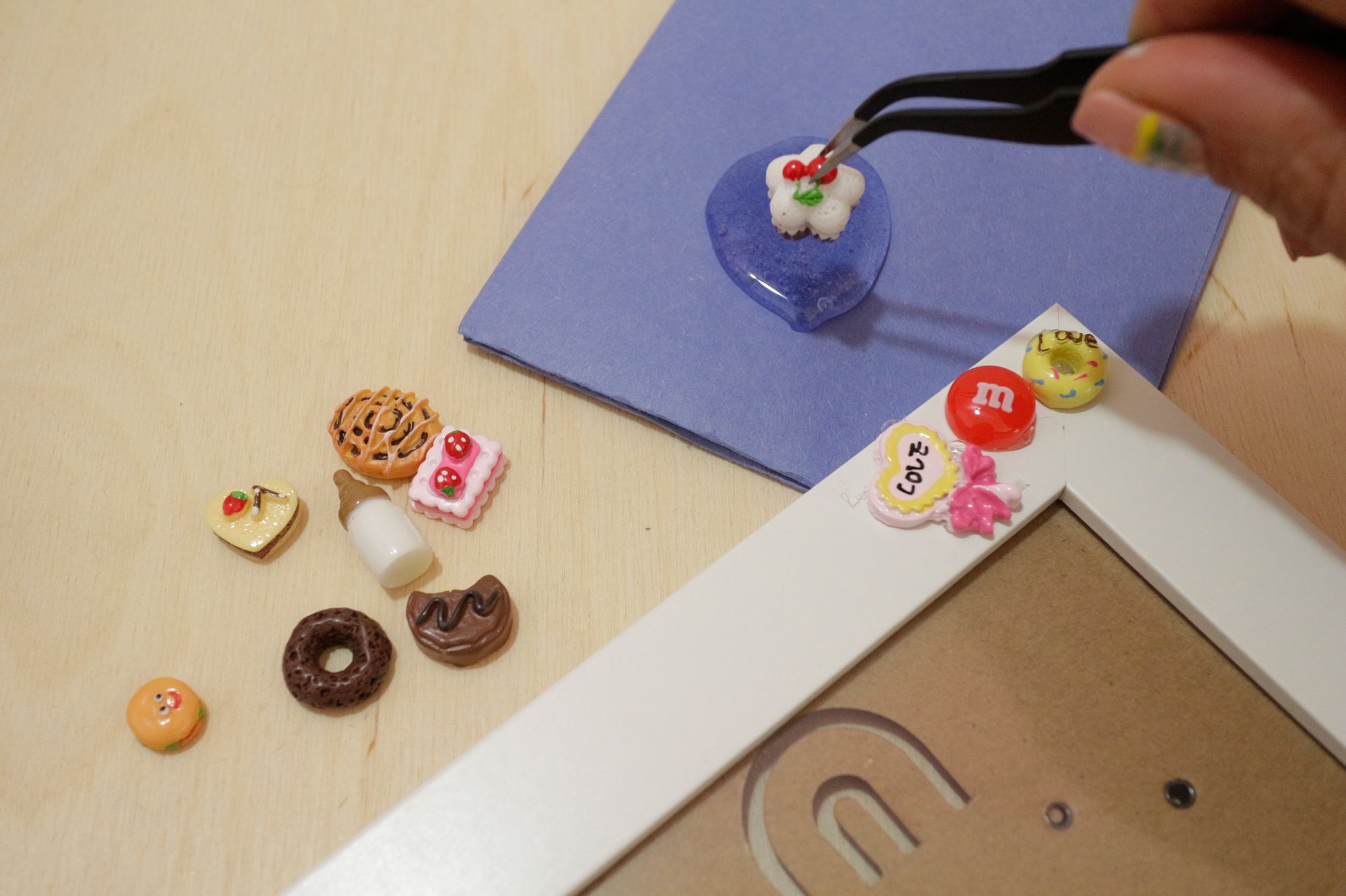

For small parts, try squeezing out a pool of hot glue, then dipping your part into the molten puddle.
If you have A LOT of small parts or items to glue, you can use a hot glue pot to keep a molten pool of glue for parts to be dipped and adhered.

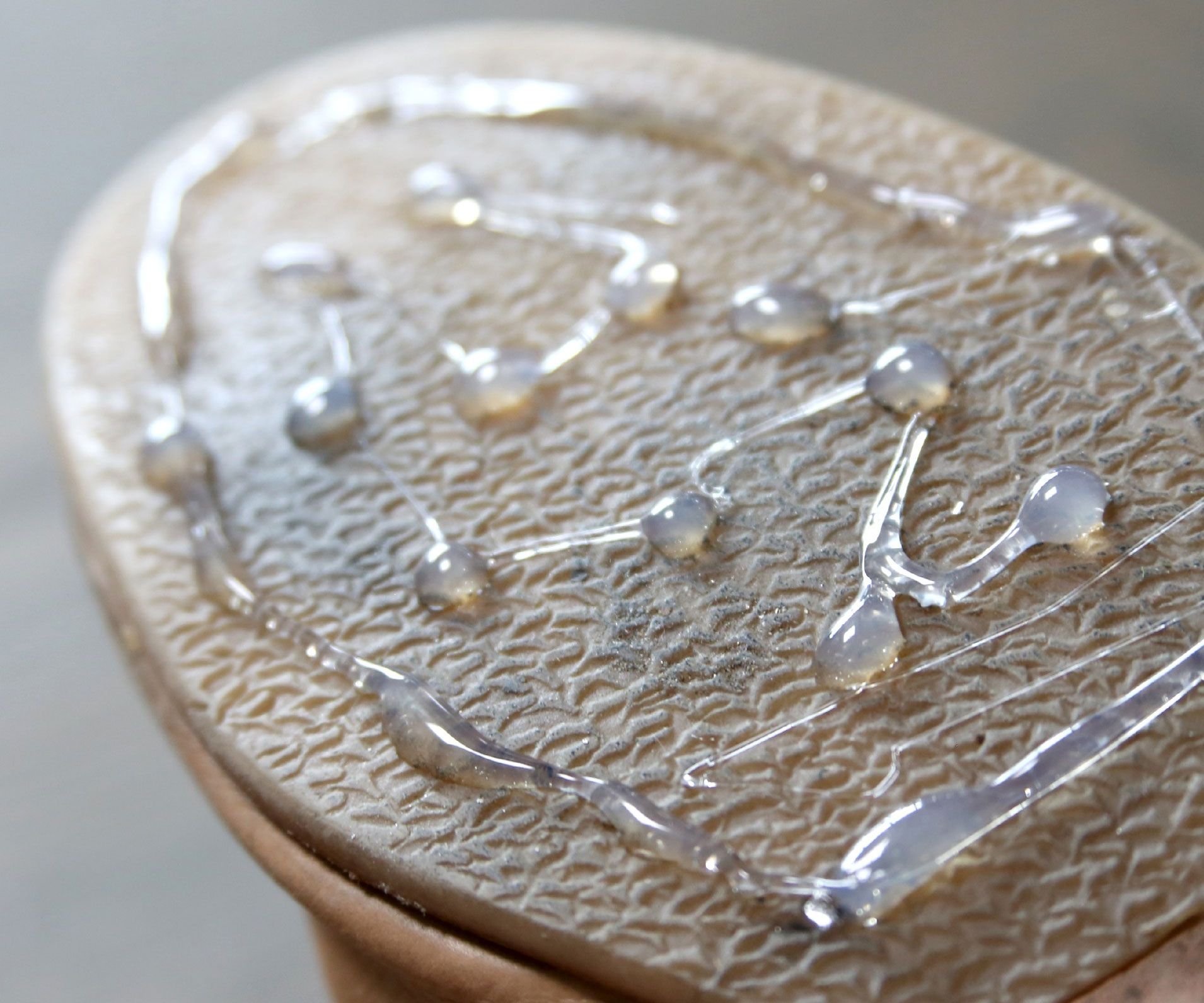

A quick bead glue on the heels of shoes to add a bit of skid resistance in a pinch!

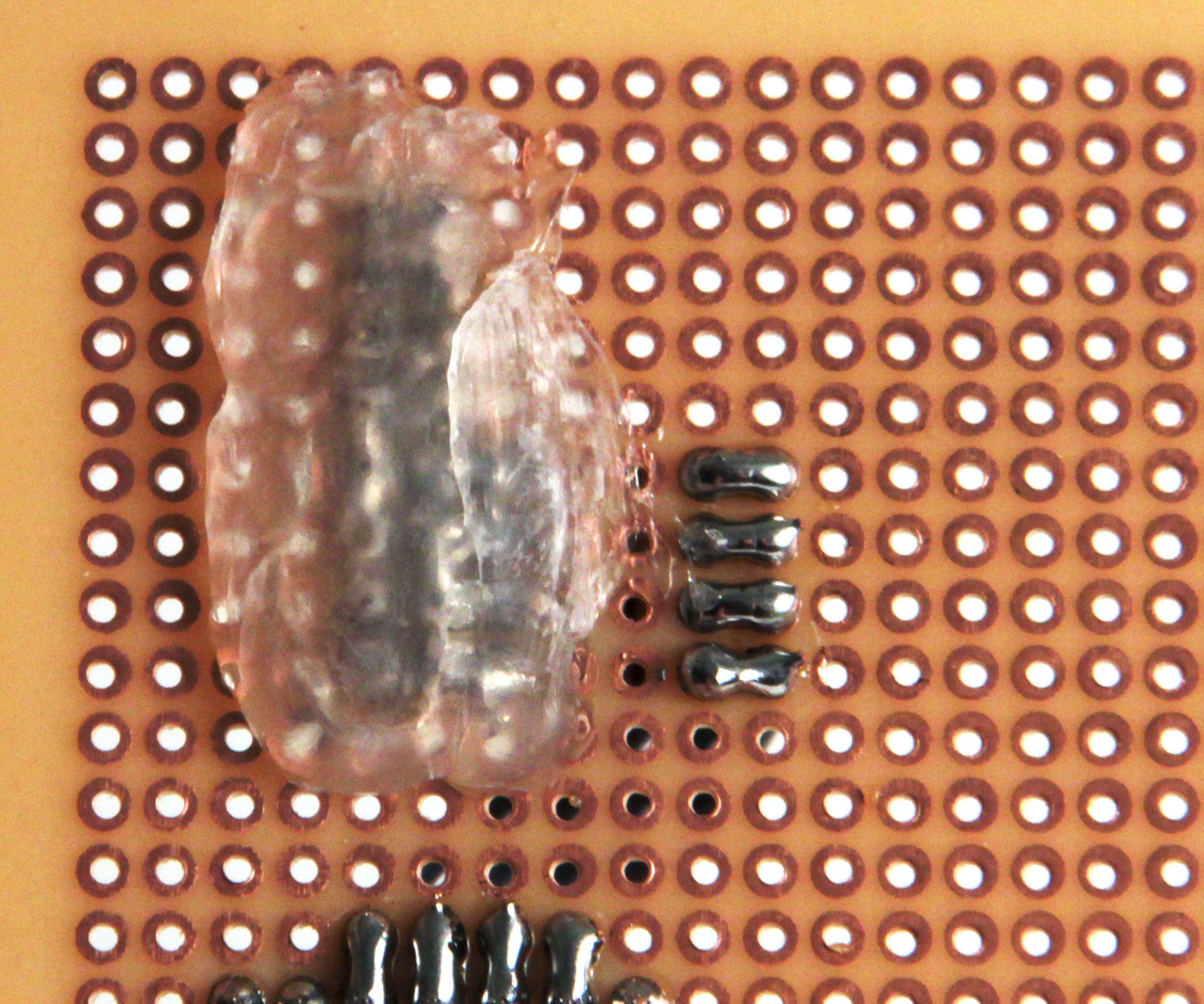

Protect your circuits by slathering component parts with glue (make sure your circuit works first :))

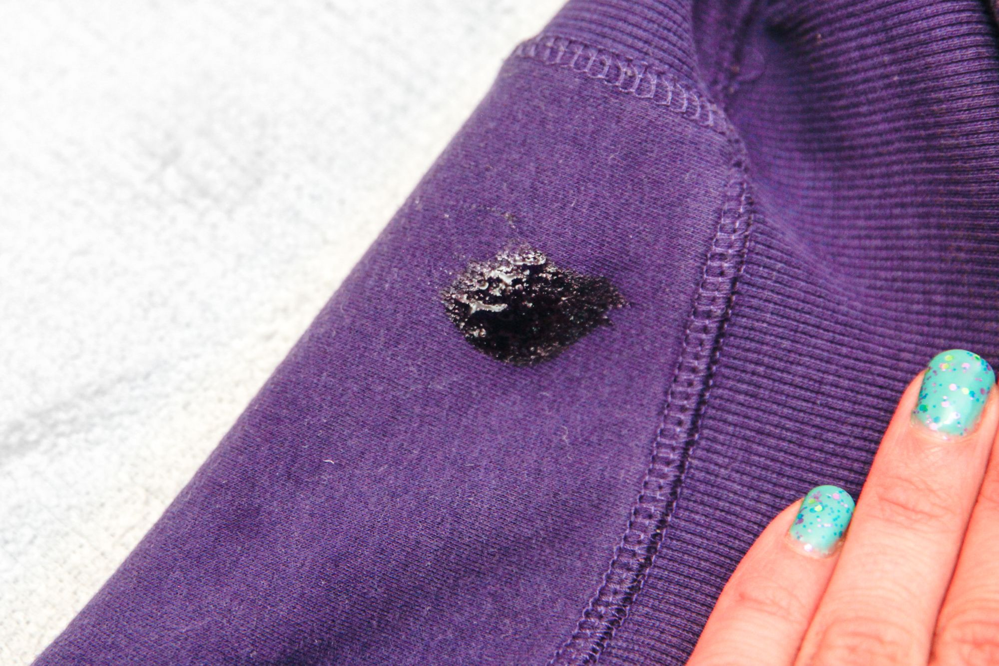

Step 4: How to Remove Hot Glue
If you make an error with nonporous materials like metal or glass, you can usually just wait for the glue to dry, then pull if off and try again.
If, however, you make an error with a porous material like fine fabric, you will need to reheat the glue to remedy the problem.
To remove glue from fabric, you will need:
  • Iron
  • Sacrificial cotton cloth

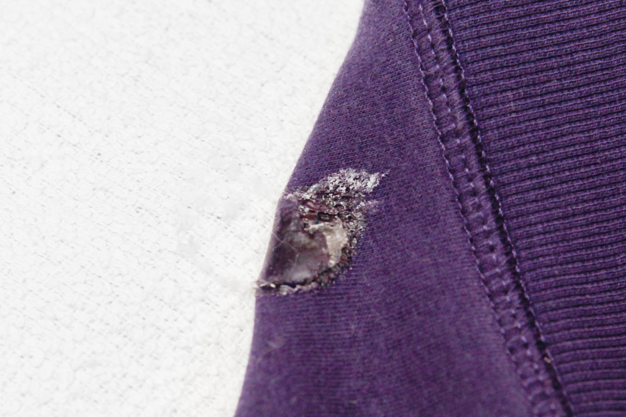

Find a scrap piece of cotton fabric and lay it flat on an ironing board. Shop towels work perfectly.
Lay the stained clothing, glue side down, on top of the sacrificial fabric. Apply a hot iron with no steam for 10-20 seconds, and moderate pressure. Remove the iron and carefully peel the clothing off of the fabric.
You will have to do this a few times, and be sure to move the cloth underneath before you make the next pass, otherwise, the glue will be reabsorbed into the garment.
After the first pass of the iron.

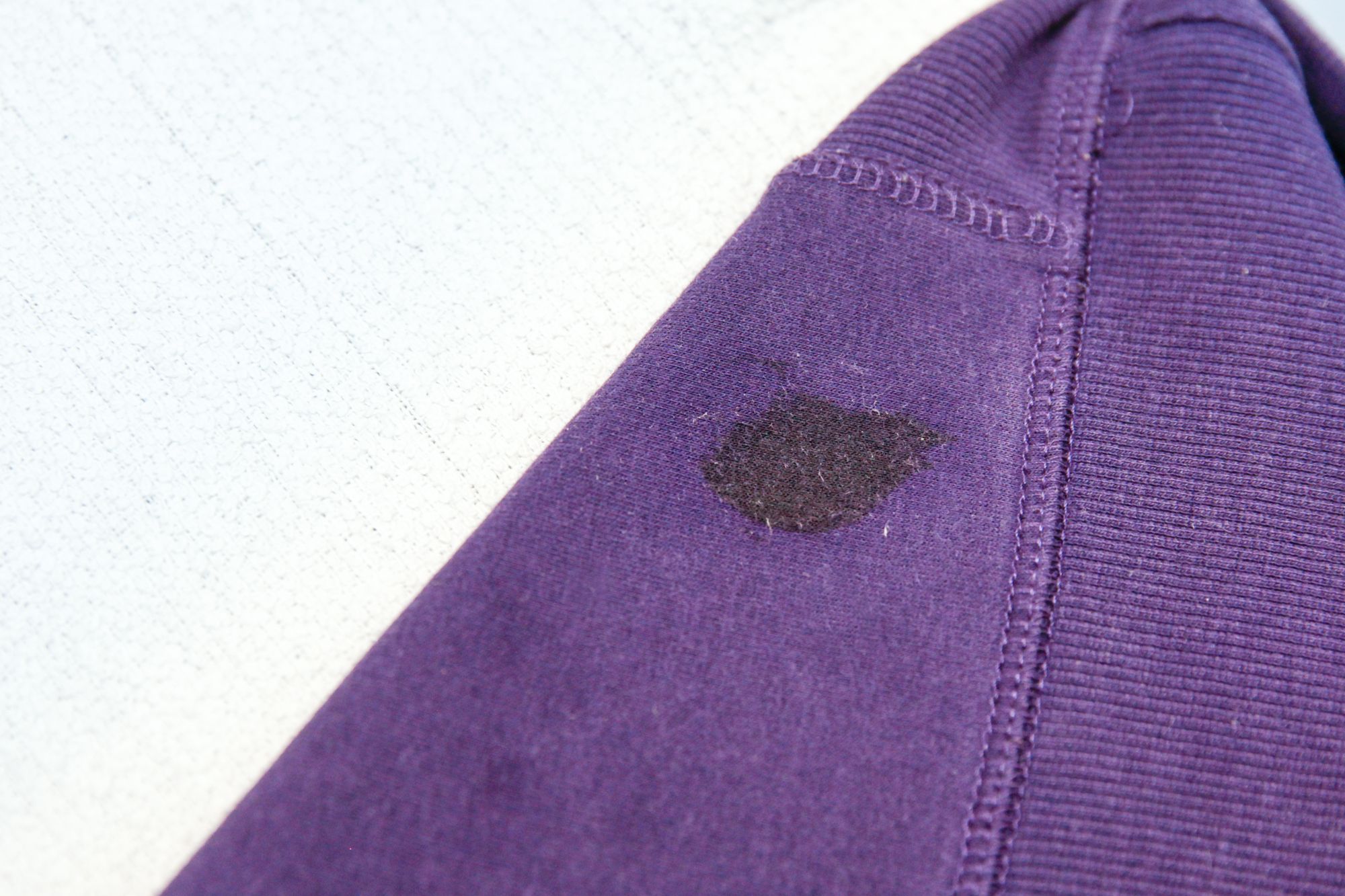

After the second pass of the iron.
Continue until all of the glue is transferred off of the clothing and onto the cotton piece. There may be some residue left behind, but I've noticed that it kind of washes out over time.
