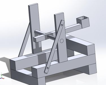

Step 2: Make Assembly on Solid Works
Once we knew what we were going to do, we started by sketching each part of the catapult, we had to consider every measurement and take care of the assembly.

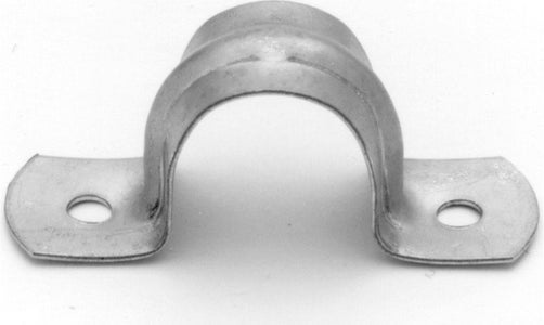

After we bought all the required materials, we took measurements of the wood bars, and we cut four of them to measure 48 cm, once we cut it we sanded each one, and after that, we put them together using screws, making a square shape because it was going to be our catapult base, once we have done that, we cut the other bar of 4x2 to 45 cm, they would be the arms of our catapult so we put two of them parallel to each one but in a vertical form and we assembly it by using the square union and putting the screws, at the same time we were printing our 3d pice which was our basket for the tennis ball. But before we made a 2 cm hole in each arm, we needed to put an axis where our main arm could spin, so we added a stick.
