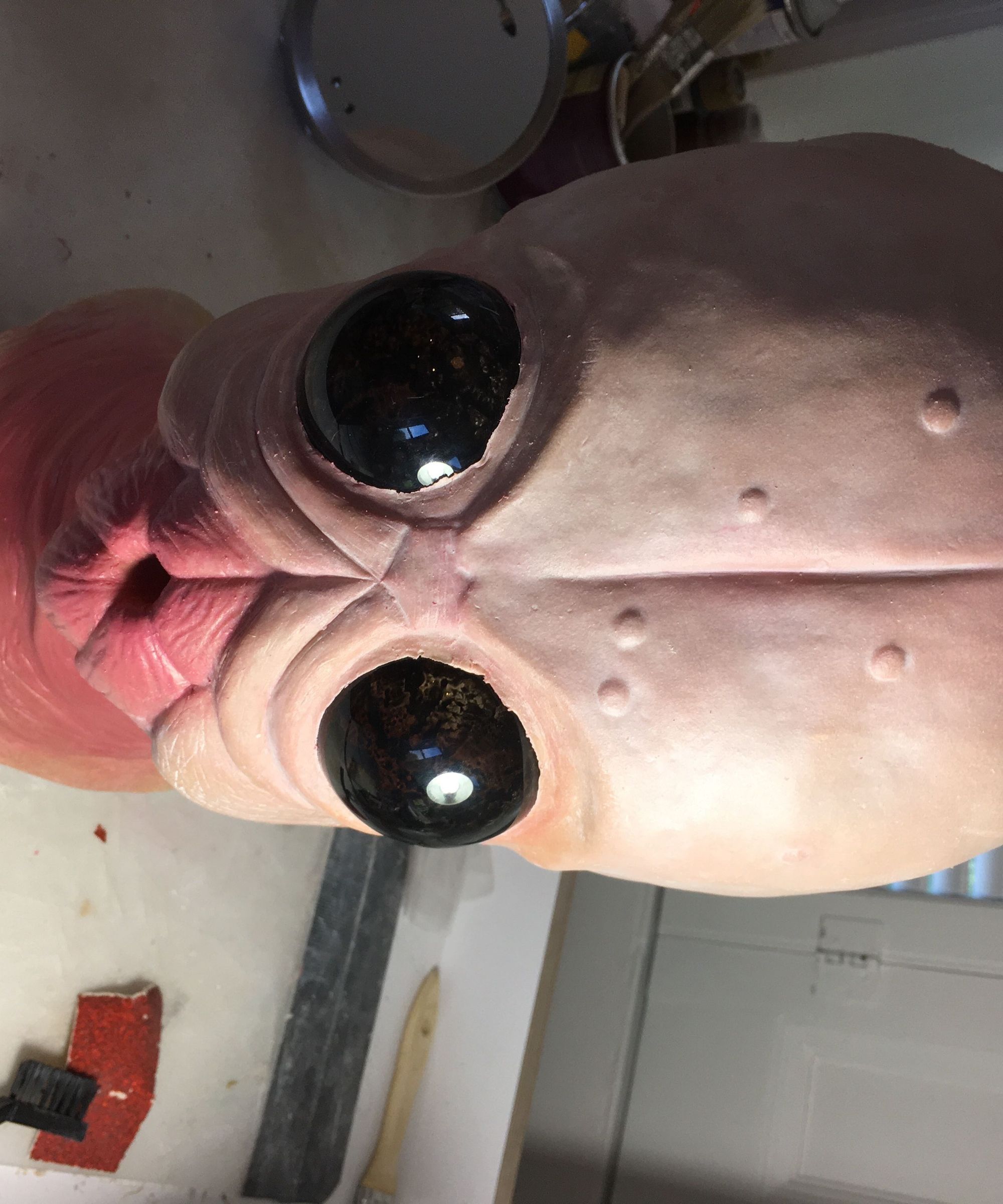

Step 5: The Epic Mask
This was by far the hardest part of the costume
Step One: sculpt the mask on a styrofoam head
Step Two: then you need to make a 2-part plaster mold of it. watch this video to see how
Step Three: paint 1 layer of latex to the inside of the mold and let it dry and another layer and another layer until it reaches your desired thickness
Step Four: pull the mask out of the mold slowly while powdering it with baby powder
Step Five: with scissors cut out the eye hole and Breathing holes
Step Six: paint the entire mask white with a 1 to 1 mixture of liquid latex and white latex paint and paint the details with black face paint
Step Seven: make a robotic eye from LED's and craft foam and glue it on
