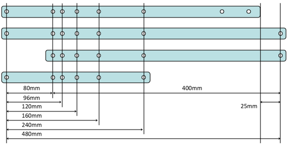

As expressed before I want to build a pantograph that can zoom up to 6 times, and I would like to have the different holes placed at integer values distance. Since the segment AB must be divided into 2, 3, 4, 5 and 6 parts, I calculated the least common multiple of these values and obtained 60. In fact, if I divide 60 by these numbers I get 30, 20, 15, 12 and 10 which are actually integers. This combination is also repeated for multiples of 60.
I opted to build a 480mm pantograph (8 time 60), and using that dimension for arm AB (and AC of course), the hole locations will be 80, 96, 120, 160 and 240mm from point B. Eventually, we will have the dimensions as in the picture.
As you can see the first bar (AC) was cut shorter. This is because I preferred to make the pencil point removable to allow at least two different interchangeable pencil point versions as needed.
First of all I cut the bars according to the measurements indicated and then drilled them with a 5mm bit. I drilled two 4mm holes on the AC bar to fix the pencil point.

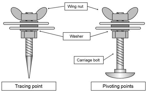

For the tracing point I sharpened a bolt. Be careful not to sharpen the tip too much to avoid tearing the underlying drawing material.

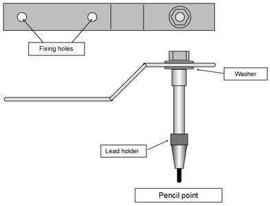

I had an old, unused drawing compass and took it apart to use the lead holder. Obviously I had to secure the support stem with an M4 bolt. This allows it to be screwed to the pantograph structure allowing the lead to be replaced very quickly.
The pivot points are made through the use of carriage bolts. This type of bolt has a completely smooth head and no screwdriver cuts. This allows the pivoting points to slide better on the surface of the underlying drawing material.
For tracing point and pivot points ensure that the wing nut is tight enough, but that the joint remains soft to allow the segments to rotate without loosening. For the pencil point this is not important, as it does not have to rotate.

Unfortunately the tip of the pencil was higher than the other tips and, in order not to increase the height of the articulation points too much which would have made the entire structure more unstable, I filled the difference in height by shaping a piece of aluminium bar.

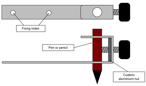

I made also a pen holder by bending the end of a scrap aluminium bar which I drilled with a 9mm bit. Then I made a square aluminium nut that I threaded M5 and lastly added a knob nut to tighten the pencil.
Using two small screws you can easily interchange between the two different types of pencil tips. The height of the entire pantograph can also be adjusted by acting on the nuts of the various pivot points.
