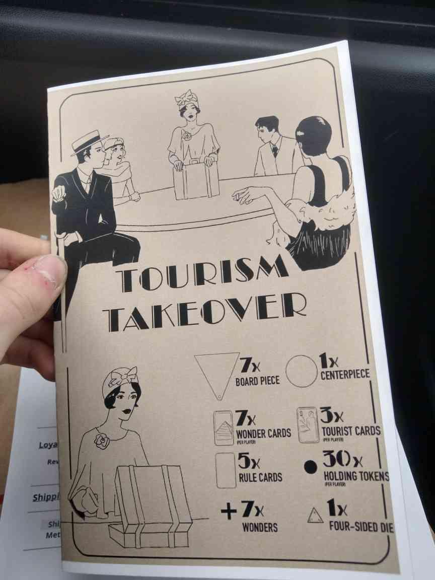

Components:

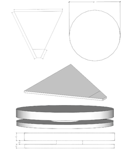

7 piece board + centerpiece
7 wonders
30 holding tokens per player
7 wonder cards per player
3 tourist cards per player
1 four-sided die for a randomized setup
5 rule reminder cards

Assemble the board by sliding the magnetic ends into the centerpiece. Give each player a set of 7 wonder cards and 3 tourist cards. Give each player their 30 holding tokens. Play with 2 more wonders than players. For each wonder, roll the four-sided die and place the corresponding number of wonder pieces on it. After the starting quantities of all wonders in play have been randomized, the game can begin.

Step 3: Board Game Art
I used Procreate and Adobe Illustrator to bring my vision to life. I was inspired by the 1920s time period, specifically the art deco style, which I discovered through researching vintage travel posters and 1920s films. I wanted to capture the grandeur and adventure of that era, so I took inspiration from The Art of the National Parks and used a block color style that would evoke a "larger than life" feeling. I felt that using a style associated with famous tourist attractions would emphasize the tourism component of our game. To differentiate between the wonders, I chose a monochromatic color scheme for the wonder cards and a bichromatic color scheme for the tourist cards to show a more general usage.

I handcrafted the gameboard using black walnut wood for the centerpiece and black cherry wood for the individual boards. I sourced the wood pieces from past projects and milled them to the appropriate thickness. To create the circles on the top and bottom sections of the centerpiece, I used a bandsaw and a custom-made disc sander jig. The centerpiece consists of three sections, with the top and bottom sections both being circles with a 6” diameter and the middle section having a 1¾” diameter. The bottom and middle sections are ¼” thick, while the top section is ½” thick. I inlaid seven magnets into the bottom side of the top piece, which will hold each board piece. I also screwed a lazy susan type mechanism onto the bottom section, allowing the entire board to spin for ease of play. Each of the seven individual boards was cut from a slab of 4/4” black cherry wood that I had resawn in half. After milling them to the proper ¼” thickness, I traced the proper size and angles for the shape of the board pieces before cutting them on the bandsaw and sanding them to the final size. Finally, I inlaid magnets into the ends of each board so that they could properly attach to the centerpiece.

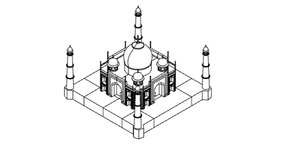

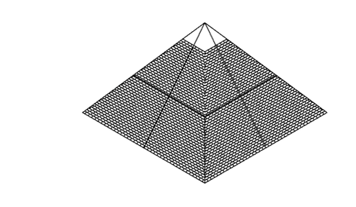

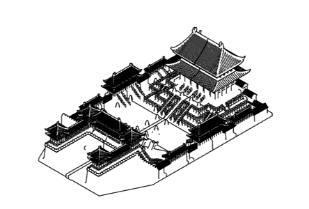

Step 6: Creating the Models
Why did I decide to use 3D models for the game? Having 3D models in a board game can greatly enhance the overall playing experience. The models add a sense of realism and immersion to the game, making the players feel like they are actually interacting with physical objects rather than just abstract concepts. The 3D models can also help players to better visualize the game's setting and theme, making it easier for them to understand the game's mechanics.
Additionally, 3D models can also add a tactile element to the game, making it more engaging for players to physically manipulate the pieces on the board. This can make the game feel more interactive and engaging for players, as they can touch and move the pieces around the board, rather than simply moving tokens or markers, which can be boring. 3D models also make the game more visually appealing, and can attract new players who might not be interested in traditional board games. The physical presence of the models can also make the game more memorable and more fun to play.
Many of the models are 3D scans which were imported into Fusion 360 to be split. 3D scans were chosen to emphasize accuracy. The models are split into 12 unique pieces to fit the game mechanics. When splitting the models, consideration was given to many factors, but above all, I wanted to make the game feel like you are building a wonder. Every section was designed so you are adding something significant. In addition, every model has a flange or two magnets at every joint, which makes it so pieces can only be placed in one orientation. I then 3D printed the pieces on a DLP printer and painted them for added realism. DLP, or Digital Light Processing, is a type of 3D printing technology that uses a digital light projector to cure a liquid resin into a solid object. This allows for faster print speeds compared to other methods of printing, as the entire layer is cured in one go. DLP printers are known for producing parts with high resolution and fine details, making them ideal for small, highly detailed parts and prototypes. This makes it perfect for printing the wonders due to their intricate nature. Overall, 3D models in a board game can greatly enhance the overall playing experience. The models add a sense of realism and immersion to the game, making the players feel like they are actually interacting with physical objects rather than just abstract concepts.
