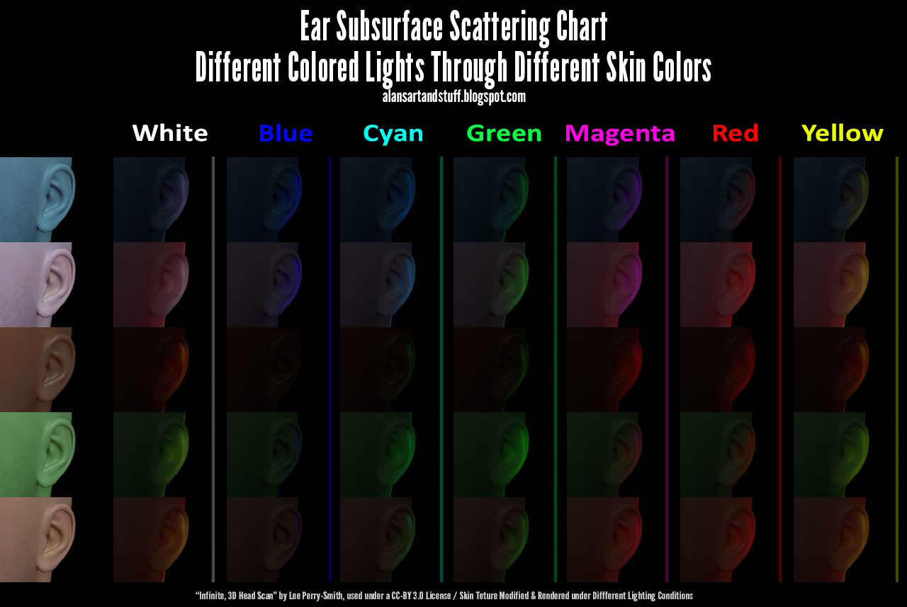

The next video concerns not so much painting the ear but something that tends to happen mostly with ears (and occasionally fingers), and that's when you've got a light shining through the skin and you get subsurface scattering. Here are the links to the full resolution images (1, 2) just in case. Patreons get access to the PSDs.

3D programs tend to differ vastly on where settings are, but the same basic concepts apply if you want to try to get these yourself. The skin texture must be changed. Subsurface Scattering must be on with the matching color. And you must render with global illumination.
1. Drag the model into a blank scene to import it. It might be huge, reduce it to a reasonable size.
2. It won't import with textures or bump maps so you'll need to add them. Create a material in the material editor, double click on it to open it's properties. Under Bump > Texture > Load Image import the bump.jpg.
3. Under Color > Texture > Load Image add the lambertian.jpg. If you'd like to mess around with weird skin colors you can add a Hue/Saturation effect within C4D (I forgot to mention in the video you could do this) or modify the texture outside C4D with a photo editing program. To do it within C4D go again to Color > Texture > Layer this time. It should change the texture to a layer, click on it and it should take you to the shader properties. From there you can go to Effect > Hue / Sat / Lightness. I recommend making a separate material for each skin tone instead of editing the same one for each render.
4. [See 1st Image] You'll need to turn on subsurface scattering for each material under Luminance > Texture > Subsurface Scattering and set it to the corresponding skin color (to get back to this section, like you clicked the layer, click on Subsurface Scattering). You will notice there's already some presets to get you started (Light Skin, Dark Skin). Oh, and one last thing, I also forgot to mention this. you'll need to adjust the path length to some value between 0-2cm, it will depend on how big you imported the head.
5. I would advice against using a standard light. Instead make a sphere or any object and a new material for it (and for each color you're going to test). Turn on Luminance and set it to around 700-1000 depending on the distance. The object color doesn't matter, only the color of the luminance setting. Note: I found bright needs to be a bit brighter to get a similar effect to the other colors. I'm assuming it's because it contains all the colors, and therefore at the same intensity it doesn't shine through as much as say pure red.
6. I also added a soft infinite light at 14% Intensity so you could properly see the ear. Even in dim conditions, it's rare that you don't have some other source of light around the figure.
7. [See 2nd Image] Finally to get all this to actually render in the render settings don't forget to turn on the Global Illumination under effects.
