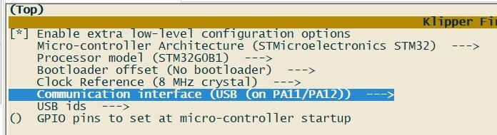

Step 3: Config Firmware
Compile and flash the firmware into the CANbus toolhead board which the BDsensor connected.
cd ~/klipper/
make menuconfig
Here I use the USB port instead of CAN port for the comunication while do menuconfig.
Different board has different configuration in the step make menuconfig and the setp of flash firmware , please read the document of the board from the factory, we didn't change any of that.

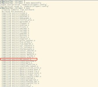

Step 4: Compile Firmware
make
please make sure there is BD_sensor.o on there , else please check the step2
