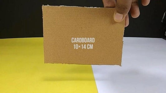

Step 2: Making of the Chassy :
~ So for making the chassis I am using cardboard which is cut into the size of 10*14 cm.

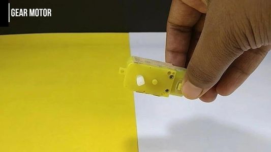

~ Then we need a gear motor 4pcs.
~ We will stick the motor with the cardboard using the hot glue gun.
~ We move into the wiring of the motors, the wiring will go in this way, we will solder the wires to the motors "+" and "-" terminals. As shown in the above image.

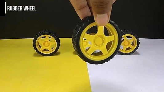

~ We will require a rubber wheel (4pcs) for the motor.
~ Put the rubber wheel in the gear motors. As shown in the above images.

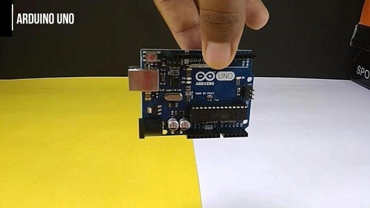

β€’ Mount the nRF24Lo1+, L298D Motor driver IC and 7805 Voltage Regulator to the Receivers PCB.
β€’ Mount the nRF24Lo1+, Arduino nano, and MPU 6050 to Transmitter PCB.
β€’ Then mount the receiver's PCB to Arduino Uno as shown on the image.

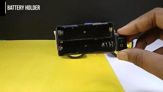

Step 6: Mounting the Battery Holder and ​Receive PCB;
Follow to steps:
β€’ Now in this step, you need to mount the Battery Holder to the Chassy of the car as shown in the image.
