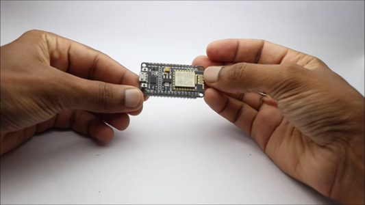

NodeMCU (ESP8266) microcontroller board

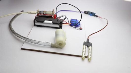

Step 1: Circuit Diagram
The circuit is very simple

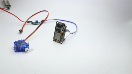

In this project, I have split the circuits into two
First is the Nodemcu, soil moisture sensor and servo circuit

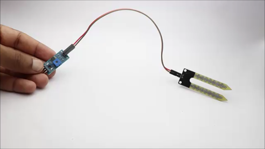

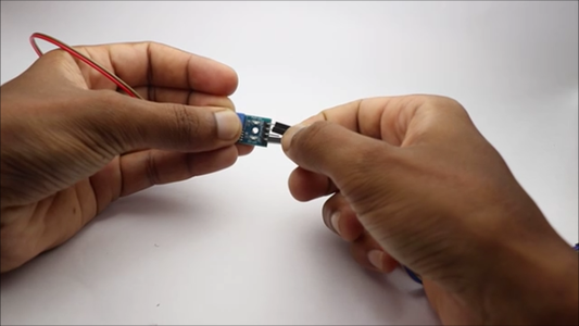

The soil moisture sensor has 3 pins, Vcc, Gnd and A0
Vcc is connected to 3v pin, Gnd to Gnd and A0 to A0 pin on nodemcu.

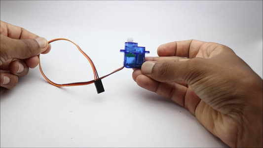

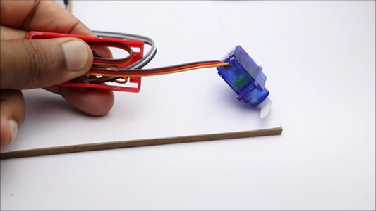

Servo has 3 pins Positive, Negative and signal
Positive to 3v pin, Negative to Gnd pin and signal to D1 pin of nodemcu

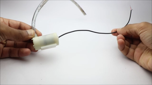

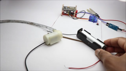

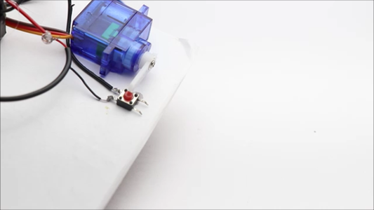

The second is a submersible pump
This is a very basic circuit, the pump is connected to the battery, and the other end of the battery and the pump is connected to a toggle switch.
To activate this circuit we are using the servo movement from the first circuit.
The toggle switch will be pushed by the horns of the servo in return making the submersible pump work.
WHY 2 Separate circuits?
This is because I didn't want to use any source of AC input(relay module to convert to dc power) This makes the circuits complex
I wanted to use only the safest means of power supply, and here comes the power bank!
And secondly, the submersible pump handles water, if there is any mistake the water might splash the electronics thereby causing damage
So 2 separate circuit solves all these issues!

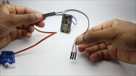

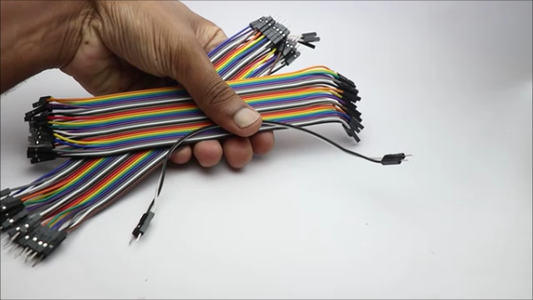

I will be using jumper wires to make connections between different components.

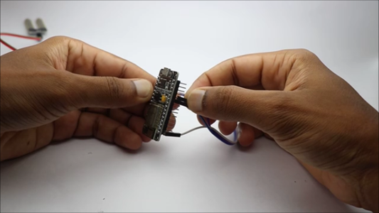

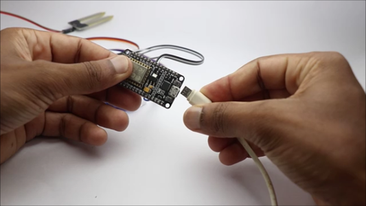

Start with the soil moisture sensor, connect these first to nodemcu board.
Later work with micro servo, This completes the first part.
After this process, you can upload the code to the board.
I did not use any breadboard to make the circuit as it increases the number of jumpers used, so i thought direct connections would reduce the wires to some extent.

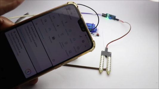

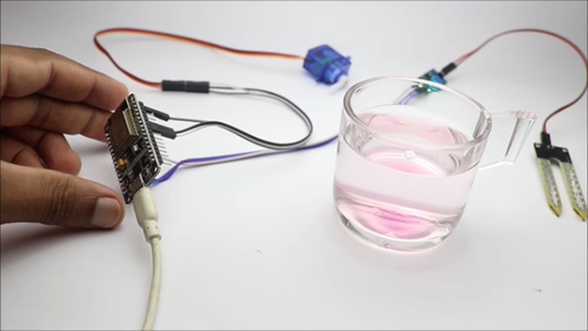

Since the first part is the control unit for the second circuit we will test it first.
Connect your nodemcu to a power bank or any USB power supply device
Open the hotspot on your phone/laptop
The nodemcu will connect automatically
go to ->Connected devices and note down the IP address of your board

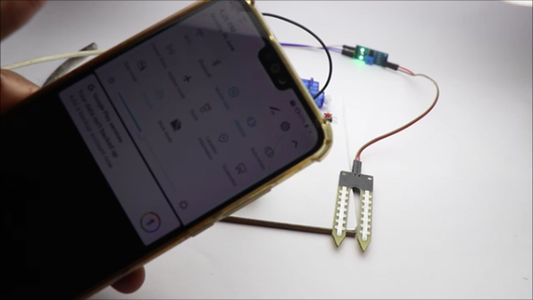

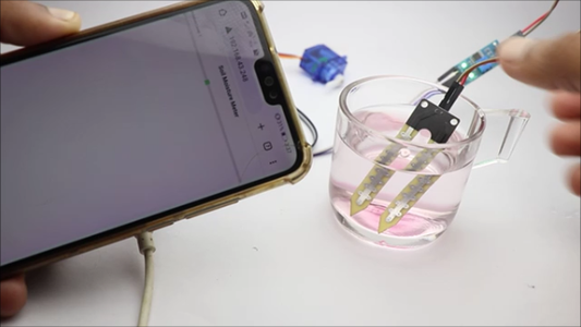

Paste the IP on your browser, you will see a screen with soil moisture and a slider to control servo
Dip the soil moisture sensor into water and refresh the page on your phone, it will show the moisture
Now move the slider, the servo should make movements.
This completes our first part of the circuit which you can also call a controller circuit.

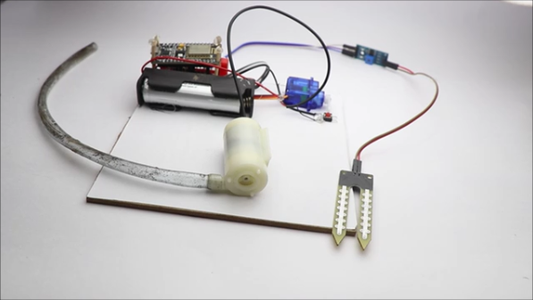

Step 5: Getting Everything Together

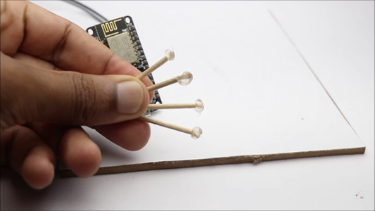

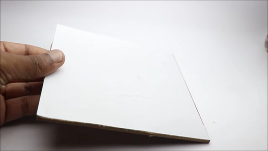

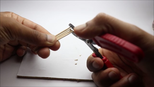

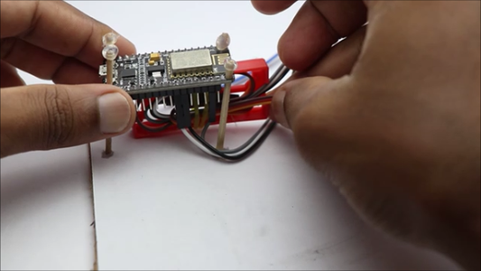

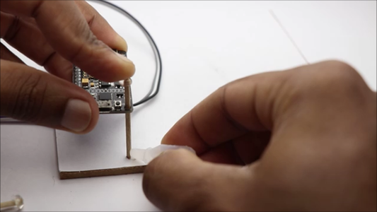

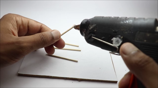

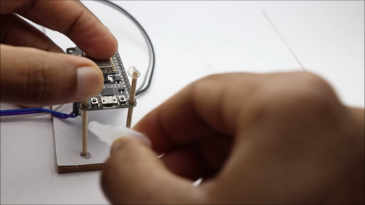

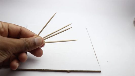

To place all the electronics i will be using the cardboard as a base.
To hover the nodemcu board, i made use of toothpicks, Just trim the sharp edges and add a drop of hot glue.
Repeat the same steps for all 4 sides, Stick on the board using superglue.

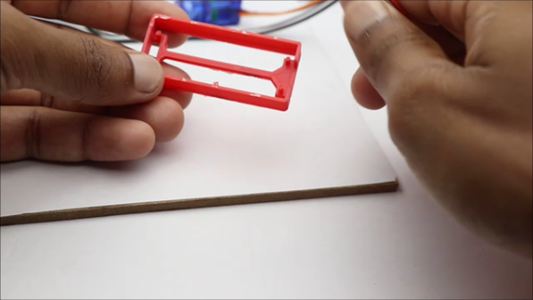

To sort out the wires issue i used a 3d printed part, because of this part i was able to clear a big pile of jumpers lying around.

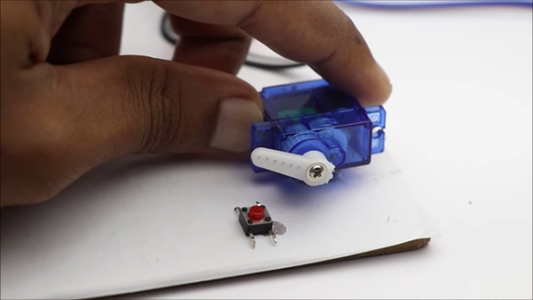

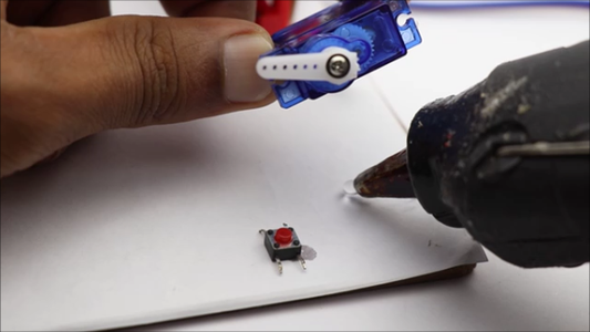

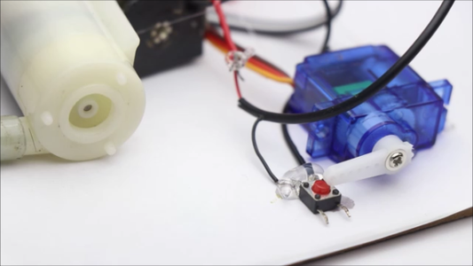

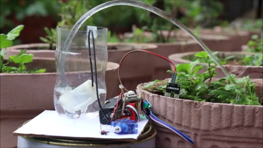

To make the servo horn run the toggle button, i glued the toggle switch to the board first, later to its side i glued the servo.
All other components are placed on the board.

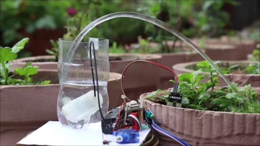

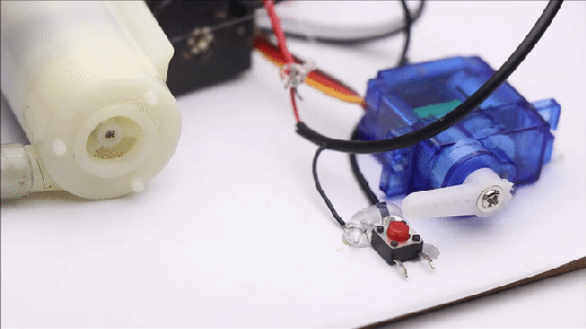

Step 6: Finishing

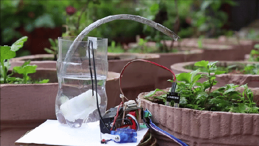

Like i mentioned earlier submersible pump is activated by pressing toggle switch.
From the second image of this step you can see the placement of servo horn and toggle switch.
Use hot glue wherever necessary to keep the components in place.

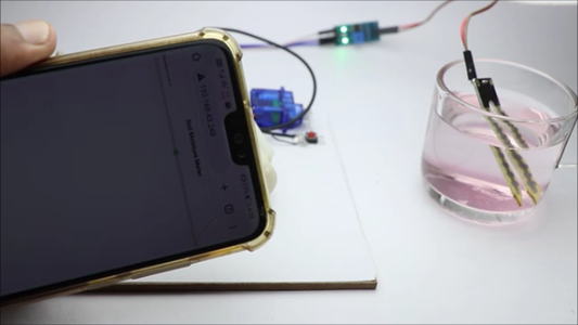

After everything is in place, connect USB power supply to the nodemcu, turn on mobile/laptop hotspot.
Nodemcu connects with your device, from there type your IP on the browser tab.
You will see an option to check moisture level at the top followed by a sliding button to on and off servo.
On sliding the servo button, toggle switch is activated as a result water is supplied.
Water storage container can depend on the amount of water you would supply for the plant, Each plant requires certain level of water.
