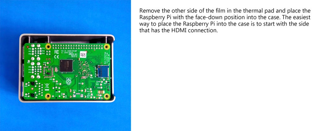

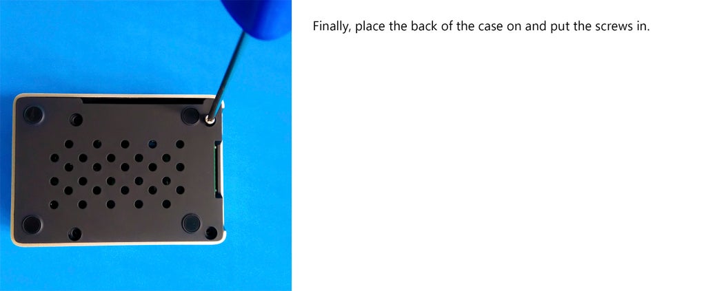

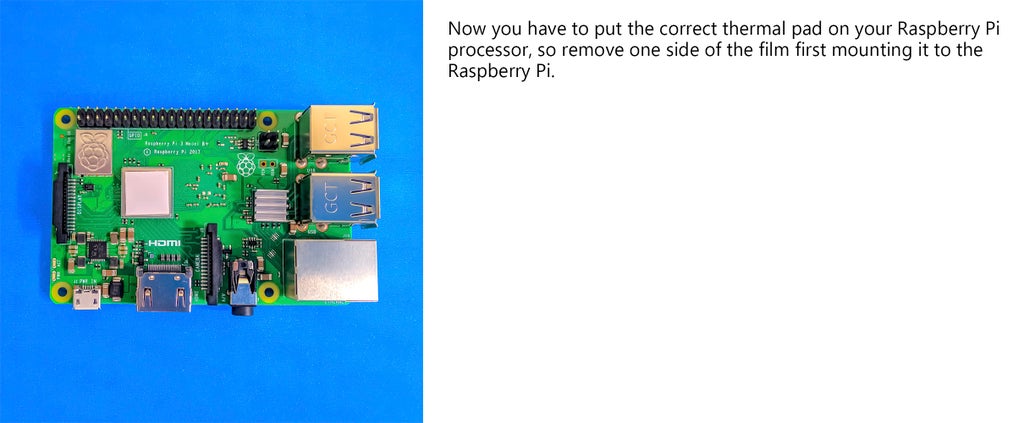

Step 2: Place the Raspberry Pi Into the Case
The first thing that you have to do is to assemble the console. For that you have to basically put your Raspberry Pi into the case and screw it; if you're using the Flirc case follow the images below.

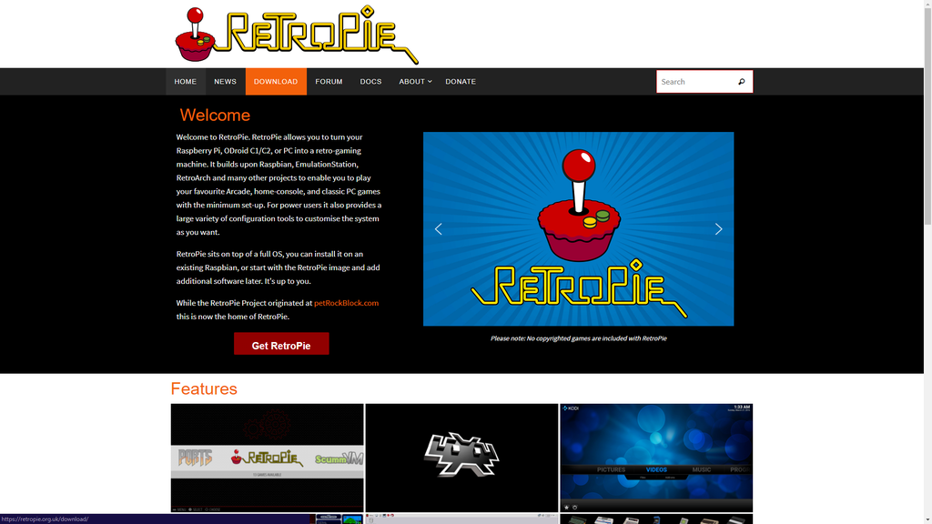

Now that you know a little bit about RetroPie let's download the software. So go to the RetroPie site and download it.
Note: Click on the Raspberry Pi 2/3 option in the Download section to download the RetroPie to any model of the Raspberry Pi 2 and 3.

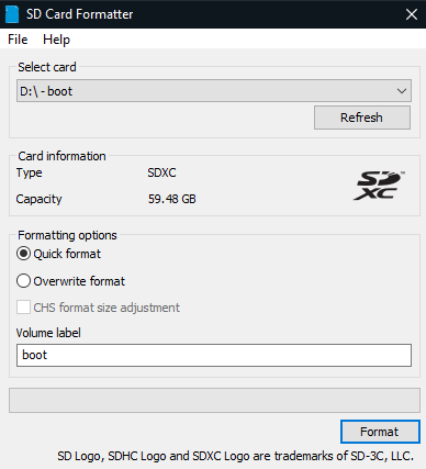

Now it's time to install the RetroPie on your microSD card. First of all, you'll have to download two softwares: the SD Card Formatter, and the balenaEtcher.
The first step to install RetroPie is formatting your microSD card. So insert it in your computer (you can use an adapter), open the SD Card Formatter, select the microSD card that will be used for RetroPie, and format it.
Once you've done that, unzip the RetroPie file that you downloaded and open balenaEtcher. In this program select the RetroPie image in your computer, select the microSD card and flash it.
Wait until the process finishes and RetroPie will be installed in your microSD card.

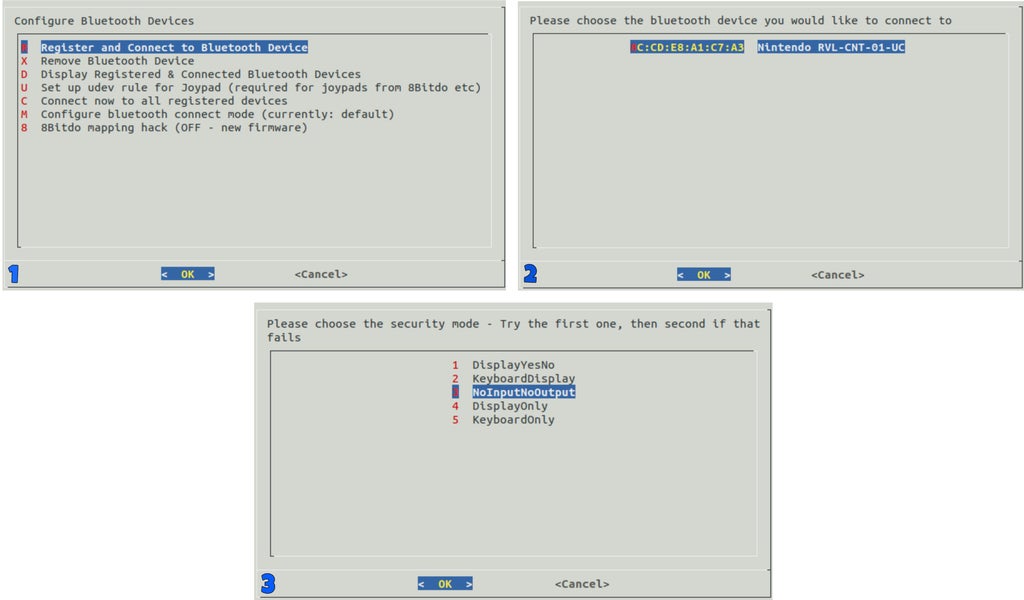

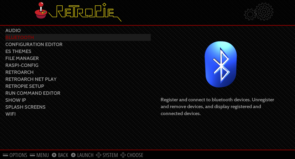

2. Configuring a Bluetooth Controller
To configure a Bluetooth controller go to the configuration menu with the keyboard and select Bluetooth.
Now select Register and Connect to Bluetooth Device, it'll search for your Bluetooth controller, at this moment you have to press the Sync button to synchronize your controller with the Raspberry Pi, (this button in the Nintendo Wii U Pro Controller is the red button located on the back). Then select your controller and select the NoInputNoOutput option in the next screen. Follow the images below.

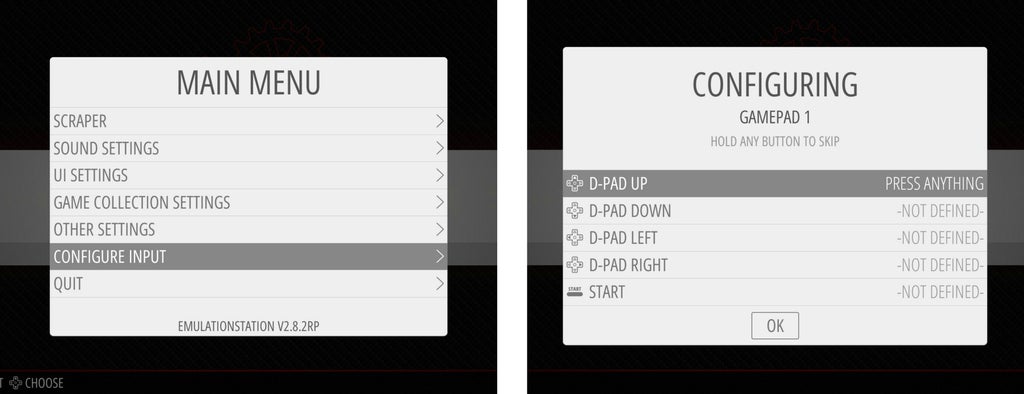

After that, go to the main screen in RetroPie, press the start button to open the main menu and select Configure Input, then hold any button on your Bluetooth controller to be detected and configure it. Once configured, your Bluetooth controller will be working.

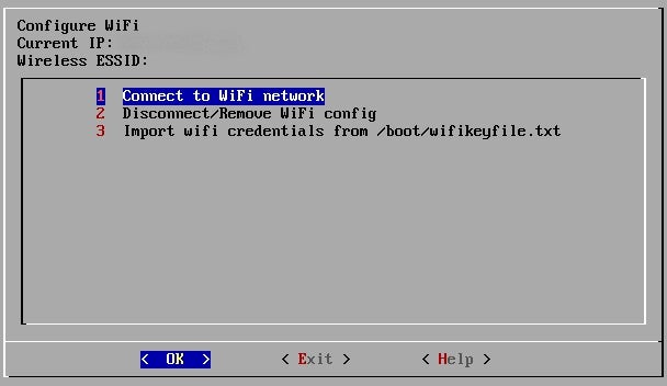

3. Configuring the Wi-Fi
Now in this step, we'll need a USB keyboard to configure the Wi-Fi. So go to the configuration menu, select Wi-Fi, select Connect to WiFi network, then choose your Wi-Fi network and put your password.

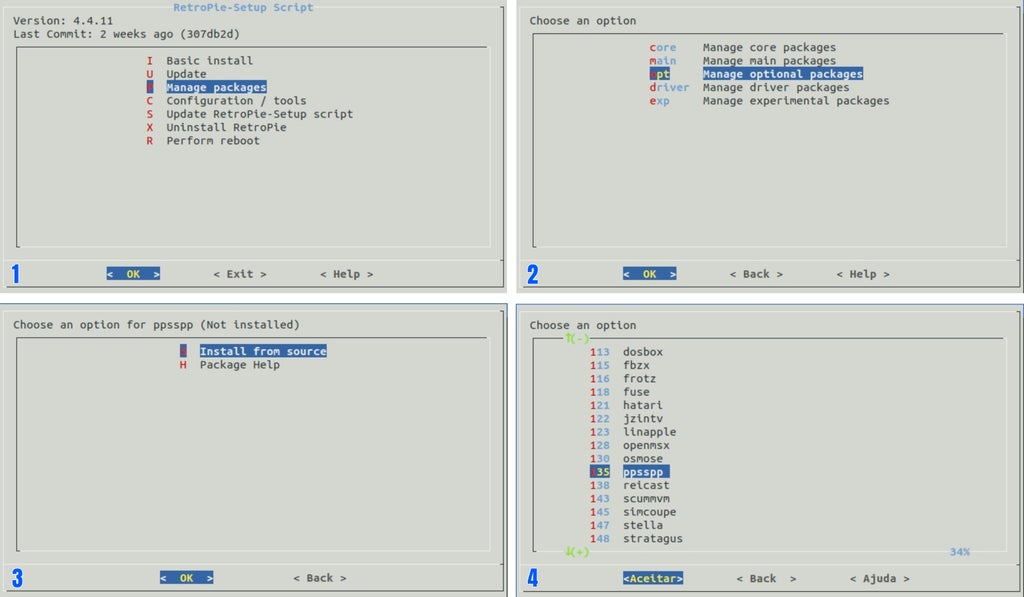

RetroPie comes with more than 50 system pre-installed by default, but there are much more emulators that you can install and isn't installed by default. To install more emulators go to RetroPie Setup in the Configuration menu, and first of all, select the option Update RetroPie-Setup script, and then go to Manage packages; in this section, select Manage optional packages, and you'll see a lot of emulators to install like PPSSPP (the emulator for PSP) and Reicast (the emulator for Dreamcast). You can also select Manage experimental packages to install some emulators that are being tested like Drastic (the emulator for Nintendo DS), and you can even install some ports like Minecraft Pi edition. After choosing the emulator that you want to install, select the option Install from source and wait a few minutes for the emulator to be installed. Follow the images below.

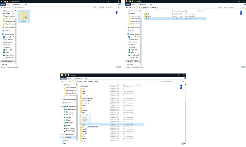

Transferring Roms using a pen drive
To transfer the games using a pen drive you'll have to plug the pen drive in your PC and format it to FAT32, then create a folder in your pen drive called retropie, plug it into the Pi and wait for it to finish blinking, then pull the pen drive out and plug it into a computer. Now in the retropie folder, you will find the folder roms, click on that and add the games to their respective emulators folder. Plug the pen drive back into the Raspberry Pi and wait for it finishes blinking, once you've done that you can remove the pen drive. Follow the images below.

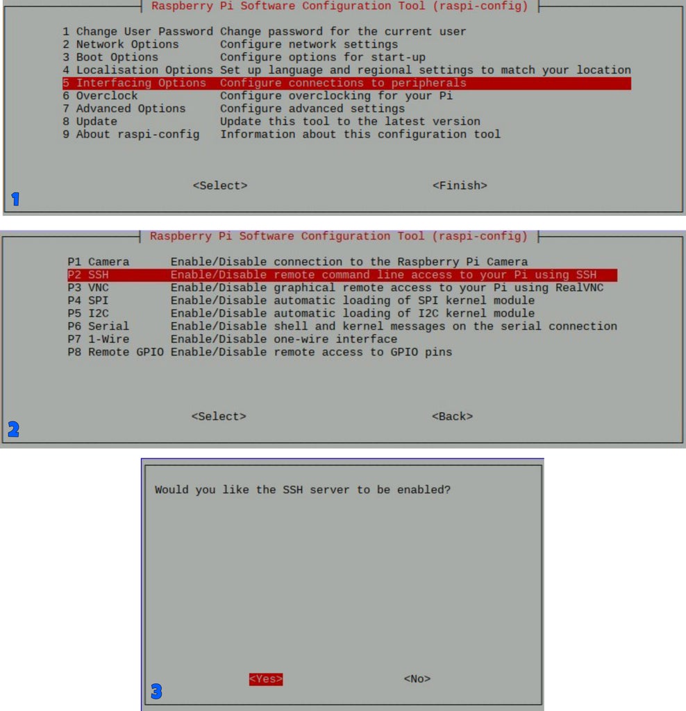

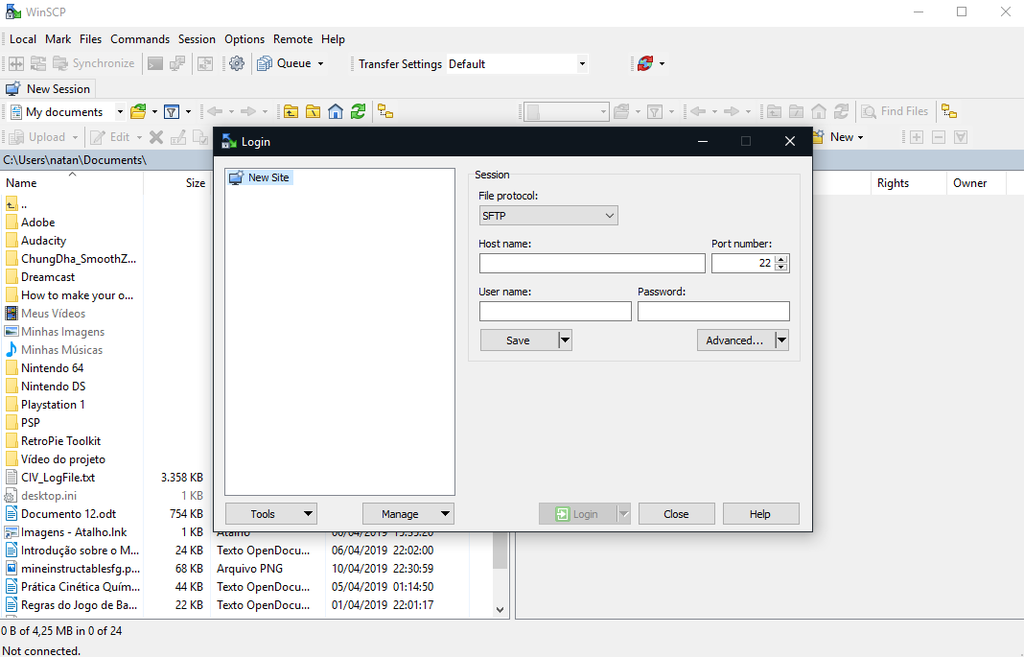

SFTP also called Secure File Transfer Protocol is a network protocol that allows you to securely transfer files over a network. Your Raspberry Pi and your PC will need to be connected to the same network via Ethernet or Wi-Fi. So first, you need to enable SSH in RetroPie, go to the configuration menu, select Raspi-Config, select Interfacing Options, then select SSH and click Yes to activate the SSH server. Follow the images below.
Now go to your computer, and you will need to download an SFTP program to transfer the games to your Raspberry Pi, I recommend WinSCP for Windows and Cyberduck for Mac. In WinSCP Login screen select SFTP in File protocol, put the IP address of your Raspberry Pi in the Host name section (to find the IP address of your Raspberry Pi, go to the Configuration menu and select Show IP); then put the User name that is pi and the Password that is raspberry by default in RetroPie. Now click on Save, select Login and your computer will be connected to the Raspberry Pi.
Now the only thing that you have to do is to copy the games from your computer to the corresponding emulator folder in /home/pi/RetroPie folder in your Raspberry Pi.

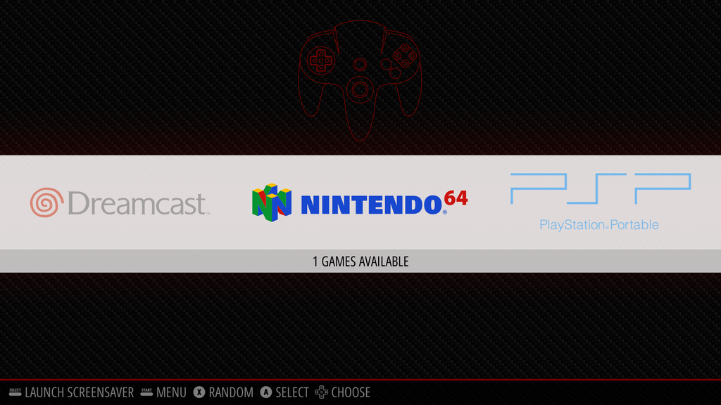

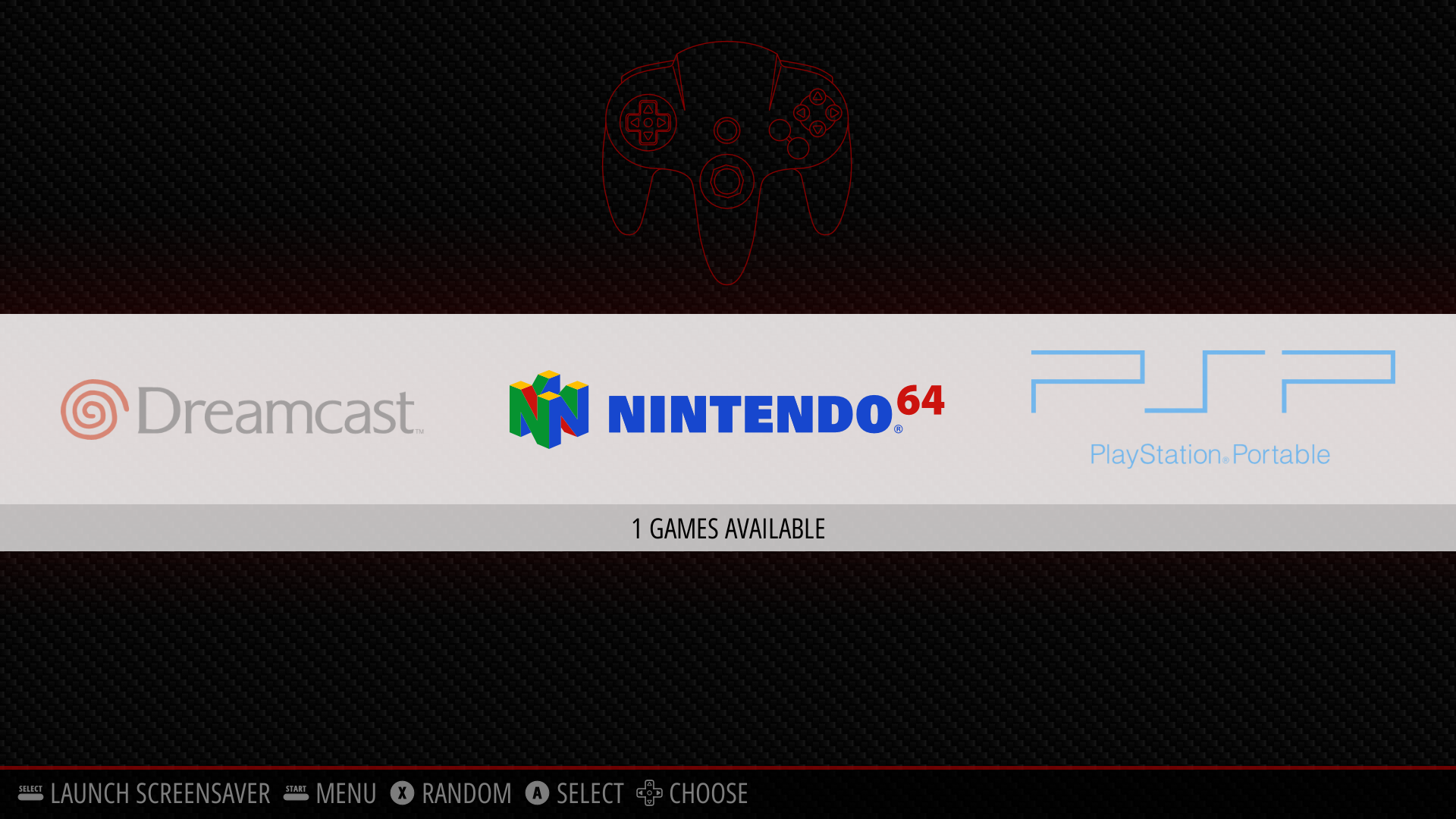

When you finish to Transfer the games to your Raspberry Pi go to the Main menu select Quit and then select Restart EmulationStation.
You will see that the games will appear in each emulator section in the initial screen. If so, the games are already installed in the RetroPie.
