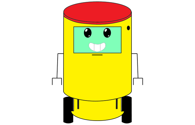

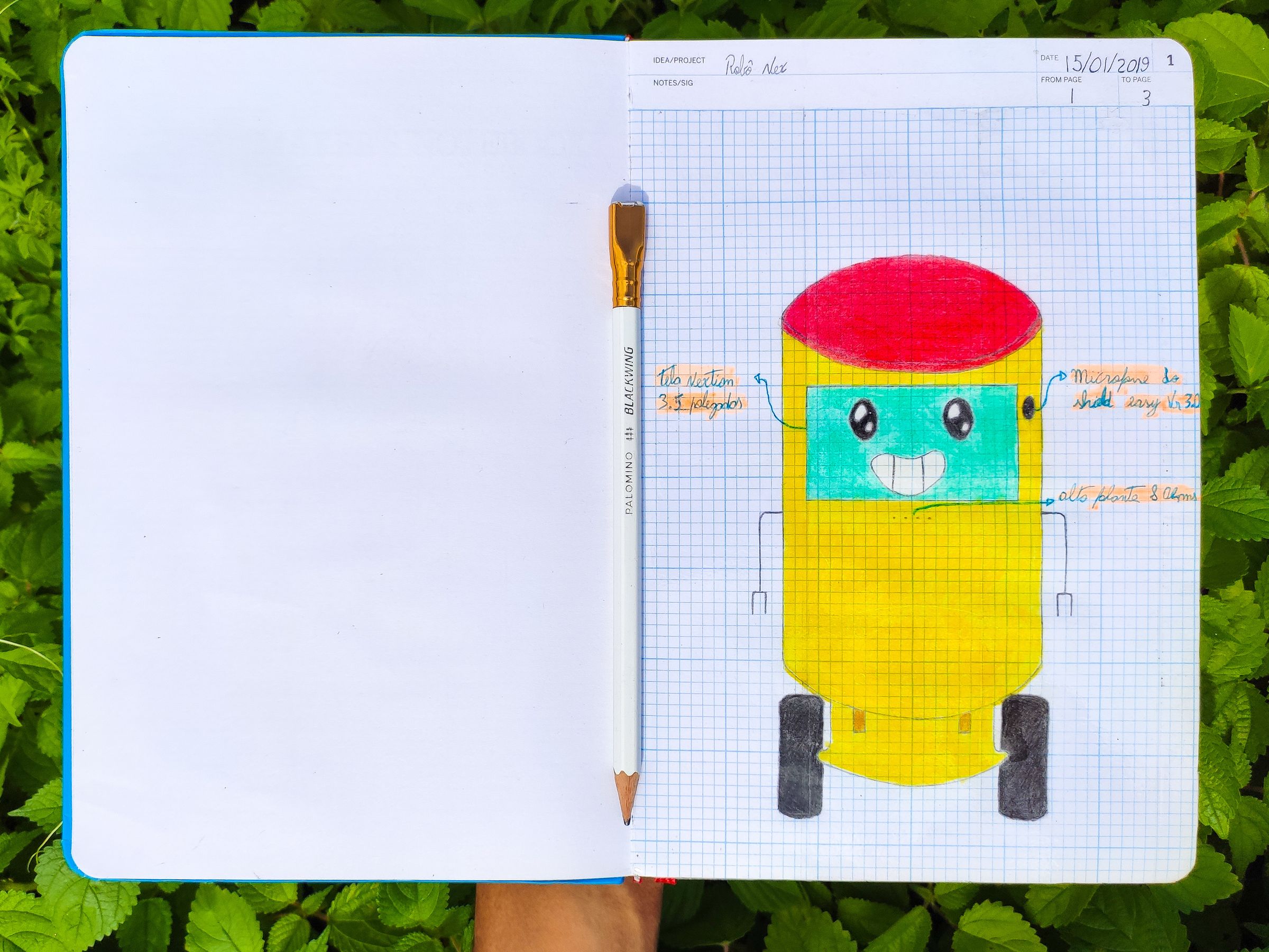

As every project starts first of all in our minds, it is very important to put your idea on paper before starting the construction of any project, to already have an idea of what parts and materials can be used to turn an idea into reality. Taking this into consideration, the image above illustrates one of the first sketches of my robot, made in early 2019 where a simulation of how NEX looks in the final project is shown. Later this illustration was improved and consequently had some small modifications. The image below illustrates the 2D view of the project already updated, made with the help of graphic software on the computer.

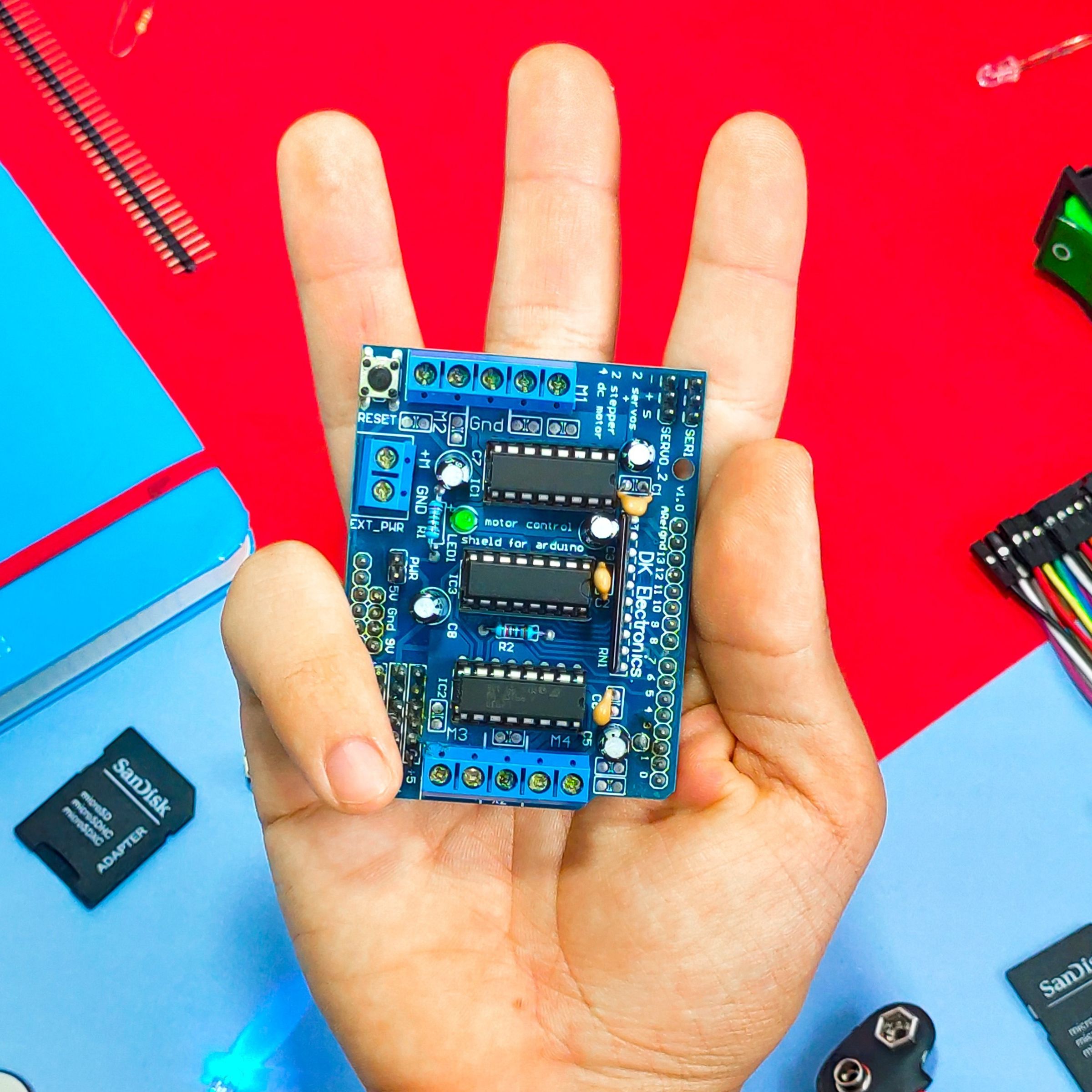

Let's start with this piece, This is the Motor Shield L293D it is based on the L293D chip and can be used with the Arduino. This Shield is very interesting because it allows you to control motors with your Arduino board. It is possible to control up to 4 DC Motors, 2 Servos, or 2 Stepper motors simultaneously with it. I used this Shield to control NEX's arms that work with two servo motors SG90, and also the two DC motors that make it move around.

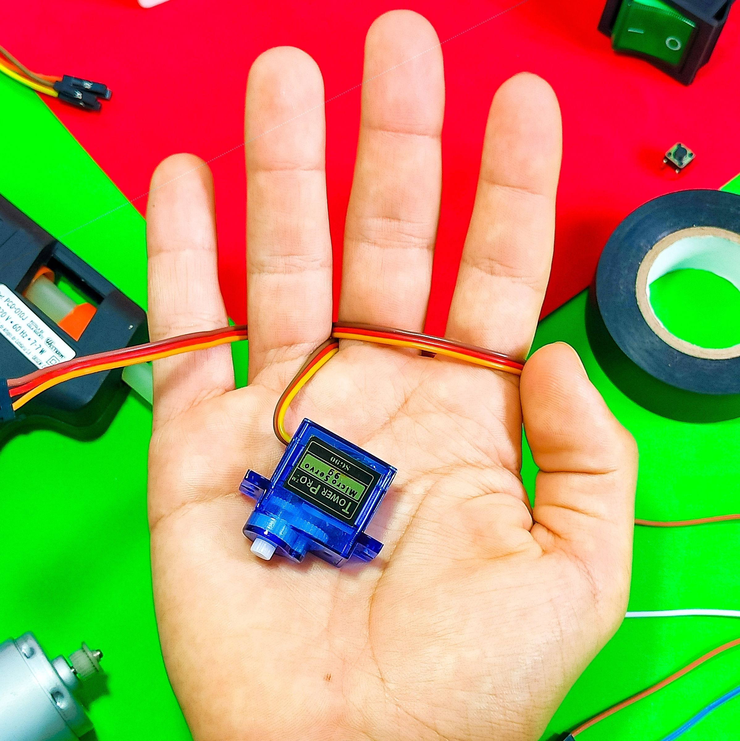

This is the Servo Motor SG90, it is nothing more than a motor with angular position control, it is: through PWM signals it is possible to command that the servo motor is its axis until the determined angle, being able to go from -90º to 90º, or that is, it has a degree of freedom of 180º. In addition, the SG90 Servo motor is one of the most popular when it comes to Arduino or Educational Robotics. This is because it has a small size and torque suitable for most educational applications. In my project, 2 servo motors were used, to move NEX's arms.

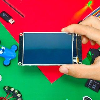

This is the Nextion Display Enhanced NX4832K035, this display is very powerful, I made the face of my robot using it. It includes a hardware part (a series of TFT boards) and a software part (the Nextion editor). The good thing is that the Nextion TFT board uses only one serial port to communicate.

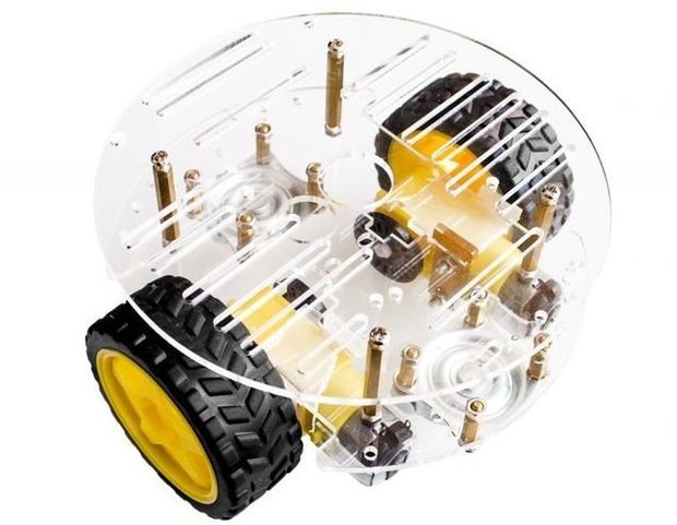

Another very important part is the Round Robot Chassis Kit, this kit includes two DC motor that controls the NEX's wheels, so my robot can move forward, backward, rotate, go right and left, and so on.

Once this was done, the NEX robotic chassis was assembled, as it comes completely disassembled from the factory. It was necessary to fit all the parts of the chassis in addition to making the proper electrical connections to the engine. See the image below of a chassis already assembled.

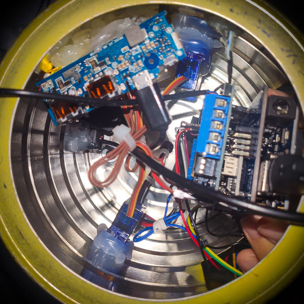

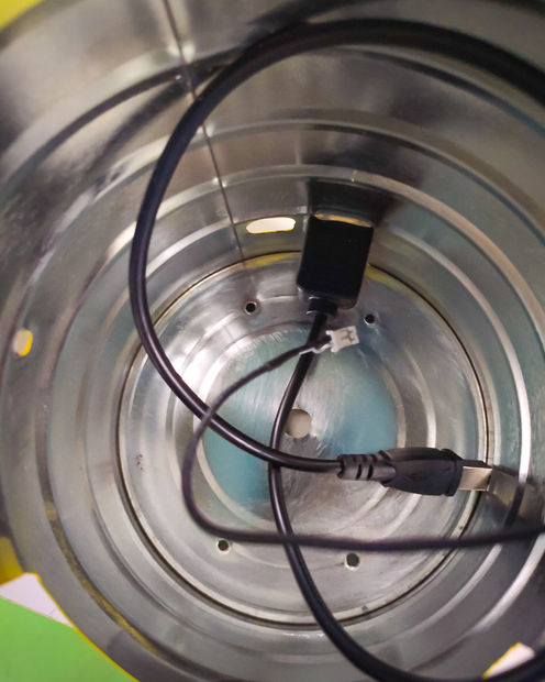

With this ready, the HC-SR04 ultrasonic sensor was strategically positioned under this chassis and the milk can (robot body) was screwed on top of the previously mounted robotic chassis. After that, the cables were connected and attached to the NEX body that makes the connection between the internal components to transform them into outputs or inputs on the outside of the robot body, such as the microphone, to the USB port to be recharged and the USB port of Arduino. See the image below:

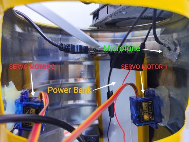

Then, two motor servos were added to the robot body, one at each end of the can, and also the 10000mAh power bank. As shown in the picture below.

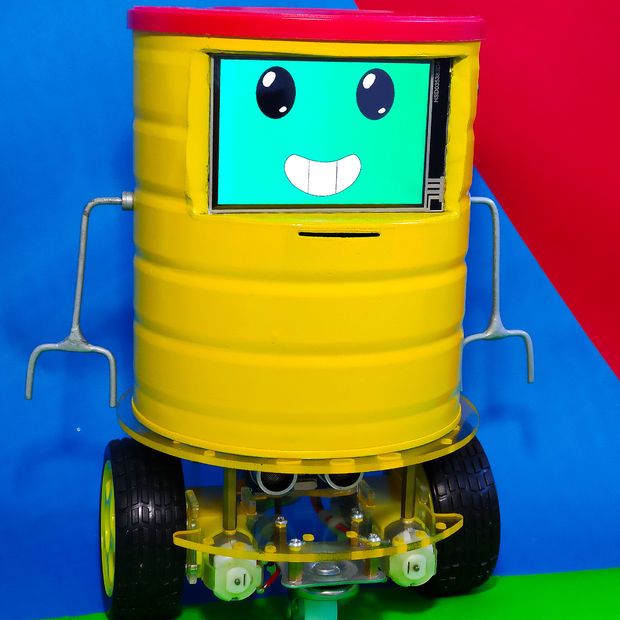

And that was how the NEX robot looked at the end of its creation process.
