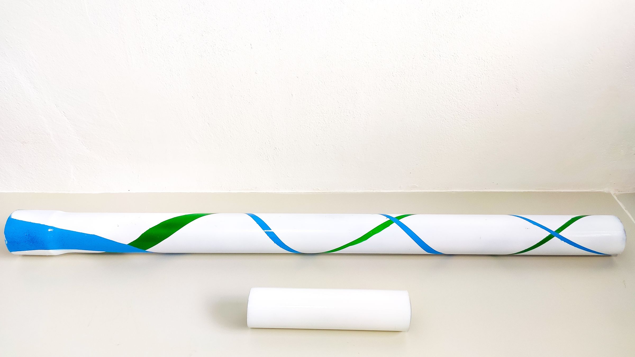

Step 2: Making the Optical Tube of the Telescope

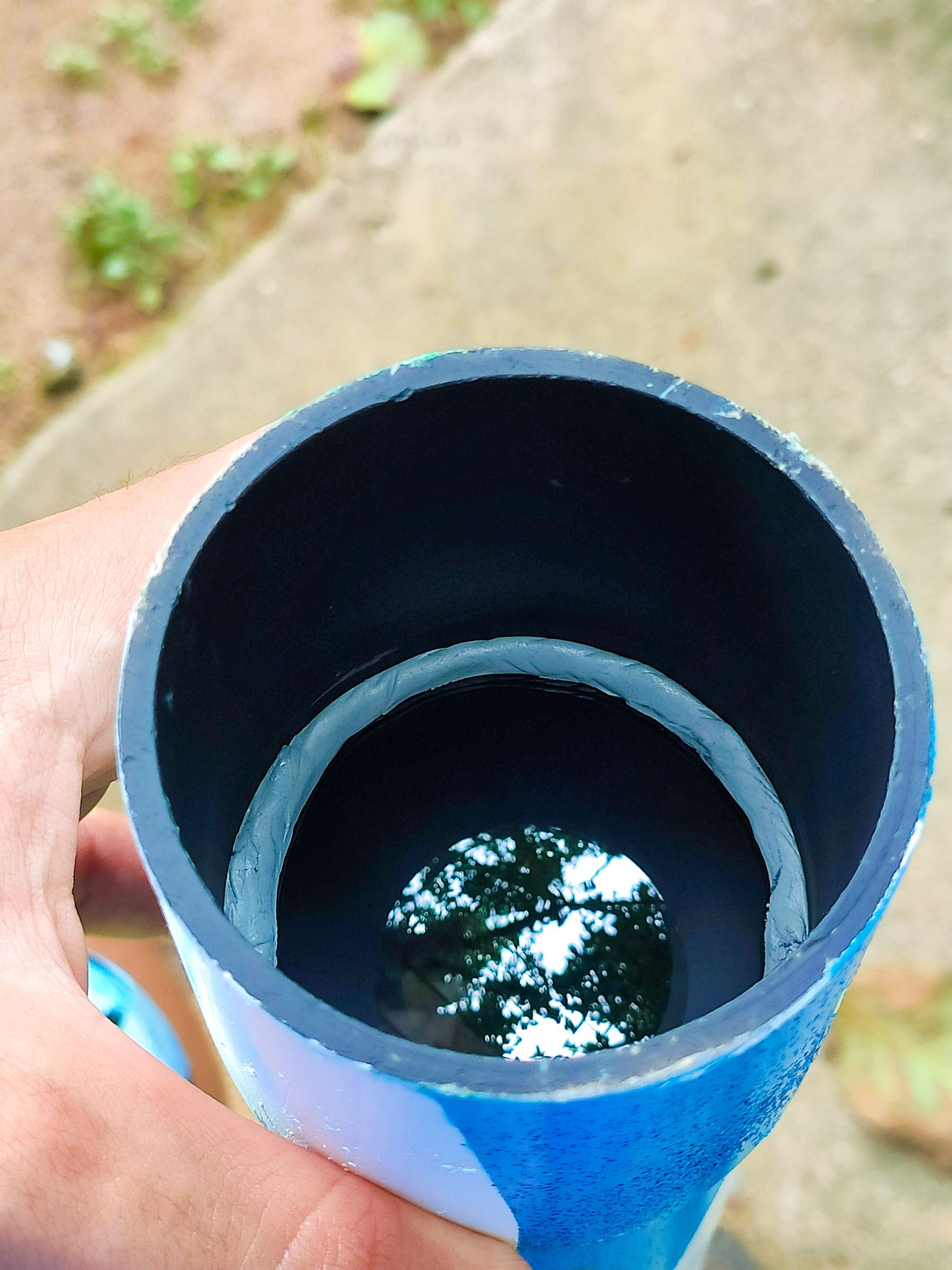

The first thing that you have to prepare is the optical tube of the telescope, to make that you will need 90 cm of the 60 mm weldable pipe and 20 cm of the 50 mm weldable pipe, with these pipes in hand you will have to paint the inside of these two pipes with matte black spray paint.
After painting the pipes, you should take the 50 mm pipe and at one end, place a layer of double-sided tape. And then place the 50 mm pipe inside the 60 mm pipe. See the images below.

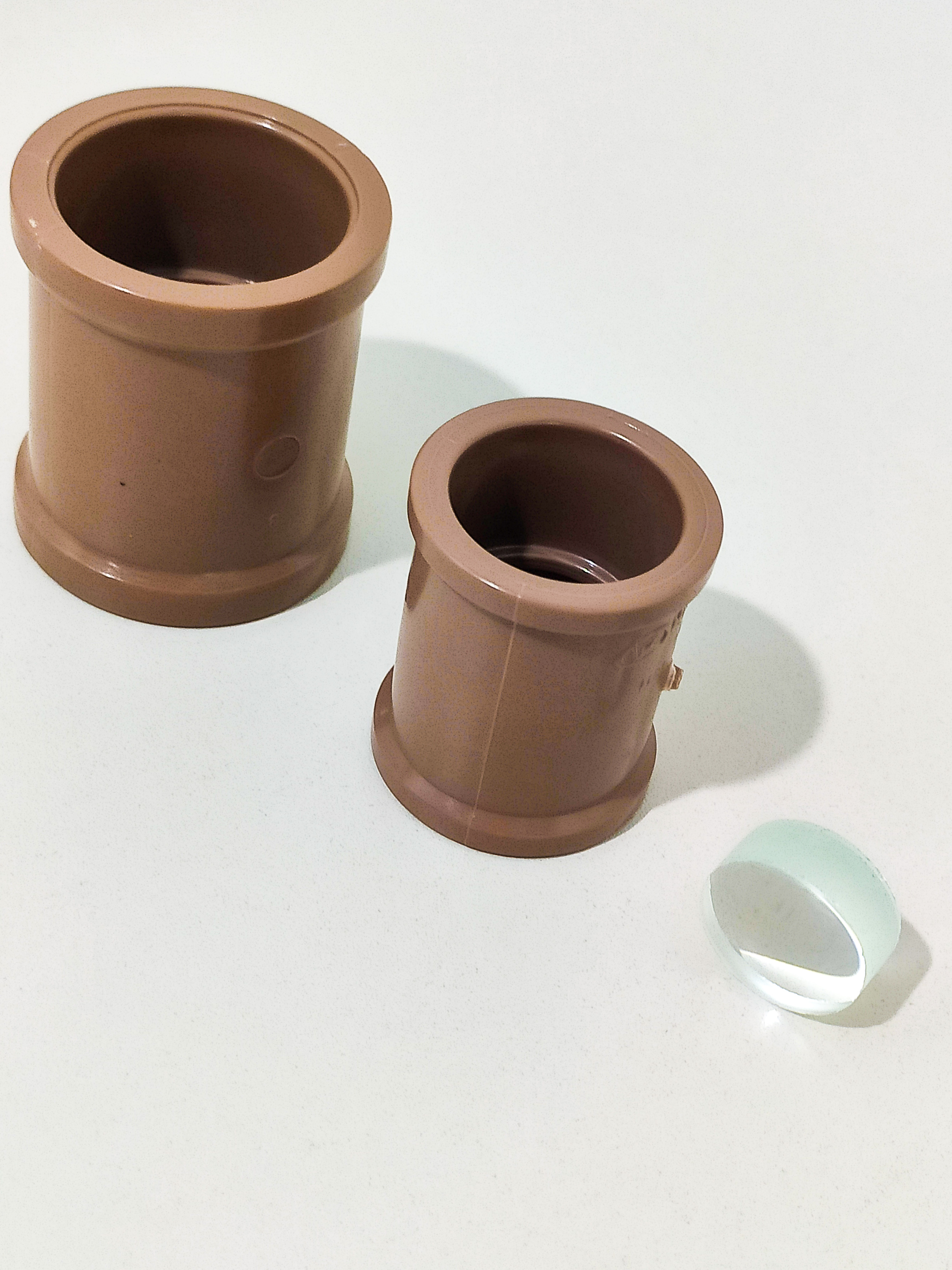

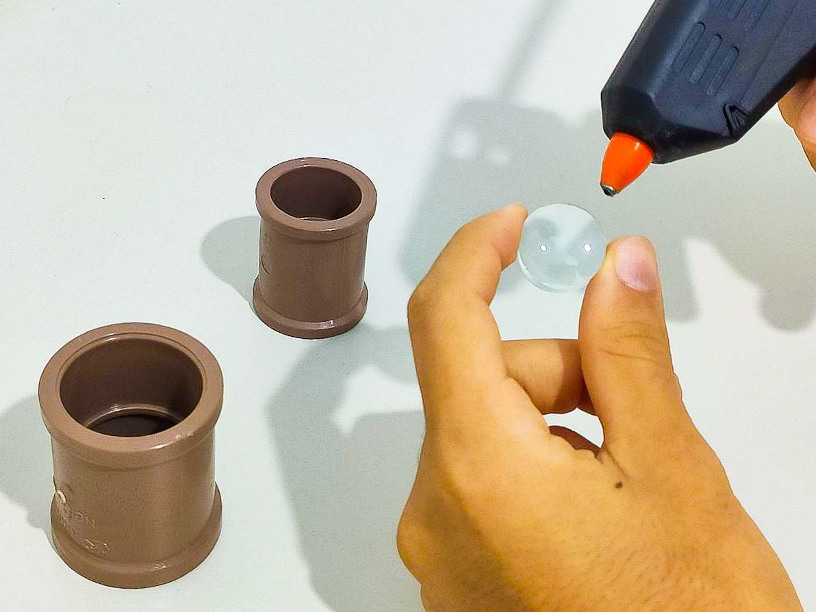

To make the eyepiece of the telescope you will need to have the 32 mm sliding sleeve for weldable pipe, the 25mm sliding sleeve for weldable pipe and the 21 mm jeweler's loupe.

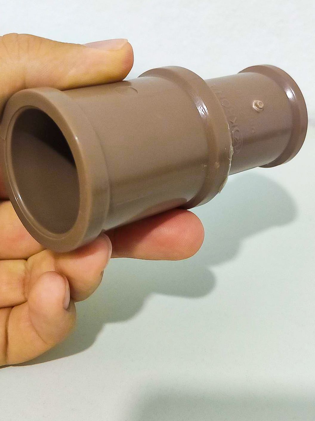

First place the 25 mm sliding sleeve inside the 32 mm sliding sleeve and use a hot glue gun to join these parts. Then glue the jeweler's loupe 21 mm in the 25 mm sliding sleeve and you will have your eyepiece finished. See the images below.

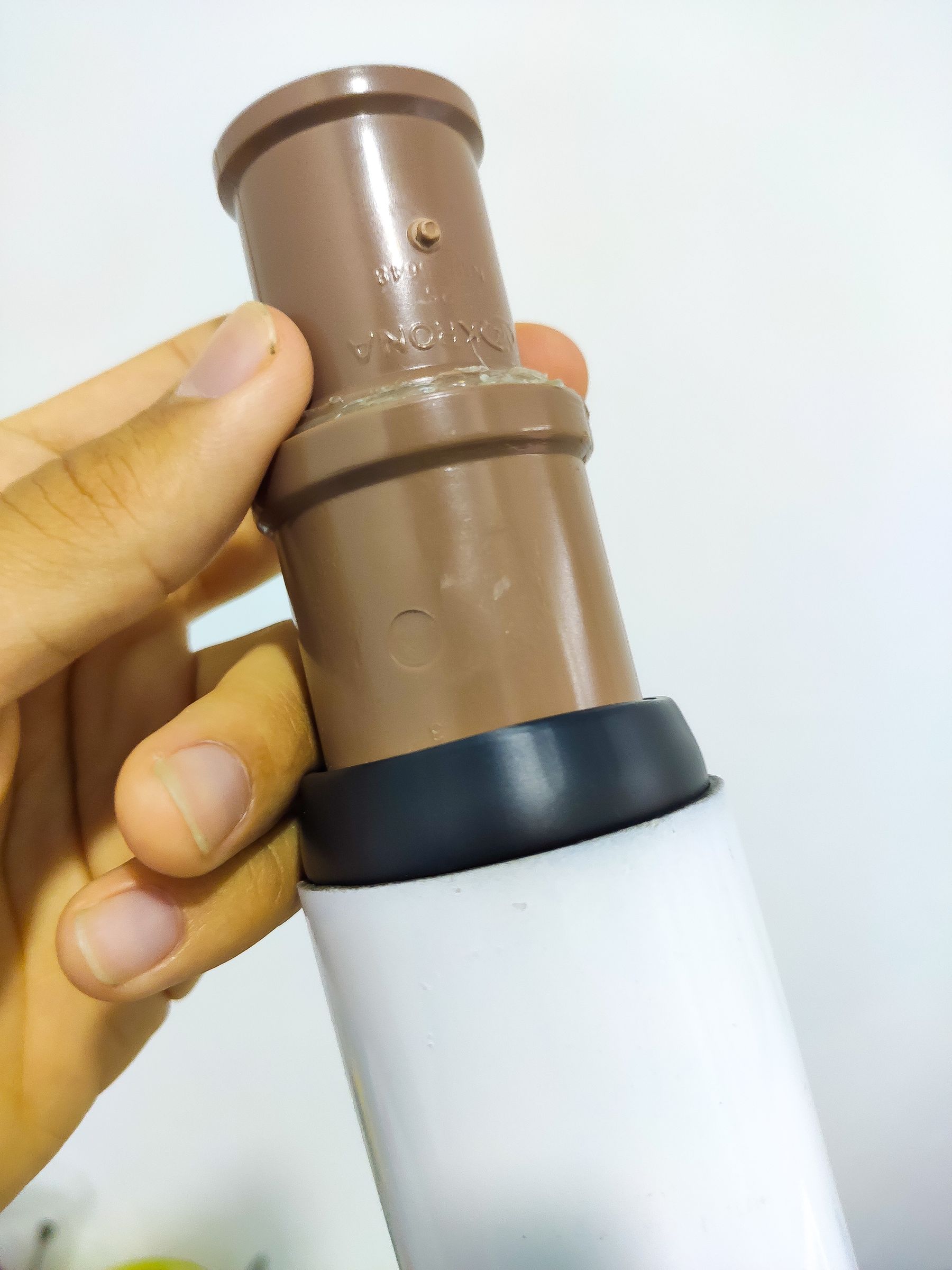

After doing this, place a layer of double-sided sponge tape around the 32mm end of the eyepiece and put place the eyepiece that you made inside the 50 mm pipe. See the images below.

Now we have to put the 60 mm lens with a 1+ degree on the 90 cm weldable PVC pipe 60 mm. To do that put the lens in the side of the pipe that has 60 mm of diameter and then put "Durepoxi" that is an epoxy adhesive around the lens like the image below.
Note: Be sure to clean your lens before putting it in the 60mm pipe, a dirty lens will interfere with the quality of your telescope.
