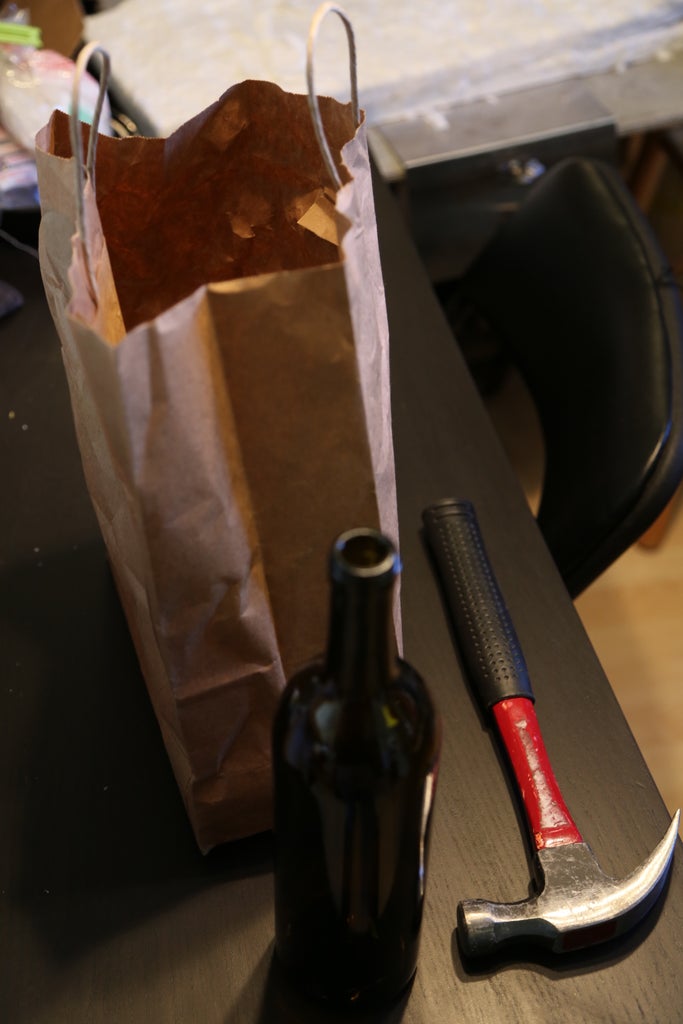

Hammer (for breaking a glass bottle)
Heavy Duty Bag (to break the glass in)

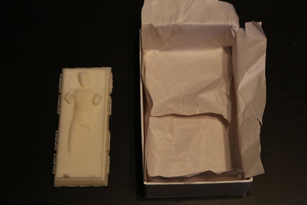

Step 10: Making the Plaster Casting Mold

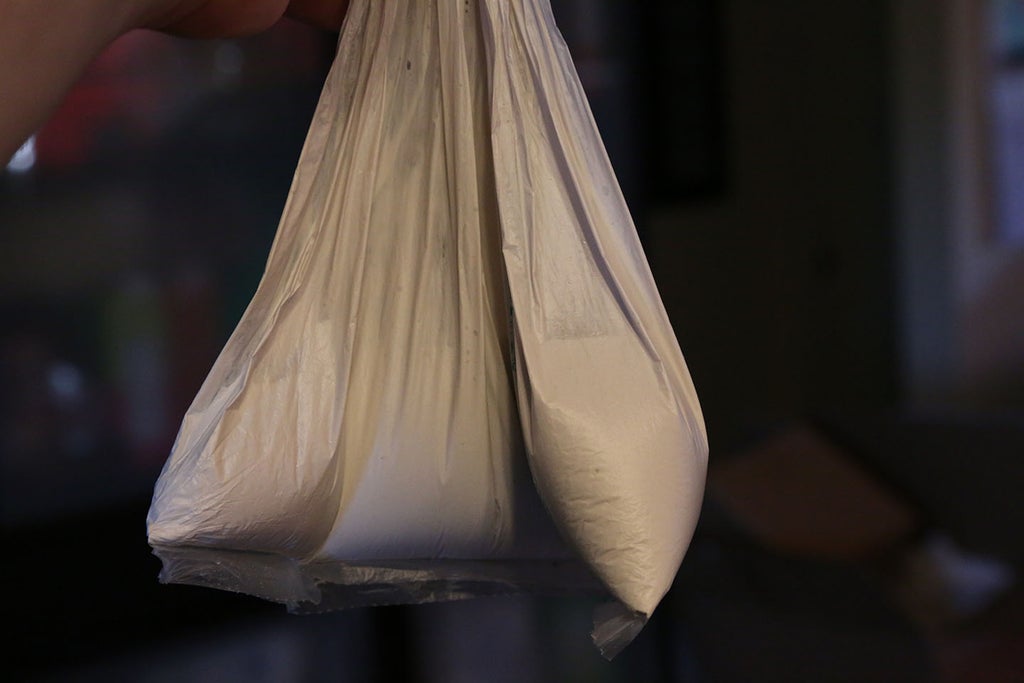

In order to make a good impression for the plaster mold you will need to follow a few simple guidelines:
![](https://content.instructables.com/F5U/I8XQ/H6WG6QUH/F5UI8XQH6WG6QUH.jpg?auto=webp&fit=bounds&frame=1&height=1024&width=1024)
While you are waiting on the slacking plaster mix you should prepare the cardboard box that will receive your mold. If you plan to throw away the box you can skip this step. However if you want to reuse the cardboard container for a future mold you should line the box with a semi-durable paper or other thin material. I cut up some strips of packing paper that worked great to preserve the box.
![](https://content.instructables.com/F3J/AEGB/H6WG6QUF/F3JAEGBH6WG6QUF.jpg?auto=webp&fit=bounds&frame=1&height=1024&width=1024)
Next you should place your mother mold top-side-down into the box. Make sure you have at least an inch of space around the mother mold along the perimeter.
![](https://content.instructables.com/FGY/ALMU/H6S41PJ8/FGYALMUH6S41PJ8.jpg?auto=webp&fit=bounds&frame=1&height=620&width=620)
Once the plaster mix has slacked you can cut off the tip of the bag and slowly pour the plaster mix around the edges of your mother mold. Do not pour the mixture directly on to your mold. This process makes it much easier to control the flow and will minimize the production of bubbles in the plaster mold. Gently tap the sides of the box to work up any big air bubbles.

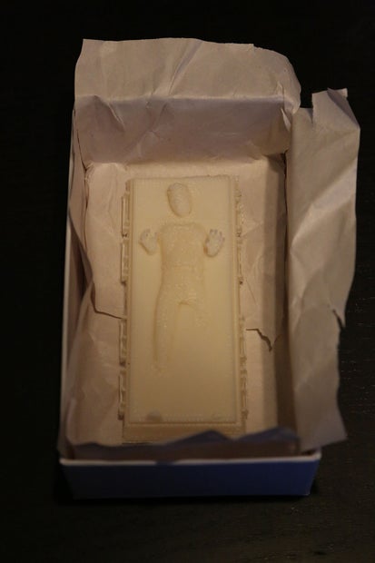

Here we have the extracted mother mold and the final plaster mold. I was very impressed with the level of detail that the plaster retained.
The final step here is to slowly heat the plaster mold up to 1200 in your kiln. You should heat the kiln at a rate of about 300 degrees per hour. Then allow the mold to soak at 1200 degrees for around 30 minutes. You can then bring the temperature down to 950 degrees at a rate of 300 degrees per hour. Finally turn off your kiln and allow the mold to slowly cool to room temperature. Any remaining bits of ABS will burn off in this process, but it is ESSENTIAL to have STRONG, EFFECTIVE VENTILATION to remove the TOXIC FUMES generated by this action. Do not leave any significant amounts of ABS in your plaster mold in order to minimize the volume of toxic fumes that will be produced.
You will now have a finished plaster mold that is ready to receive the molten glass material! It is normal for cracks to appear in the plaster mold. Don't worry about these cracks unless you find that the mold is breaking into separate pieces. My piece came out of this process with a complete crack at the feet side of the mold. Just to be safe I surrounded the plaster mold with steel wire to hold the mold in position.

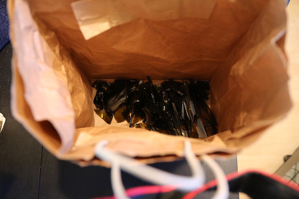

Step 12: Breaking the Bottle
Begin by gathering your materials and tools for this step. You will need:
![](https://content.instructables.com/FZS/2Q6J/H67NSSE1/FZS2Q6JH67NSSE1.jpg?auto=webp&fit=bounds&frame=1&height=1024&width=1024)
You will want to break the glass into pieces that are small enough to fit into the terracotta pot you will use for the kiln melt. Don't make them so small that they all fall out of the hole before they melt.
- A hammer
- An empty wine bottle (dark colored glass preferred)
- A heavy duty bag to contain the bottle and broken glass
- SAFETY GLASSES
- HEAVY DUTY GLOVES
- A terracotta pot to hold the broken glass
![](https://content.instructables.com/F9O/Y8T5/H67NSSDZ/F9OY8T5H67NSSDZ.jpg?auto=webp&fit=bounds&frame=1&height=1024&width=1024)

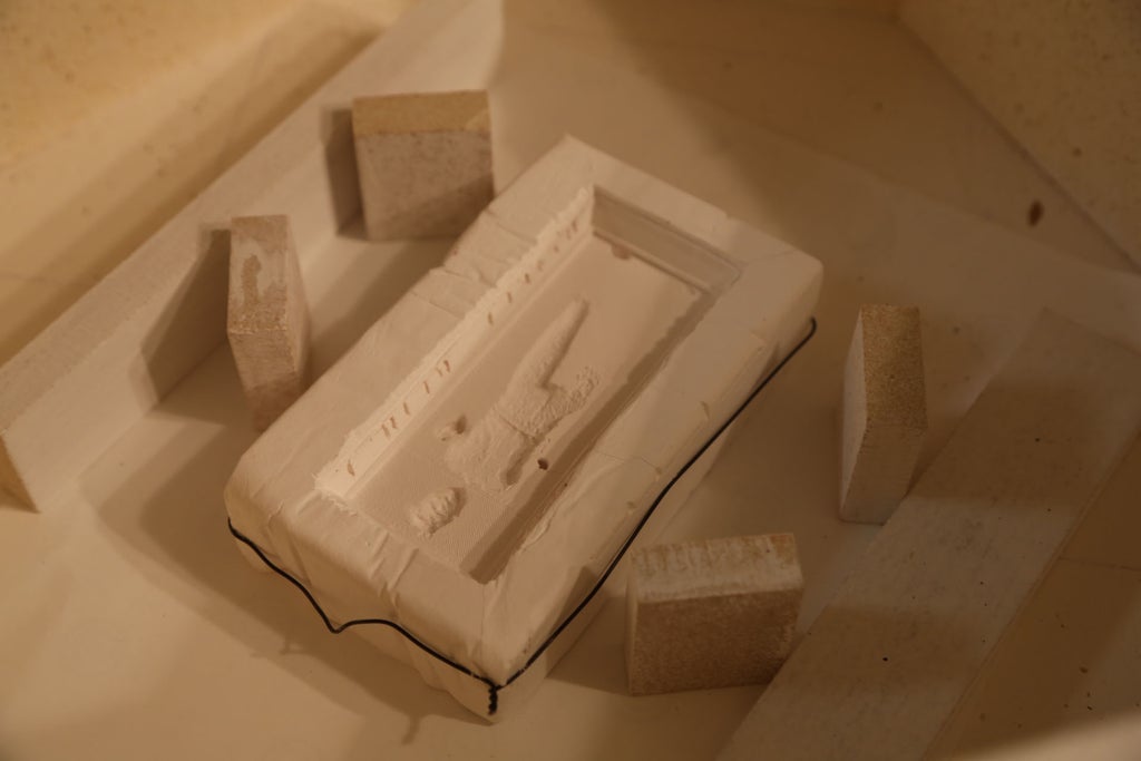

You now have everything you need to make the finished product--glass, a plaster mold and the kiln. You must first setup the kiln to properly stage a pot melt into the plaster mold.
First make sure the kiln shelf has been properly prepared with kiln wash or other material to prevent the molten glass from sticking to the surface. I used kiln paper for this.
Next you must place a couple dam walls around the plaster mold. This is to contain any molten glass that may over flow the mold.
Place the plaster mold that will receive the molten glass in the center of the dam you formed.
![](https://content.instructables.com/FS3/LHQC/H703O9B8/FS3LHQCH703O9B8.jpg?auto=webp&fit=bounds&frame=1&height=1024&width=1024)

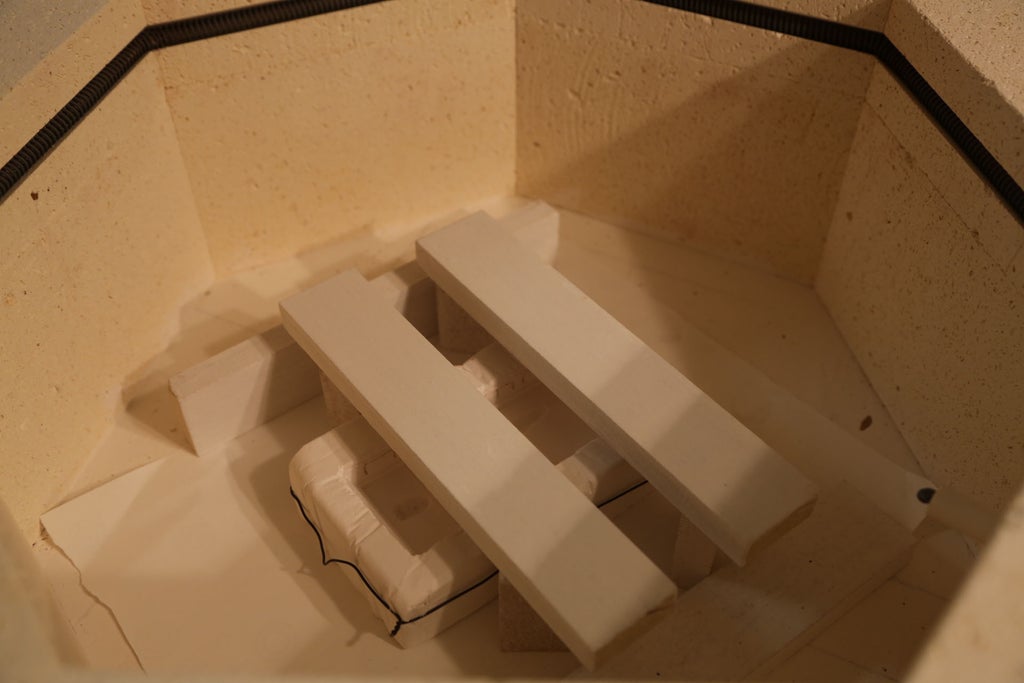

Now place two more dam walls as support for the terracotta pot across the length of the dam you just built.
![](https://content.instructables.com/FRM/SD6E/H703O9B9/FRMSD6EH703O9B9.jpg?auto=webp&fit=bounds&frame=1&height=1024&width=1024)

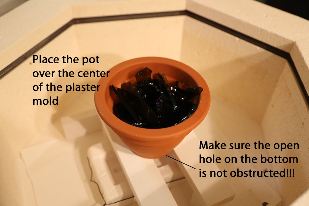

Place the terracotta pot upon the two supporting dams without obstructing the drainage hole in the bottom of the pot. The hole should align with the cavity of your plaster mold. Make any necessary adjustments to stabilize the structures and to align the pot and mold.
![](https://content.instructables.com/F31/CAGJ/H703O9BA/F31CAGJH703O9BA.jpg?auto=webp&fit=bounds&frame=1&height=1024&width=1024)

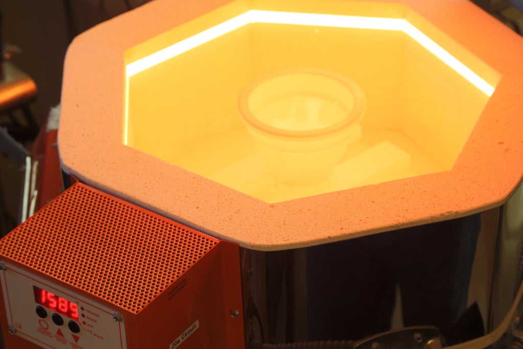

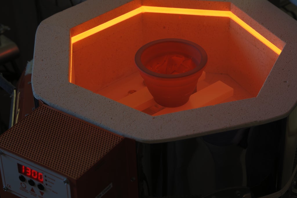

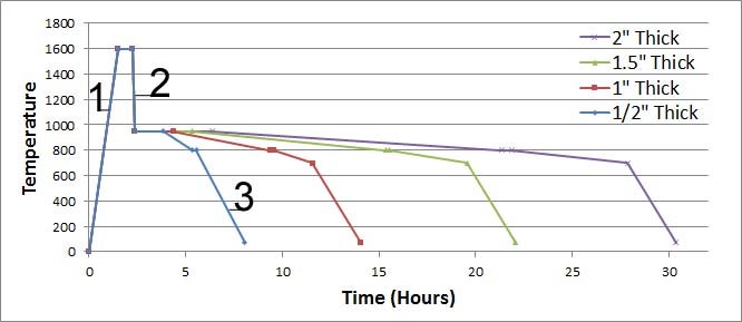

The following chart describes the firing schedules for the glass casting and was derived from the System96 website describing the annealing time necessary for S96 glass. Glass from wine bottles may be similar and therefor this chart makes a sufficient approximation of the required firing schedule. Depending on the thickness of your casted model you will need to follow a specific schedule. I chose to follow a firing schedule for the 0.5" thickness. These schedules may be overly conservative but I'm more confident about producing successful results with a slower process.
Some important notes for the chart include:
![](https://content.instructables.com/FKL/U98N/H6S41F1U/FKLU98NH6S41F1U.jpg?auto=webp&fit=bounds&frame=1&height=1024&width=1024)

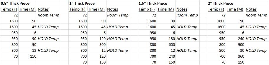

I have also included the following tables to help program a digital kiln controller if you are lucky enough to have one.
![](https://content.instructables.com/FW2/0G0K/H6S41F2K/FW20G0KH6S41F2K.jpg?auto=webp&fit=bounds&frame=1&height=1024&width=1024)

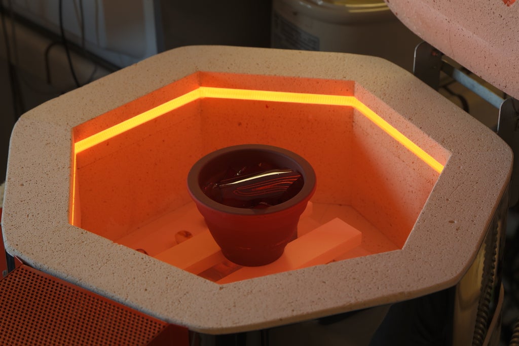

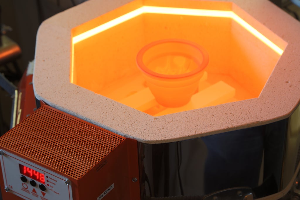

At its hottest temperature the glass will be molten and glowing (just like the title says.) You can peak into your kiln to take a look but only if you have good ventilation and have adorned adequate protective gear. This includes safety glass, and temperature resistant gloves specifically designed for working with hot glass.
![](https://content.instructables.com/FLB/OWWX/H71Y62AG/FLBOWWXH71Y62AG.jpg?auto=webp&fit=bounds&frame=1&height=1024&width=1024)
![](https://content.instructables.com/F9D/I18X/H71Y623F/F9DI18XH71Y623F.jpg?auto=webp&fit=bounds&frame=1&height=1024&width=1024)
![](https://content.instructables.com/FSU/TOLU/H71GP3F4/FSUTOLUH71GP3F4.jpg?auto=webp&fit=bounds&frame=1&height=1024&width=1024)
If there is not enough glass accumulated in the mold by the end of the 1600 degree hold cycle you will need to increase the time spent at this temperature. There will always be some glass remaining in the bottom of the pot so don't try to empty it all out.
Once you have programed your kiln (assuming you have a digital kiln controller) kick off the heating cycle and move on to the next step....
- The first labeled segment is full-heat (as fast as possible) to 1600
- The second labeled segment is full-heat (as fast as possible) to 960
- The third labeled segment is turning off the kiln and allowing the object to naturally cool to room temperature (assuming you have a firebrick kiln, not fiber.)
![](https://content.instructables.com/FXZ/QH3X/H71Y62AD/FXZQH3XH71Y62AD.jpg?auto=webp&fit=bounds&frame=1&height=1024&width=1024)
