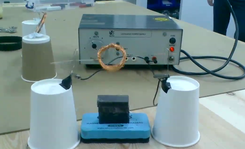

Step 1: Construct a Base
Using two different objects with the same height, in my case two paper cups, construct a base where you can then use the electrical tape your paper clips onto it to hold the copper wire.

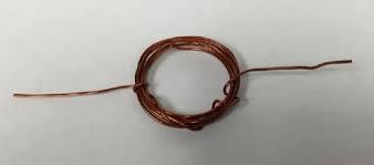

Step 2: Create Your Copper Coils
Using a cylinder like object, wrap your copper wire around it until looks like the image above, with the two end bits coming out the side.
Step 3: Sanding
Sand one end until it is completely sanded, then lightly sand the other side.
Step 4: Add Your Copper Coils to Your Base and Place the Magnets Underneath
Now that you have finished your copper coil, balance it in between your paper clips and then place a magnet underneath. It should look something like this image above.
Step 5: Connect It to a Power Source
All you now need to do is connect your DC motor to your low voltage power source, and you should be ready to go! If it isn't managing to continuously spin, this could be due to multiple different factors, such as your coils are to heavy, your coils weight is not centred, or you simply have too little or too much voltage power.
