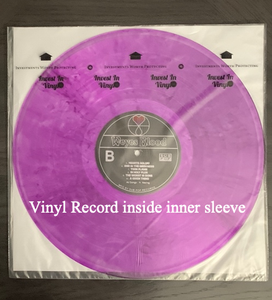

·      Record Inner Sleeves (Fig 1)
The one I recommend: Invest In Vinyl Rice Paper Anti-Static Inner Sleeves

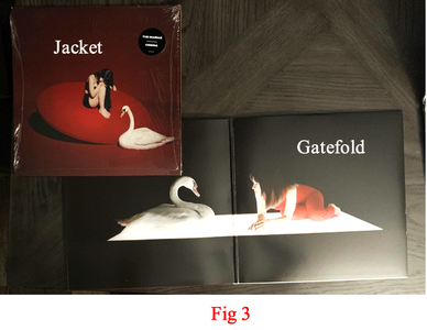

·      Jacket: The cardboard casing that houses the vinyl record and sleeves. Often has the album cover and track list on the cover. (Fig 2, 3)
·      Sleeve: The casing that houses the vinyl record. (Fig 2)
·      Vinyl Record: The circular disk with grooves. This allows a tonearm to read the grooves and play music. (Fig 2)
·      Gatefold: A type of jacket that opens like a book. Art from the album is usually displayed inside the gatefold. It sometimes has credits and lyrics as well. (Fig 3)

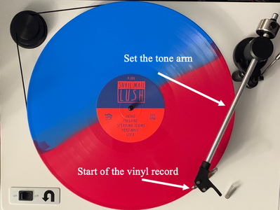

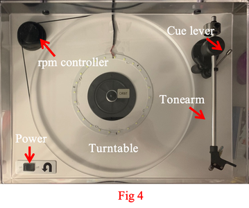

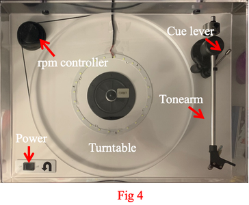

·      Turntable: The spinning platter with a knob located on the record player. This is where you place the vinyl record so it could be spun. (Fig 4)
·      Tonearm: The pole with the needle at the end. The tonearm’s needle gently rides the grooves as the vinyl spins and transcribes the grooves to soundwaves. That’s how a record player reads a vinyl. (Fig 4)
·      Cue Lever: A mechanism that controls the height of the tonearm. When the cue lever us up, this allows the tonearm to freely move around without disruption. When the cue lever is lowered, it lets the tonearm fall so the tonearm can follow the grooves. Some record players might not have a cue lever. (Fig 4)

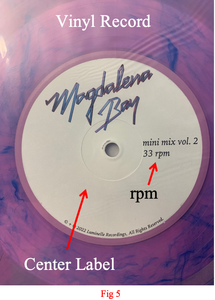

·      rpm: rpm stands for “Revolutions Per Minute”. For most modern records, the rpm is either going to be 45 rpm or 33 rpm. This informs you the spin speed that the turntable needs to be to hear the vinyl record correctly. (Fig 5)
·      Center Label: The center label is the circle paper label on the center of a vinyl record. This center label holds information on which side is being played, the rpm, the album name, and more. (Fig 5)

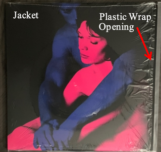

Step 2: HOW TO PLAY a NEW RECORD: Opening the Plastic Wrap
Open the new vinyl on the side where the lip of the jacket is located.
Note: Most new records are wrapped in plastic. For the longevity of the records, I like to just cut the plastic wrap where the opening of the jacket is located. Keeping the plastic wrap on the record allows another barrier from dirt, dust, wear, and tear. This is ideal if the vinyl record is not a gatefold. It is okay if you don’t want to keep the plastic wrap.

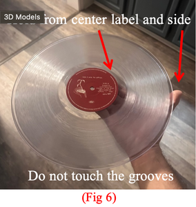

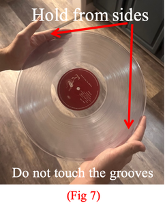

Step 4: HOW TO PLAY a NEW RECORD: Holding/Placing Vinyl Records
Remove the record from the record sleeve. Place the record on the turntable (Fig 8). It is important that you hold the record safely (Two ways noted in Fig 6 and 7).

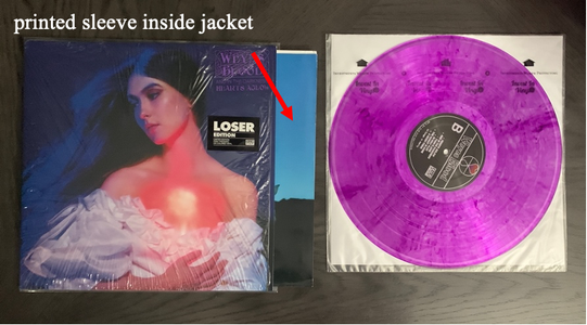

Step 5: HOW TO PLAY a NEW RECORD: Return/Dispose Given Inner Sleeves
Return the record sleeve back into the jacket if the sleeve is printed.
Note: If the record sleeve is just a plain sheet of paper with no art on it, it is recommended to recycle the sleeve. These paper sleeves are not great at housing vinyl records. This is due to micro paper particles being left on the record when slipping the vinyl in and out the sleeve. Over time, these particles can end up scratching your record, which will affect the record’s longevity. If the record sleeve is plastic, this can replace the inner sleeve that will be used later. Keep the plastic record sleeve out for later use.
Step 6: HOW TO PLAY a NEW RECORD: Turn On, Spin, and Speed Settings
Turn on the record player so the turntable is spinning and set it to the correct rpm (check player manual to fix rpm/spin the turntable). Rpm can be found on the center label (Fig 5).
Note: Sometimes, the rpm is missing from the vinyl record. Most records spin at 33 rpm (Sometimes noted as 33 1/3 rpm, though it’s the same as 33 rpm). Other records, mostly 7-inch records, spin at 45 rpm. If the record sounds slower or faster, chances are that the rpm is not set correctly. No damage will be done to the record, it just affects how the record sounds.

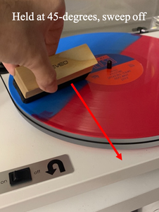

Step 7: HOW TO PLAY a NEW RECORD: Using a Cleaning Brush
Use a cleaning brush to wipe away any dirt, grime, or other debris off the record surface.
Note: A cleaning spray is optional. It is recommended to spray the cleaning solution on the brush itself so no damage to the center label is done. Hold the cleaning brush at a 45-degree angle, let the vinyl rotate around, and slowly brush away the dust in one sweep. Repeat if necessary.

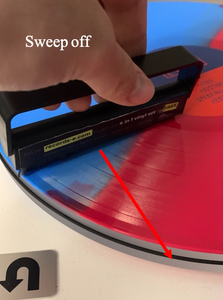

Step 8: HOW TO PLAY a NEW RECORD: Using an Anti-Static Brush
Use the anti-static brush to lower the static on records.
Note: Most new records will have static. This is normal. Over time, the static will dissipate once the record is housed in a proper inner sleeve and cleaned with the anti-static brush. Use same technique as the cleaning brush, but the angle of the brush does not matter for the anti-static brush.

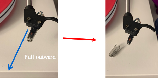

Step 9: HOW TO PLAY a NEW RECORD: Needle Cover Removal and Set Tone Arm
Remove the needle cover and set the tonearm at the desired location on the record.
Note: The record begins on the outer most rim. There are empty spaces in the grooves to signify the beginning of the next song. Use the track list to determine which groove section is your desired song and place your needle at that location. Some record players do not have a needle cover, which that step could be skipped.
Step 10: HOW TO PLAY a NEW RECORD: Lower the Cue Arm
If there is a cue lever, lower the cue lever and enjoy the music! (Fig 4)

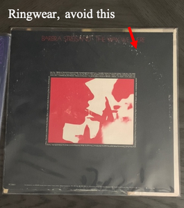

Step 13: HOW TO STORE a SINGLE VINYL RECORD: Sleeve Vinyl Records and Ringwear Warning
Put the vinyl record inside an inner sleeve. Repeat this step if there are multiple vinyl records.
Note: It is advised to keep the vinyl record outside of the jacket to prevent “ringwear”, which is a permanent outline of the vinyl record imprinted on a jacket. This can be seen mostly on older records. For longevity, it is best to prevent this wear and tear from occurring. So, to combat this, we place the vinyl record outside the jacket.

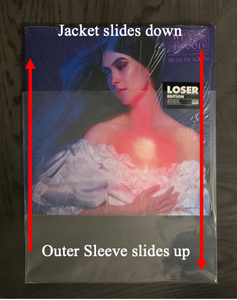

Step 14: HOW TO STORE a SINGLE VINYL RECORD: Place Jacket Inside an Outer Sleeve
Get an outer sleeve and slip the jacket inside the sleeve. The outer sleeve should have its opening on the top of the jacket. The opening of the jacket should not be able to be accessed when housed in the outer sleeve.
Note: The reason why we include an outer sleeve is to prevent normal wear and tear. This can occur when the jacket rubs against other records when sliding in and out of a collection area. The plastic sleeve will prevent that friction from occurring. We also have the opening of the jacket blocked by the outer sleeve to prevent warping of the jacket itself.

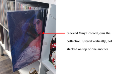

Step 16: HOW TO STORE a SINGLE VINYL RECORD: Return Vinyl Record to Collection
Return the sleeved record back to your collection. Assure that all records are standing vertically, not stacked on top of each other. This will prevent warping on the vinyl records.

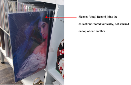

Step 22: HOW TO STORE MULTIPLE VINYL RECORDS: Return Vinyl Record to Collection
