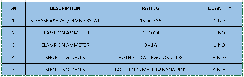

Material / Equipment's required for test is as listed in table.
Variac with high current rating is required to get proper CT secondary current in controlled manner to conclude the stability / instability present. If variac is not available, motor can be supplied from 3 phase 415V source.

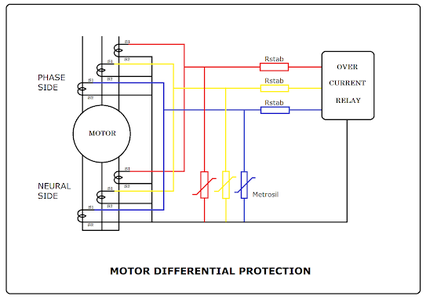

As shown in setup scheme above, Test voltage is applied in between 'Circuit breaker Cable Side' contact and 'Phase side' CT. AS previously mentioned, Test voltage can be injected through 3 phase variac or directly of source. Measurement points are marked in Capital Letters.
  • A, B, C : Input current to Motors in B, Y, R phases respectively
  • D, E, F : Phase side CT Secondary Currents of R, Y, B phases respectively
  • G, H, I : Neutral side CT Secondary Currents of R, Y, B phases respectively
  • J, K, L : Relay Current of R, Y, B phases respectively

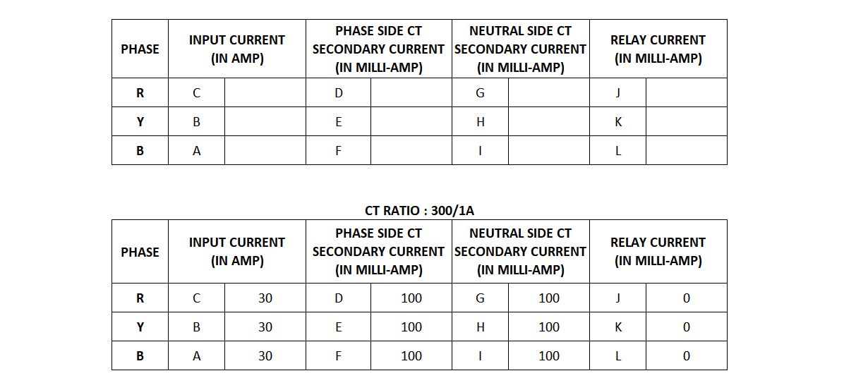

  5. Now, measure and note down currents at all point from "A" to "L".
  6. For CT of 300/1A ratio, CT secondary current will be 100mAmp in both sides of CT's and current through relay will be 0Amp.
Note Down Measurements
