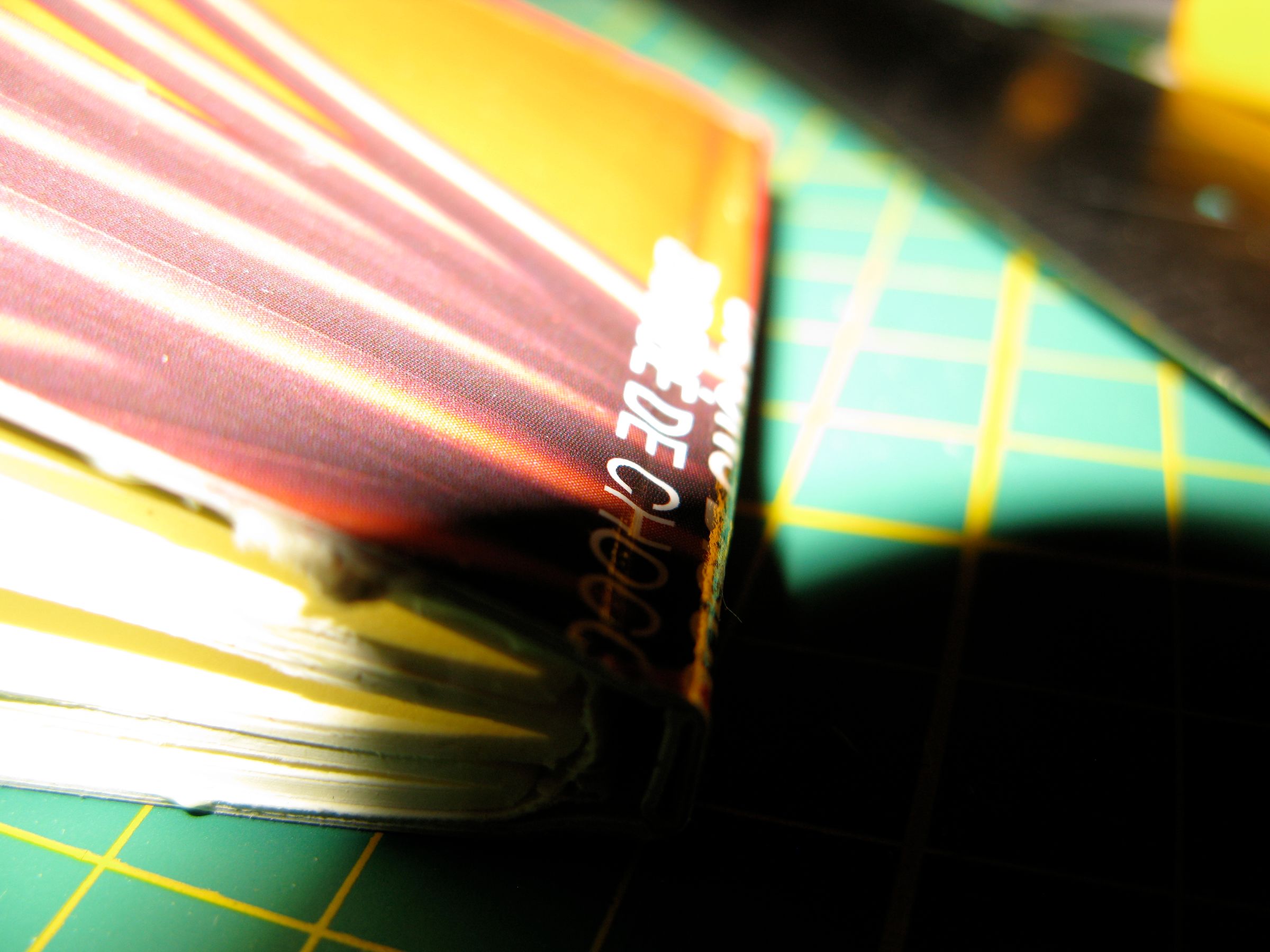

Step 4: The Cover
The book cover is the best part.
Take your cardboard of choice and cut it with the ruler and sharp knife, two strips 60mm X 120mm
Laminate these together using white glue. Keep in mind which side you want to face out.
After everything is dry enough( ten minutes or so) Mark the center line of the cover.
Measure the thickness of your 42 page booklet. It should be around 8mm, so draw lines 4mm off center. Use a butter knife to crease the cover along the lines.
Fold on the creases to form what looks like an empty book.
Step 5: Book to Cover
Attach the book to the cover.
Glue the outside of the book to the inside of the cover. When gluing leave a gap between the Spine of the cover and book.
make sure to glue everything square with each other.
Step 6: Trimming to Size
Once you are satisfied with how dry the glue is, it is time to trim it to size.
Use the ruler and knife again to trim the book by repeatedly cutting in the same line until cut all the way through.
