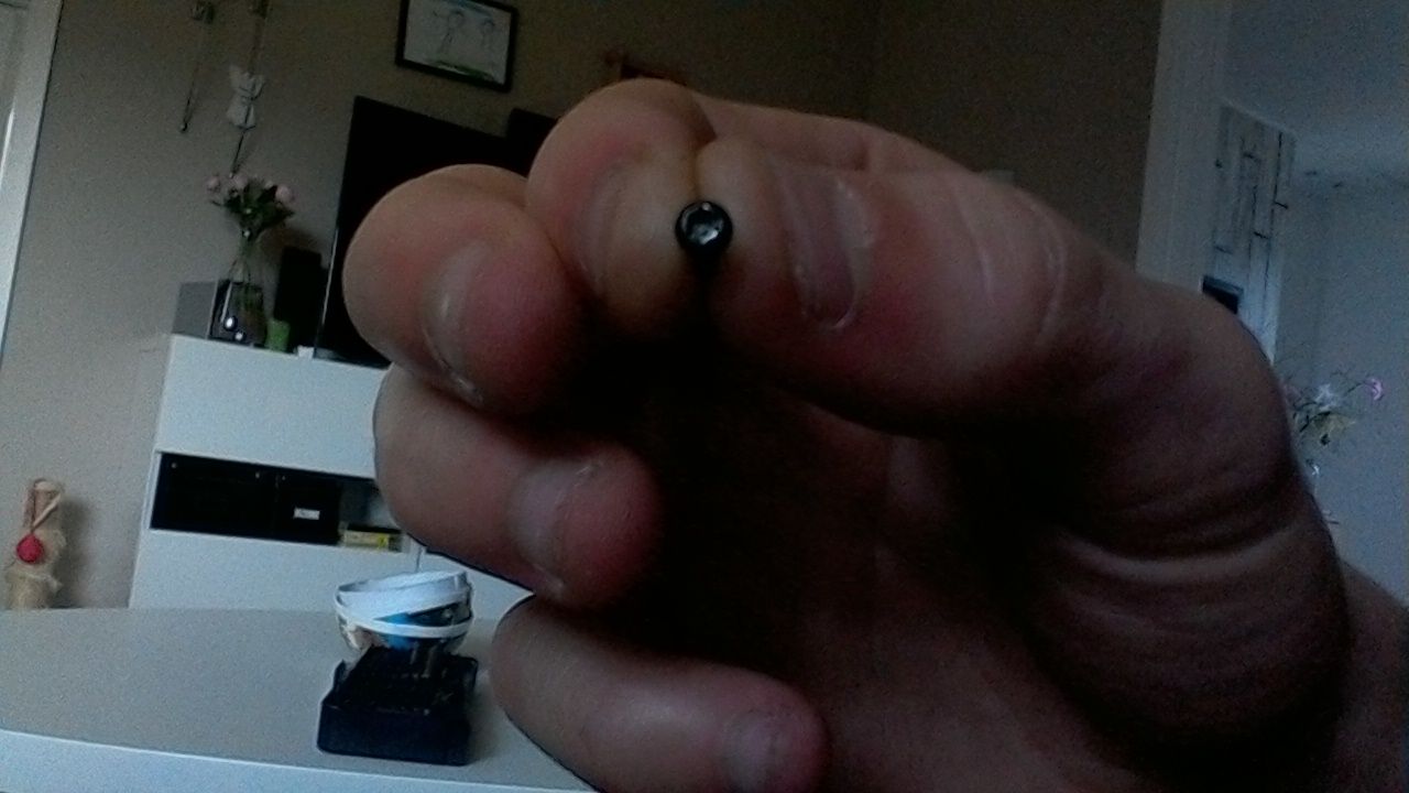

One thing. Just get a 2mm slotted (flathead) driver, preferrably electronics grade.
Step 2: Step One.
get your two millimeter slotted bit (flathead, whatever.) there are seven screws, including the HIDDEN SUPER DUPER BONUS SCREW!!!!
Step 3: How to Unscrew Them.
wedge the screwdriver as shown in the picture, and you can unscrew them easily. you gotta unscrew all of them, or it wont come apart.
Step 4: FINISHED!
You dont have to modify the screws, screwdriver, or go scearching for a custom screwdriver. helpful.

ya but what happens when the little thing sticking out of the screw in the middle brakes should i use a T8H screwdriver?
0
Roguecorp
Roguecorp
Reply 7 years ago
You can tilt the 2mm fkat head 45 degrees and gently unscrew it. Use a small hand towel on the screw driver handle to make it extra gentle. I know this is a 4 yrs latet reply. Just leaving the tip here for others
0
1337pino
1337pino
Reply 11 years ago on Introduction
I had a couple of mine break. I then switched to a 2.4mm flathead. If you can get it lined up with the middle, and you keep at it, it will come out.

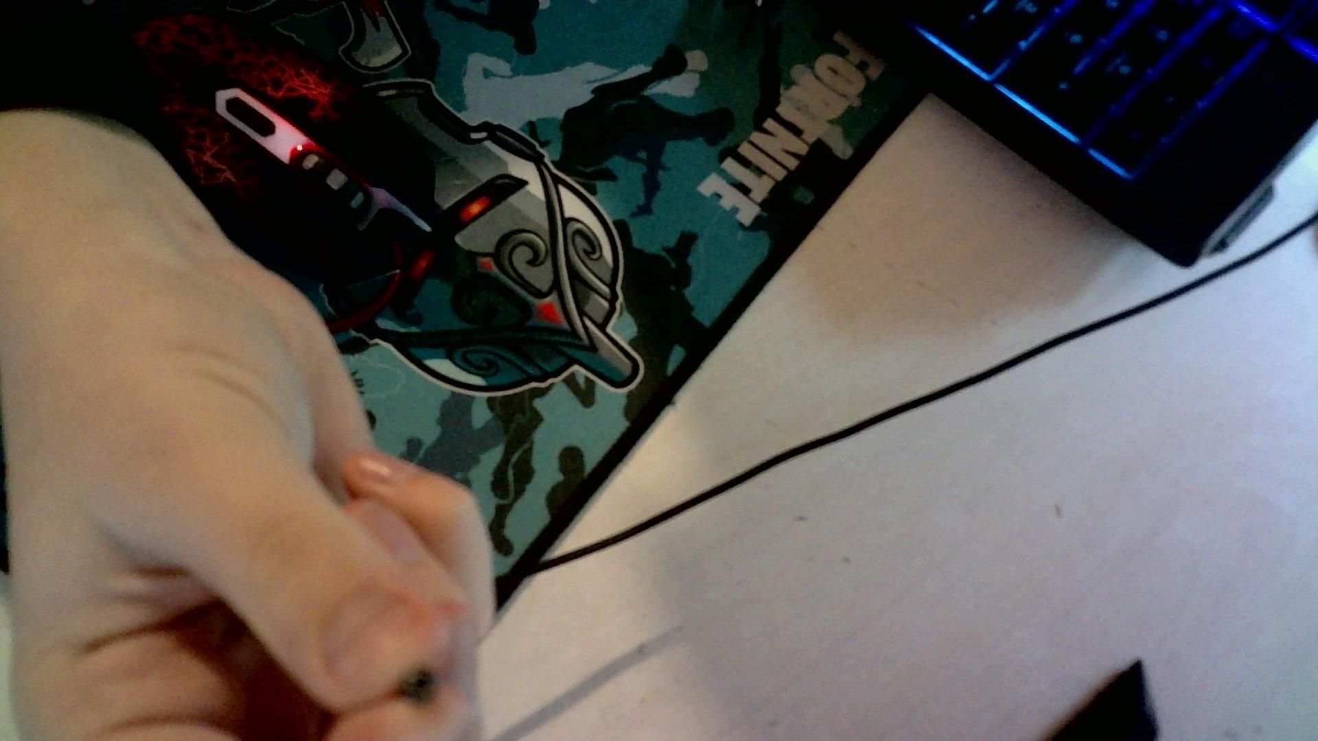

If you have pushed down the center button in the screw use a 5/64 Allen key and you should be able to get the screw out you may even be able to use the Allen key even if the screw is not pushed down I just did this yesterday so I know it works.
