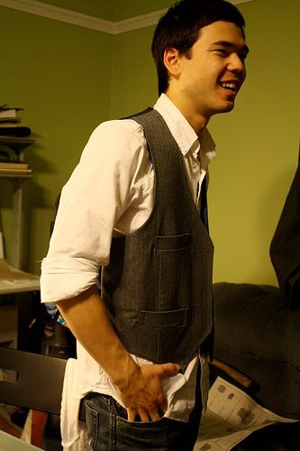

Introduction: How to Sew an Oh Sew Warm Vest!
{a sew warm contest entry!}
In this instructable, I'll show you how to sew the unisex vest pattern from Vogue, with a couple enhancements (real pockets, fleece lining). You don't need too much experience; this is how I taught myself how to actually sew (that archaeopteryx costume in 1st grade doesn't count; my mom did most of the work). If you don't know much about using patterns (as I didn't), continue reading! All you need to know is how to use the machine.
If you actually know how to sew, I welcome your comments on how I could have done this better, and also to correct any unorthodox techniques I might be using.
It's Oh Sew Warm, this vest!

Step 26: Admire.
Not only do you look snazzy, but you are wearing a warmer-than-normal dressy vest. Not only did you learn how to sew, but you made that vest! I'm impressed. Great job!
Thanks for reading! Please comment, and I hope I get your vote! (...as much as I love this 50 year old sewing machine... ;)
