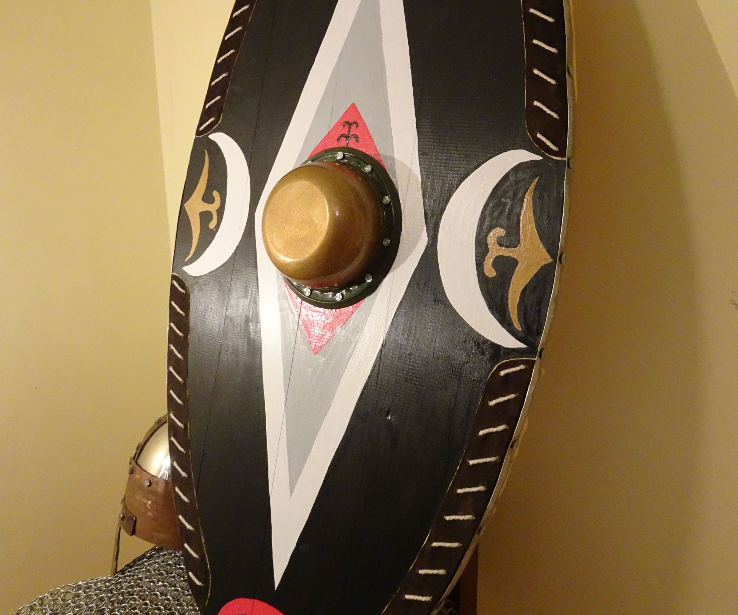

Hi! This is an celtic wooden hand carved shield that i've made myself.
The front of the shield is hand drawn and hand carved depicting two celtic dragons and other celtic symbols.
The diameter of the shield is 1000mm, thickness 25mm and approx 5kg. It is ideal for decorating rooms, sidewalks, cellars or for medieval parades, photo shoots, etc.
