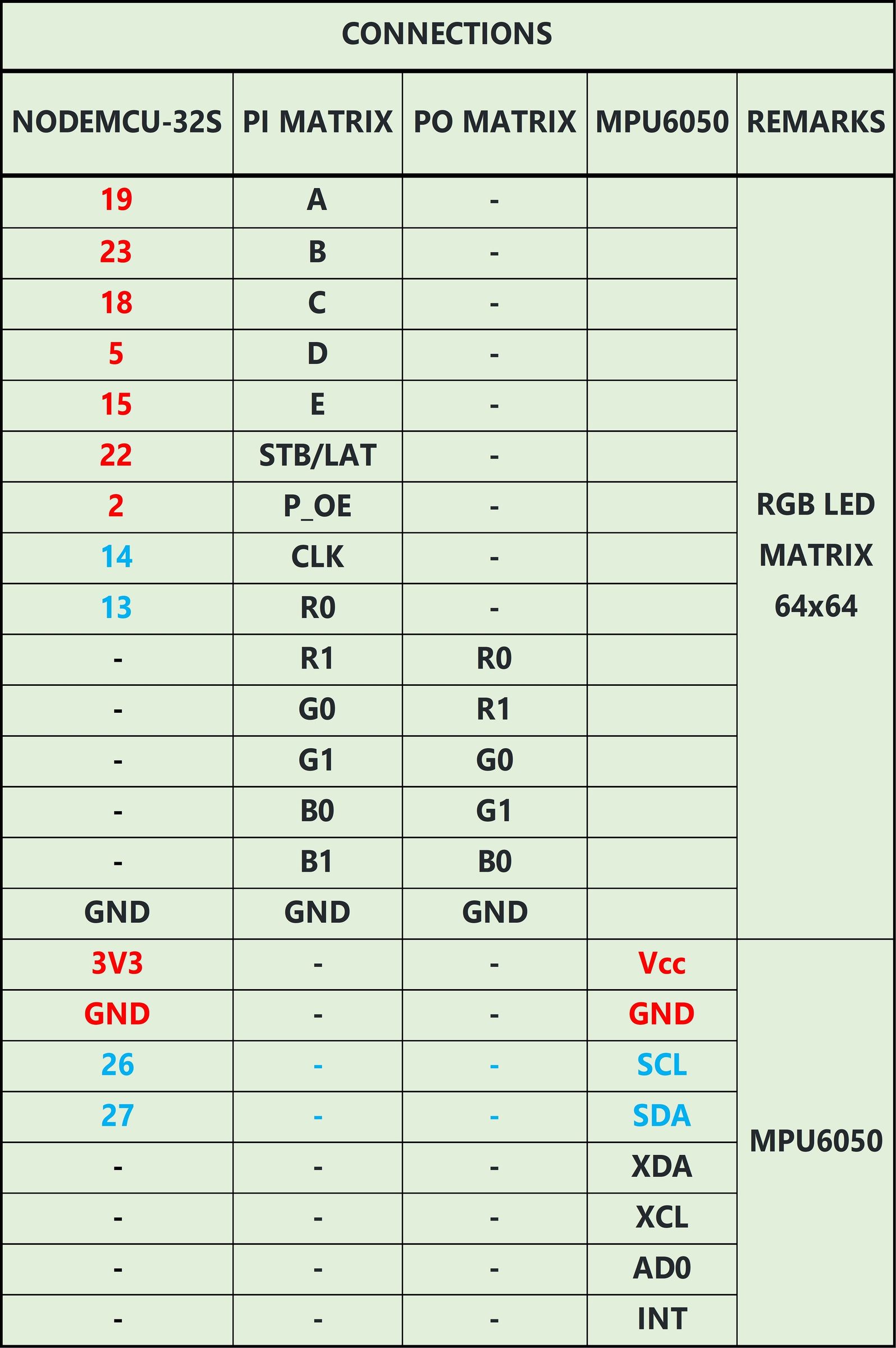

And the wiring diagram between ESP32 (NODEMCU-32S), P2.5 LED MATRIX 64x64 and MPU6050 are shown in the table below.

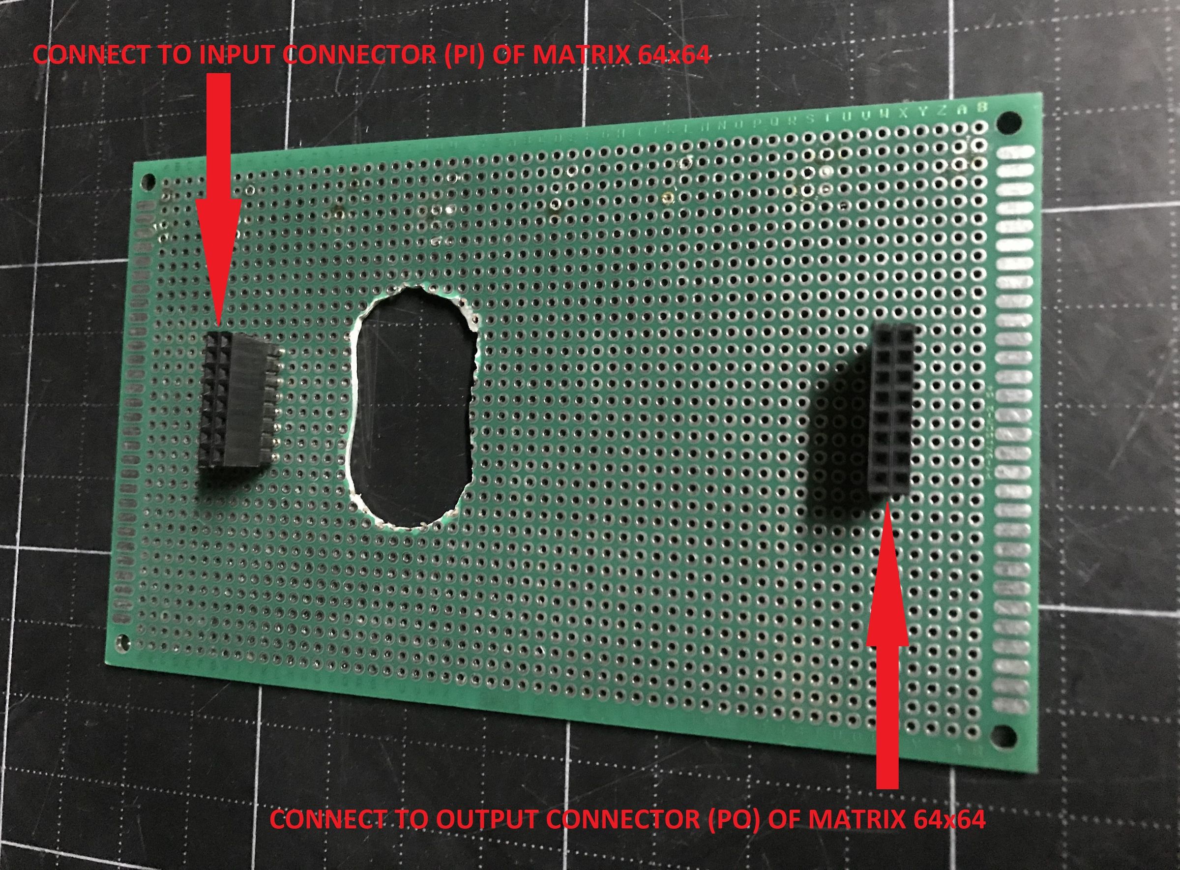

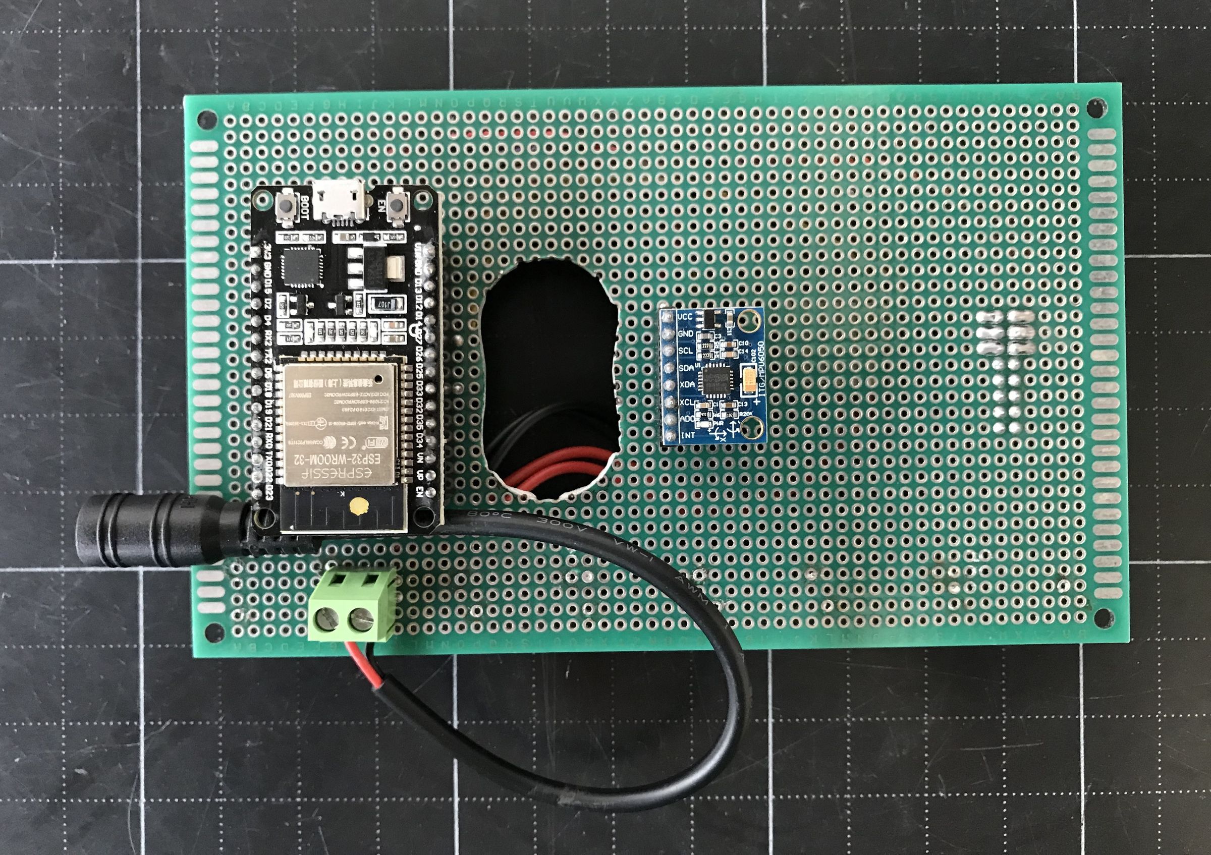

This P2.5 RGB led matrix 64x64 has a dimension Width x Length = 16 x 16cm. All the components, wires can be soldered on a double-side copper prototype PCB 9x15cm. With my instructable, after finishing soldering, we can plug this PCB into PI and PO of P2.5 RGB LED MATRIX 64x64, like a Shield. In the future, it have enough space to add some extra components on this PCB board.

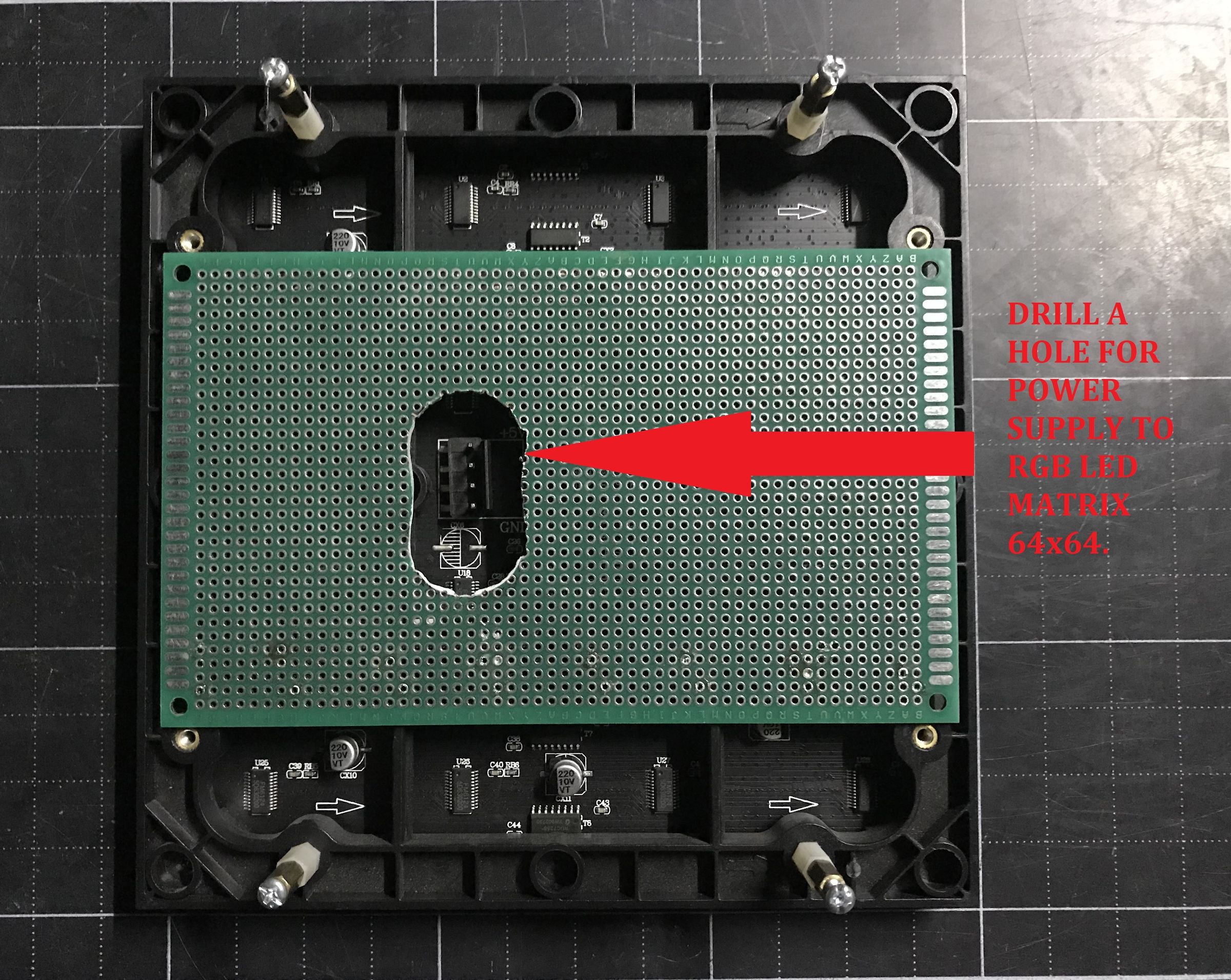

- Marking and drilling a hole on the Double Side Prototype PCB at the power supply position of the RGB LED Matrix

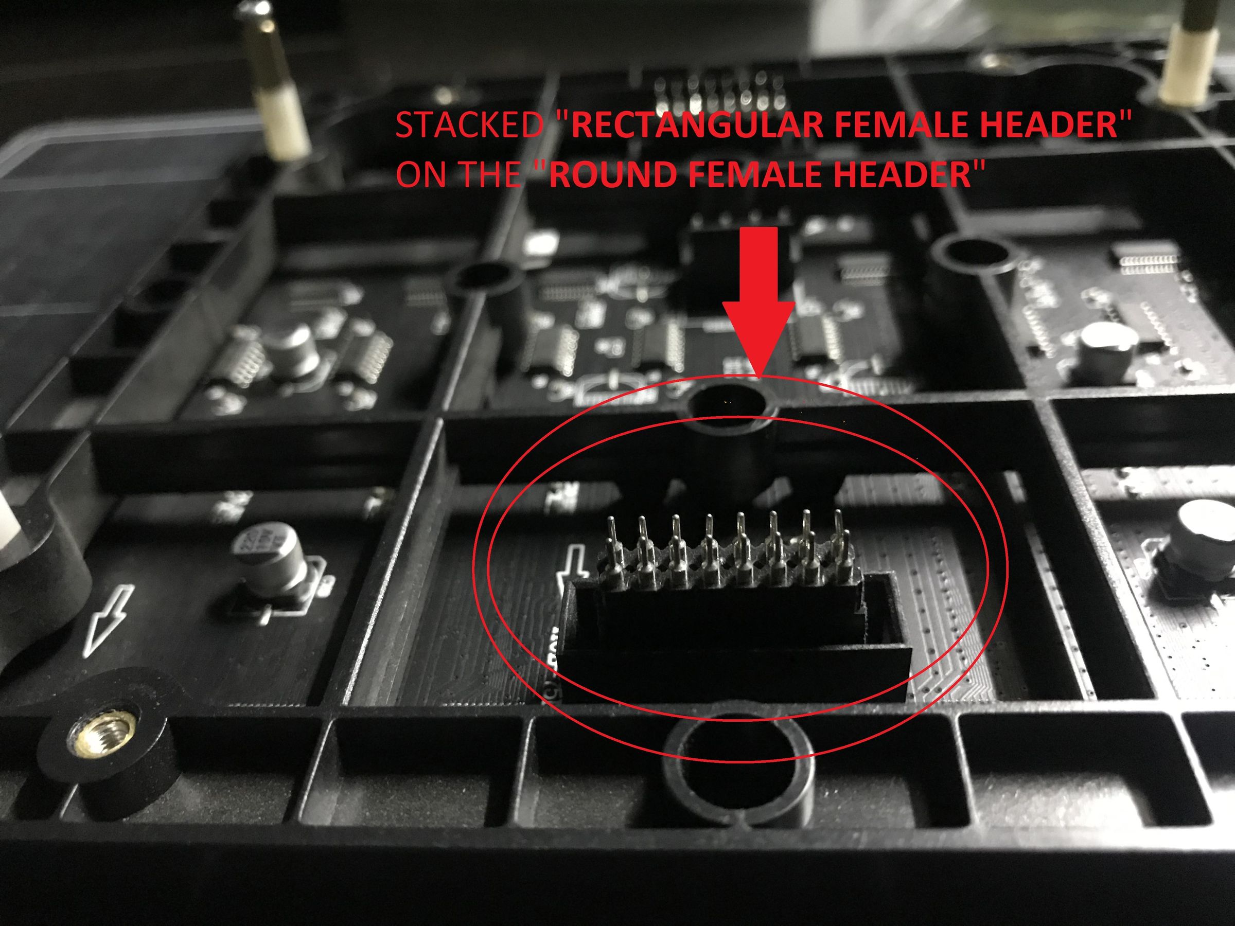

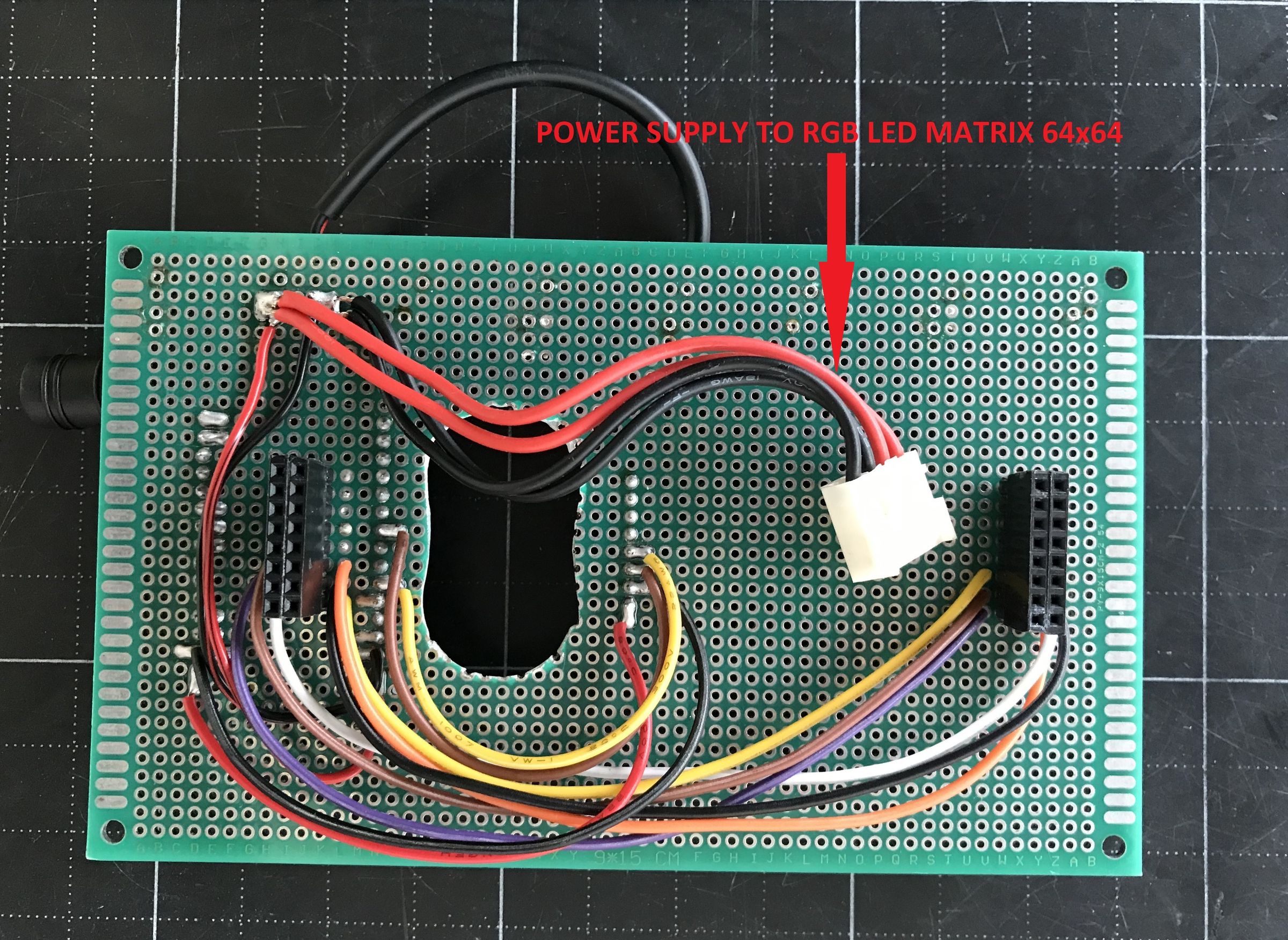

- Soldering female header at PCB bottom for connecting from ESP32 to Input Connector (PI) and Output Connector (PO) of RGB LED Matrix 64x64. Tip: In order for all wires can go through easily under PCB, I have stacked 8 pin "RECTANGULAR FEMALE HEADER" on the 8 pin "ROUND FEMALE HEADER". After soldering, we can use super glue to attach them tightly together.

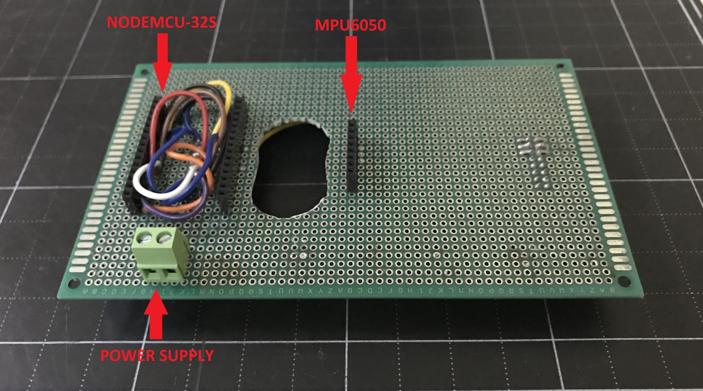

- Soldering female headers at PCB top for NODEMCU-32S and MPU6050, then soldering the circuit following the previous step
*** TOP view of PCB after soldering
*** BOTTOM view of PCB after soldering

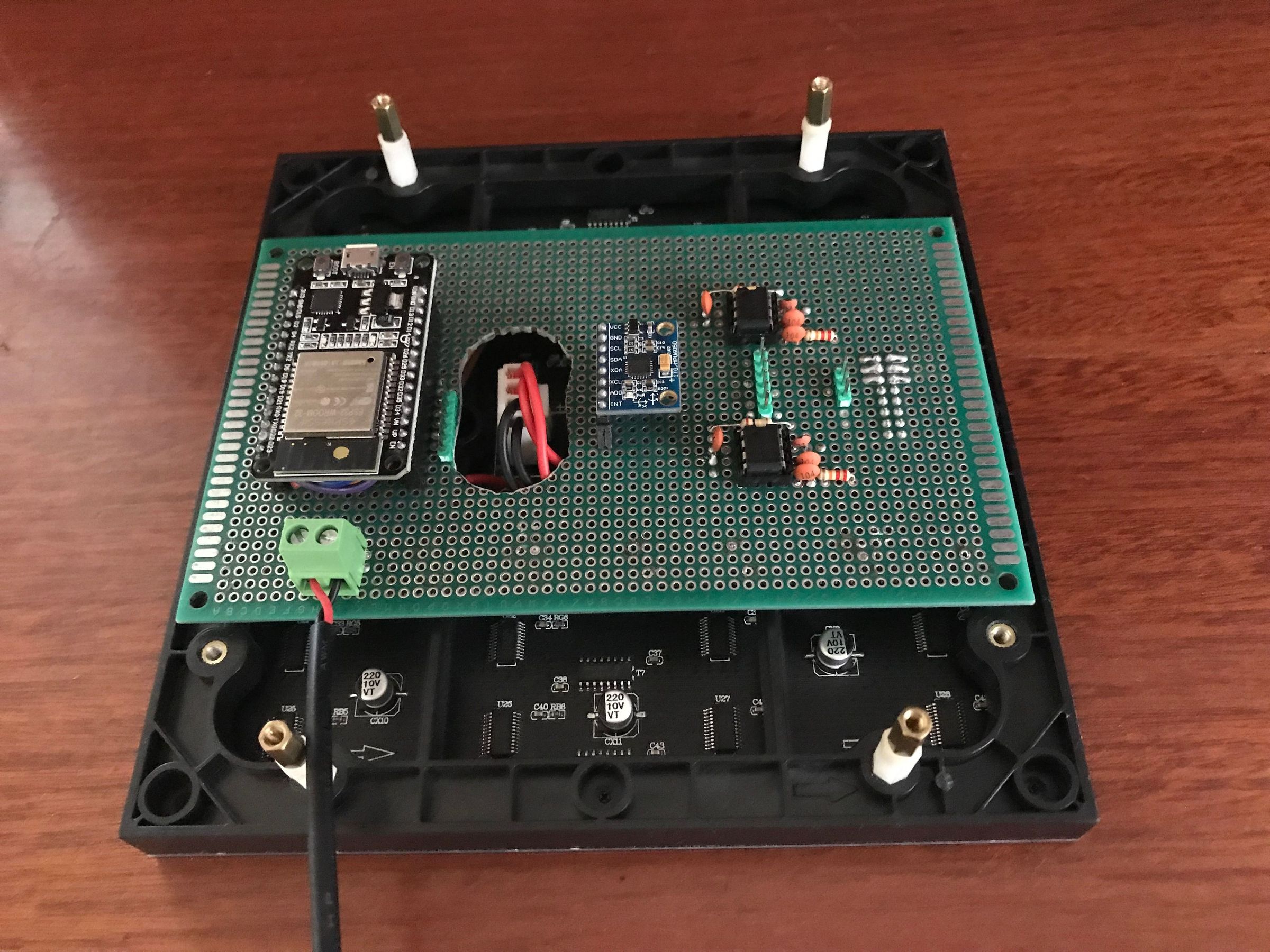

- Plug NODEMCU-32S and MPU6050 on the PCB
- Plug PCB female headers to Input Connector (PI) and Output Connector (PO) of RGB LED Matrix 64x64, then plug 4 wires power supply from PCB to led matrix.

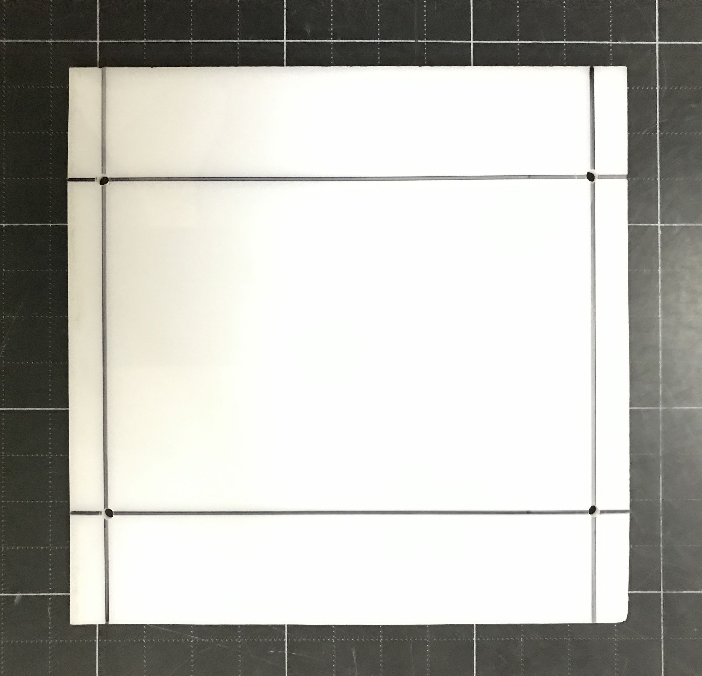

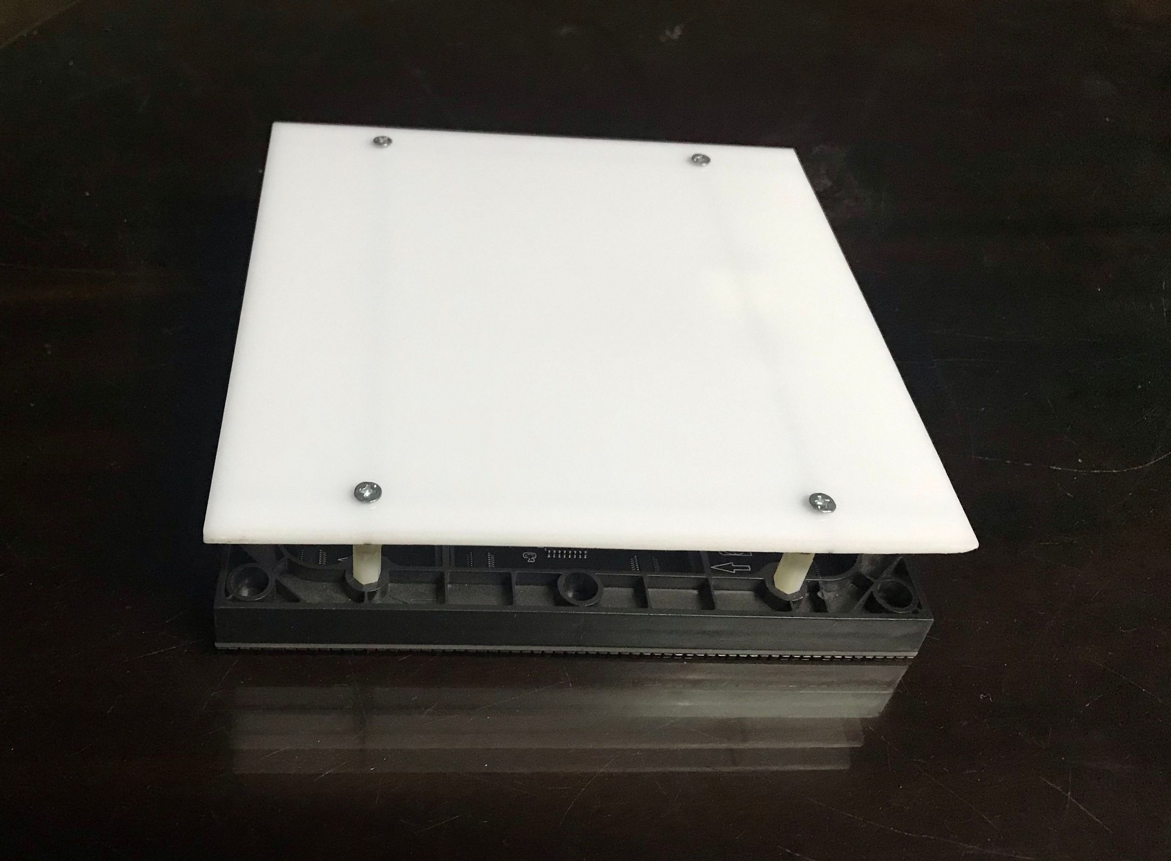

- Cover the back side of RGB LED Matrix by White Acrylic Plate

- MPU6050 connect to ESP32 NODEMCU-32S by following pins:
*** SDA (MPU6050) - GPIO27 (NODEMCU-32S)
*** SCL (MPU6050) - GPIO26 (NODEMCU-32S)

- We can add some more components on 9x15cm PCB, specifically, I soldered 2 x MSGEQ7 for adding 2 channels spectrum analyzer function to the led matrix board. It's great, I can play on this led matrix in my free time.
