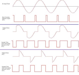

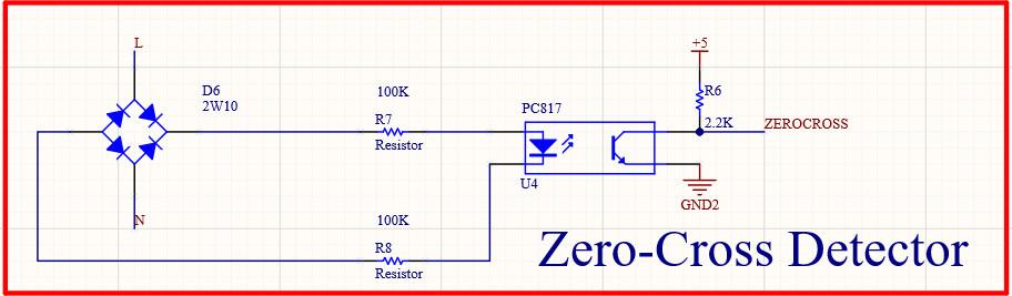

As you probably know, the output of TRIAC is based on zero-cross detection and firing angle. Let's look at the zero-cross detection circuit (Uploaded Image).
Whenever the input of bridge diode goes over a few volts, the optoisolator goes active so the output will be zero. And when it goes near zero, the outcome of PC817 will be high. With this method, we can detect whenever a signal comes to zero. However, the output of optocoupler is not square exactly, especially when the transistor is in the border of cut-off and saturation. To solve this, I passed the output of PC817 from 7414, which is a Schmitt trigger. Also, as the signals pass from a flat cable, it is vulnerable to noises. Using a Schmitt trigger with capacitors can help to neutralize these noises and get a pure square output. At last, I fed the output of Schmitt trigger to the microcontroller. After detecting zero crosses, we have to trigger TRIAC's gate after a delay which is related to the frequency of the input signal. The higher the delay, the lower the power.

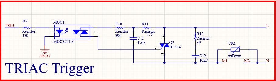

In my country, the power line is 220V/50Hz. So the period will be 20 mS. And the halfwave period will be 10mS. To control the output power, you have to trigger TRIAC'S gate with a delay of 0 to 10ms after zero-cross detection. To make that delay, I configured timer with 100uS steps. So if the counter counts to 100, the output delay will be 10000uS which is 10mS. On 10mS the output power is zero, and on 0mS the output power is at its highest(input wave goes out directly). So the steps of power control with TRIAC is: 1- detection of zero-crossing 2- wait between 0-10ms based on user input and trigger the TRIAC's gate after that. For triggering, I used the MOC3021 TRIAC gate driver. Moreover, as the load is conductive, I used snubber and varistor to eliminate noises.
