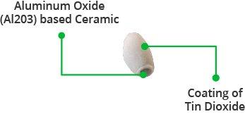

When the outer mesh is removed, the sensor’s internal structure is revealed. It consists of a star-shaped sensing element and six connecting legs extending from a Bakelite base. Two of the leads (H) are responsible for heating the sensing element and are connected by a Nickel-Chromium coil, which is a well-known conductive alloy.
The remaining four leads (A and B) are signal-carrying leads connected to the sensing element with platinum wires. These wires are linked to the body of the sensing element and detect slight variations in the current flowing through the sensing element.
The tubular sensing element is made of Aluminum Oxide (Al2O3) based ceramic and is coated with Tin Dioxide (SnO2). The Tin Dioxide coating is the crucial material as it is highly sensitive to combustible gases. The ceramic substrate enhances heating efficiency and ensures that the sensor area is consistently heated to its operating temperature.
In summary, the MQ2 gas sensor’s internal structure consists of a Heating System comprising a Nickel-Chromium coil and an Aluminum Oxide-based ceramic, and a Sensing System consisting of Platinum wires and a Tin Dioxide coating.

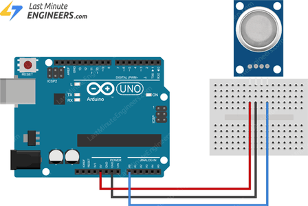

Wiring
Let’s proceed with connecting the MQ2 gas sensor to the Arduino.
First, link the VCC pin of the sensor to the Arduino’s 5V pin, and then connect the GND pin to the Arduino’s Ground pin. Lastly, establish a connection between the A0 output pin of the module and Analog pin #0 on the Arduino.
Please refer to the following diagram for the wiring setup.

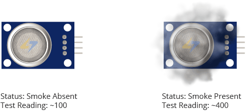

Upon running the sketch, you should observe readings similar to the examples below:
  • In the absence of smoke/gas (around 100)
  • In the presence of smoke/gas (around 400)
This test may require some experimentation and adjustment. Once you have obtained the readings, you can utilize them as a threshold to trigger specific actions.
