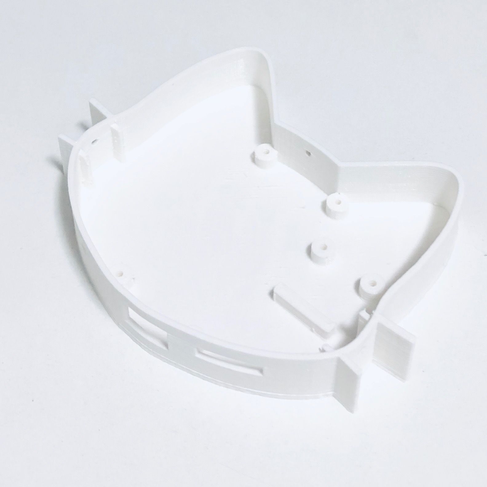

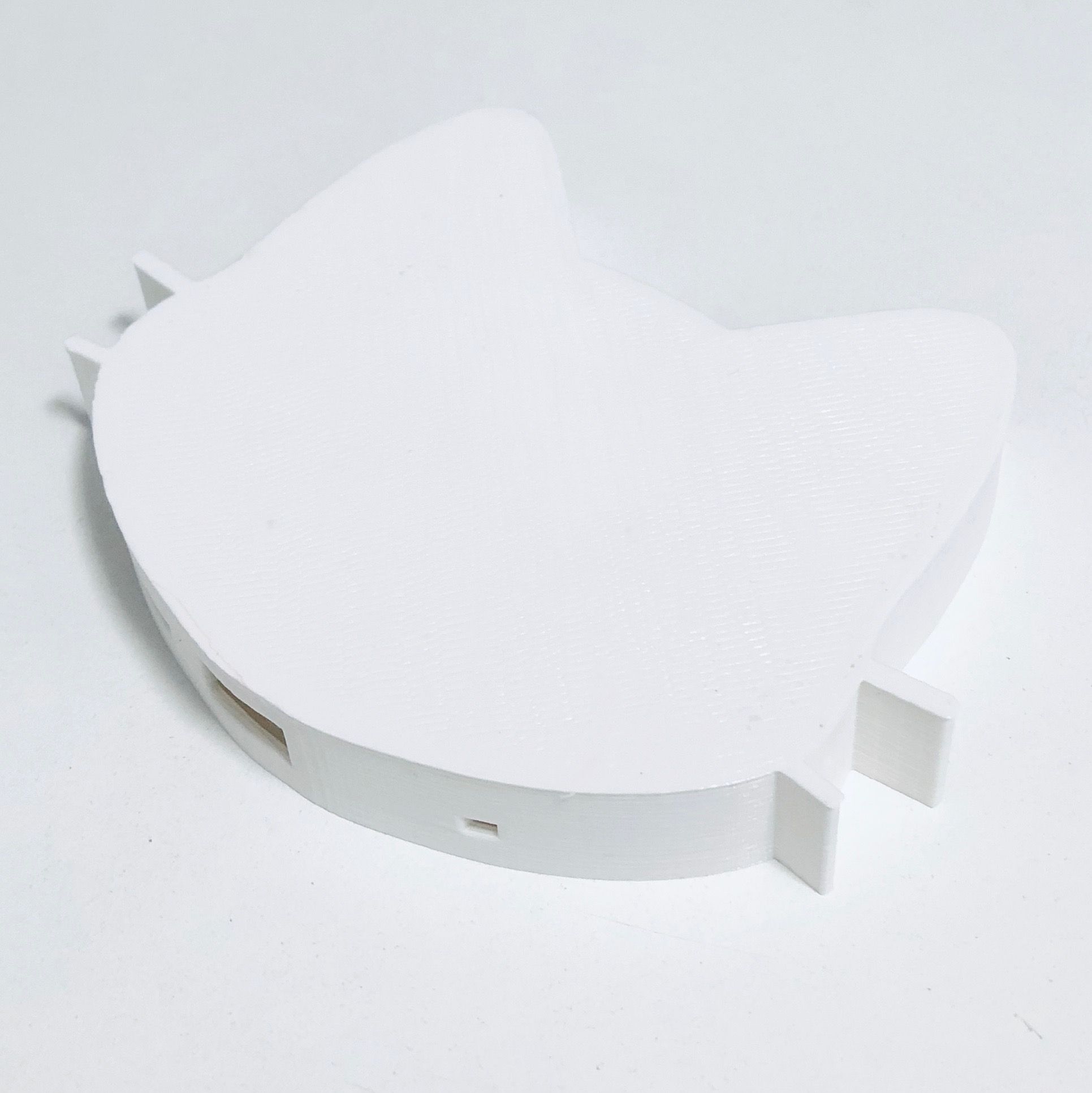

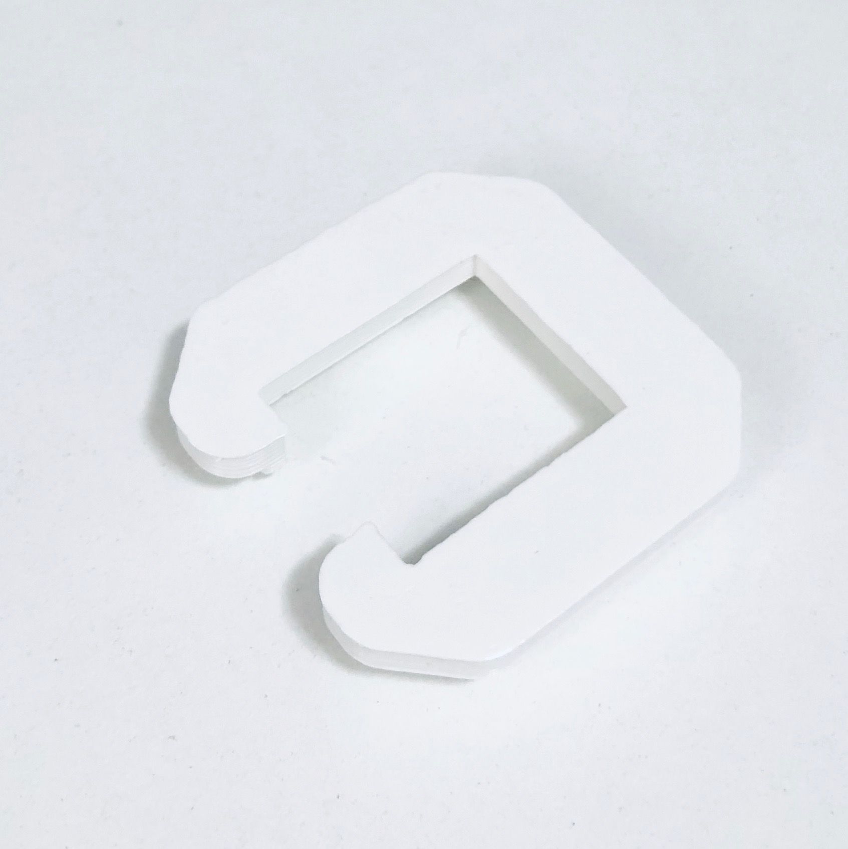

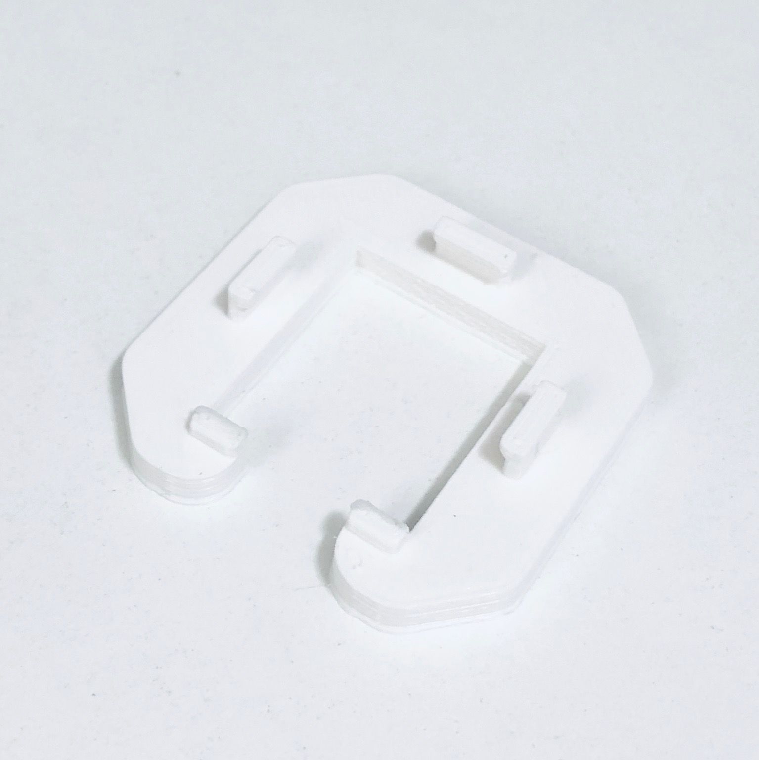

- 3D printer (link / link / link). It was used for printing the case where the electronics are encloused.
- PLA filament (link / link / link) of any color you want.

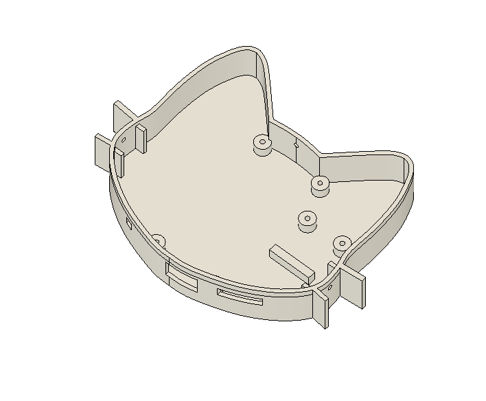

Step 6: 3D Modeling
3D printing was used to make some of the parts in this project. Of course the litter box itself was bought in a normal pet shop. However, some custom parts had to be designed and printed to allow the electronics to be added to the litter box.
All parts were designed using Fusion360 CAD software.
The following parts were designed:
- Supports for the load sensors: the load sensors are embedded inside four supports on the box feet. Such brackets allow the installation / removal of the sensors..
- Case: the case protects the electronic components from physical contact. The case is designed to be installed in the box using double-sided adhesive tape, thus allowing the case to be subsequently removed (for cleaning the case, for example).
- Case cover: allows frontal closure of the case, protecting electronic components.

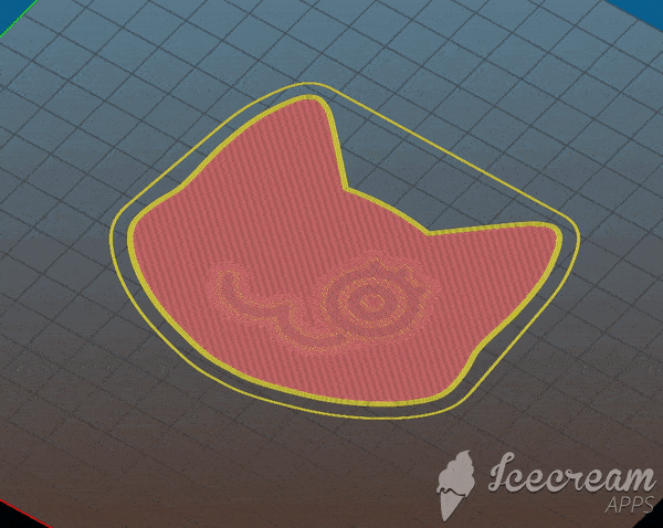

Step 7: 3D Printing
You can download all the stl files on the following websites:
https://www.thingiverse.com/thing:3737074

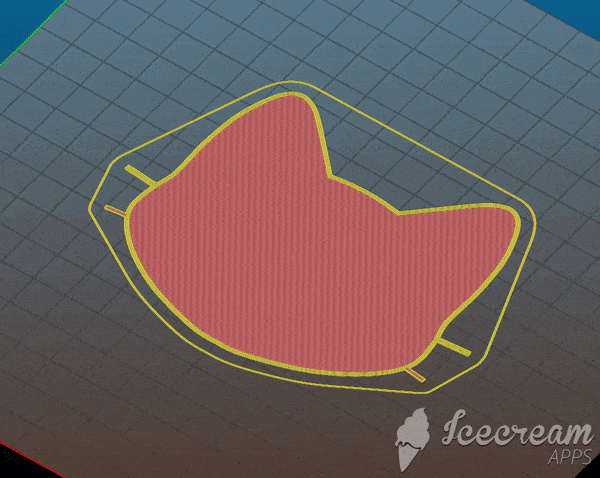

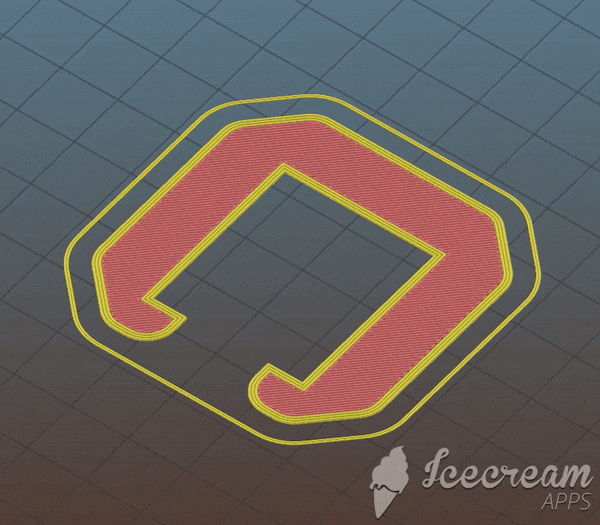

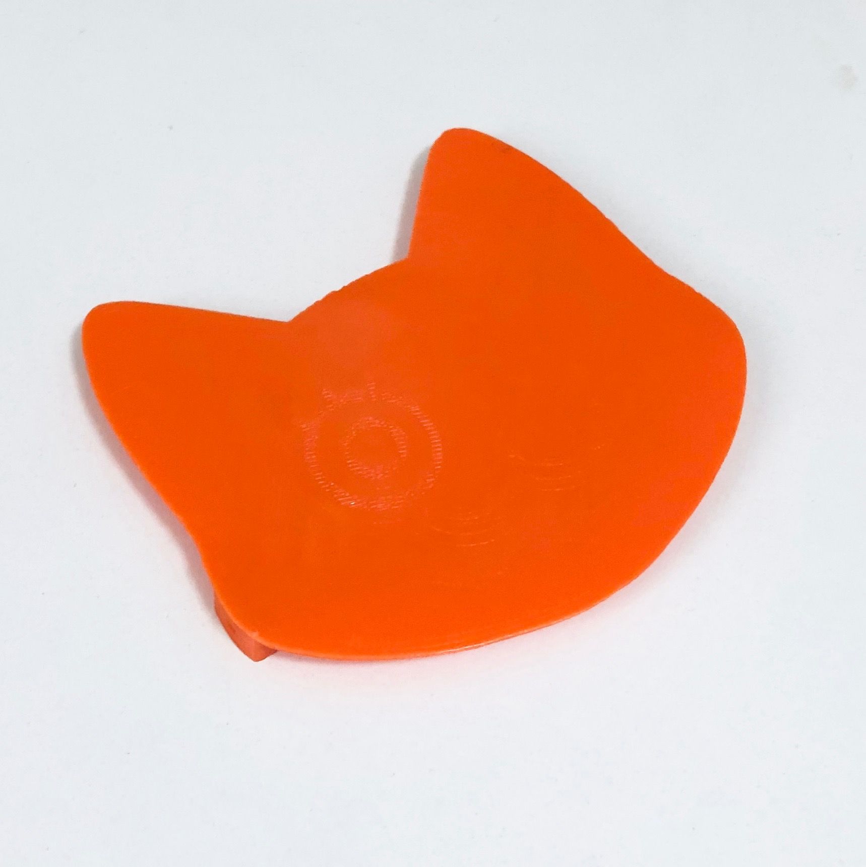

I printed the whole structure in PLA, usign two different colors. The whole print took me around 5h, using 0.2 mm resolution and 10% infill. No supports needed. This is a experimental prototype. Notice that it was designed for a given ESP32 dev board model (the ESP32 Firebeetle).
Sensor pad:
Case:
Front cover:
If you don't have a 3D printer, here are some things you can do:
- Ask a friend to print it for you;
- Find a hacker/maker space nearby. The parts used in this model can be printed quickly. Some hacker/maker spaces will only charge your for the materials used;
- Buy your own 3D printer. You can find the Creality Ender 3 for only $169.99! Get yours at https://rebrand.ly/3Dprinter-GB
- Improvise! You can try to assemble a structure without 3D printed parts.
