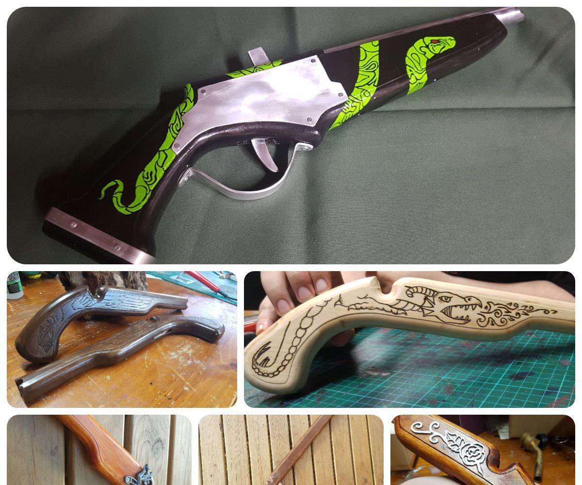

This is a tutorial designed to work in conjunction with this instructable, and outlines the simple process for making your own exercise/surgical tubing bands, that are designed to be fired with a RBG or Rubber Band Gun for LARP or hobby purposes.
If you're looking for information on how to make your own RBG, or more information on what LARP is, check out the link!
