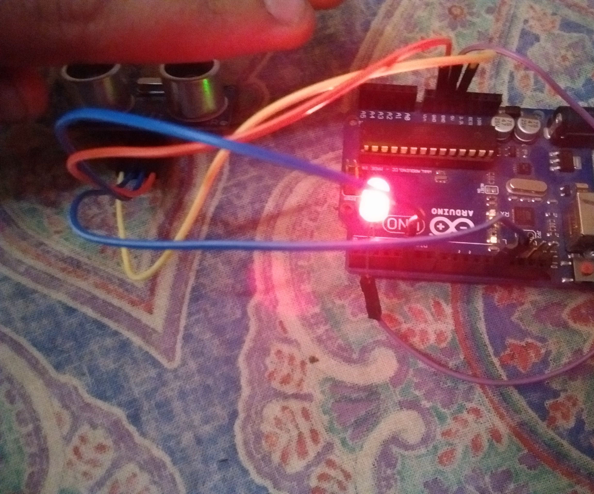

Step 5: Working Description
The attached photos and an embedded video of the working control system is uploaded.
The intensity of light varies when the hand gets closer to the ldr until it reaches max value(255) for the led and decreases upon removal of hand slowly from above of the ldr as shown in video.
