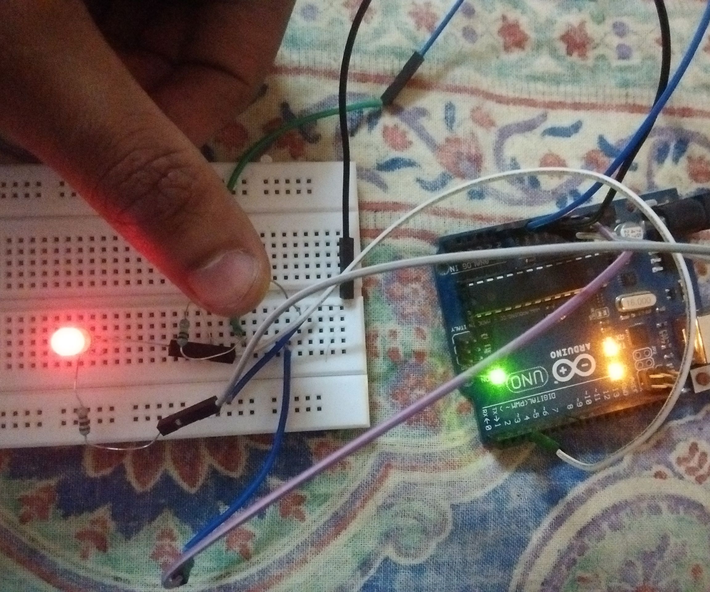

The connection is pretty simple ultrasonic sensors have 4 pins namely: trig,echo,vcc,gnd to be connected with arduino .
The echo pin is connected to the arduino digital pin 5 and the trigg pin of sensor is connected to digital pin 13 of the arduino . Vcc is connected to 5V from the arduino and gnd pin of sensor is connected to the gnd pin of the arduino.
The led is connected to pin 2 (+ of the led) while the cathode(-) of the led will be grounded via a low resistor value.

The code is pretty simple which detects the presence of object in front of the sensor (eyes side) and glows an led until the object is taken away from the sensor (here approx 50 cm) .

The object is detected in the video as depicted by the glowing of led and the distance shown at the serial monitor .
